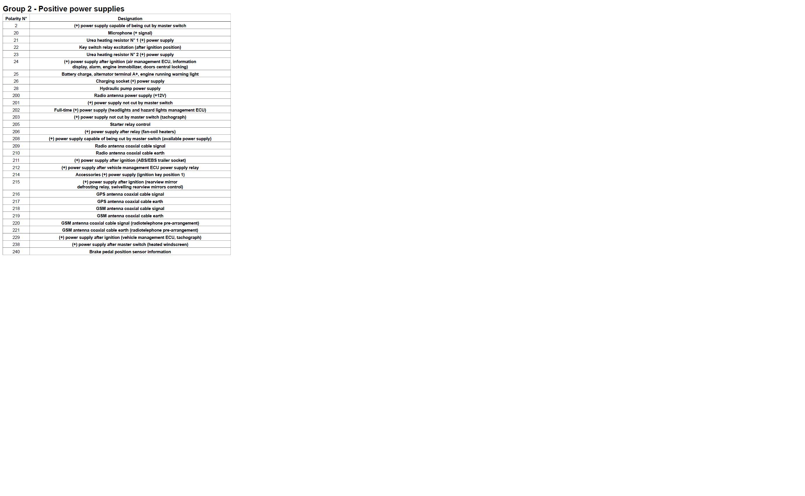

  • #6 16881445
    HADŻI
    Posts: 366
    Help: 87
    Rate: 441
    Hope these schematics help you. Good luck.
    • Renault Magnum DXI 440 Euro4: Step-by-Step Injector Harness Replacement Guide & Tips Schemat engine ecu Magnum DXI.C02.jpg (157.9 KB) You must be logged in to download this attachment.
    • Renault Magnum DXI 440 Euro4: Step-by-Step Injector Harness Replacement Guide & Tips Komponenty ecu engine Magnum DXI.C02.jpg (168.88 KB) You must be logged in to download this attachment.
    • Renault Magnum DXI 440 Euro4: Step-by-Step Injector Harness Replacement Guide & Tips Schemat engine ecu Magnum DXI.C01.jpg (195.75 KB) You must be logged in to download this attachment.
    • Renault Magnum DXI 440 Euro4: Step-by-Step Injector Harness Replacement Guide & Tips Komponenty ecu engine Magnum DXI.C01.jpg (189.46 KB) You must be logged in to download this attachment.
  • #7 16881498
    HADŻI
    Posts: 366
    Help: 87
    Rate: 441
    Here you have more cable descriptions.
    • Renault Magnum DXI 440 Euro4: Step-by-Step Injector Harness Replacement Guide & Tips 1c.jpg (189.36 KB) You must be logged in to download this attachment.
    • Renault Magnum DXI 440 Euro4: Step-by-Step Injector Harness Replacement Guide & Tips 1b.jpg (257.66 KB) You must be logged in to download this attachment.
    • Renault Magnum DXI 440 Euro4: Step-by-Step Injector Harness Replacement Guide & Tips 1a.jpg (248.14 KB) You must be logged in to download this attachment.
    • Renault Magnum DXI 440 Euro4: Step-by-Step Injector Harness Replacement Guide & Tips 1.jpg (226.19 KB) You must be logged in to download this attachment.

  • #9 16882387
    edmundsosnowski
    Posts: 14
    Rate: 7
    I do not have how to scan this description, but the connector is given, the cable number of the new harness and the position in the controller connector.
    Connector "B" Pin "B30" Cable number 2484
    "A" "A12" 0013
    "A" "A16" 0031
    "A" "A20" 0011
    "A" "A24" 0047
    "A" "A28" 0021
    "A" "A32" 0039
    "A" "A36" 0001
    "A" "A40" 0034
    "A" "A44" 0068
    "A" "A48" 0037
    "A" "A52" 0064
    "A" "A56" 0072
    "A" "A59" 0063
    "A" "A60" 0005
    "A" "A61" 0043
    "A" "A62" 0029
    I hope that you will read the numbering from these new wires because in fact, after touching them a few times, they become illegible. I did it, but before cutting it off, I checked where it was. It's a tedious job because there are only bare wires left there, but you can do it one at a time. Good luck, I hope I helped.
