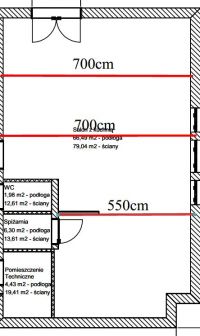

    I need help choosing an I-beam.
    Due to the fact that the ceiling of the building will be weighted (about 10 tons). It plans to strengthen it by making a note of one or more I-sections. (space in the suspended ceiling is quite limited, therefore it would be possible to use 2-3 I-sections with a better solution). The I-beam will be mounted on bearing walls.
    I-beam Selection for 10-ton Weighted Ceiling in Single-Family House: Optimal Support & Design
    best regards

    Thank you for your comments, but assuming the thread I was counting on more specific information.
    Of course, I am aware of the designer's stamp is important, but I also carry out design work in a different area and I know what it looks like in practice, a person who has the rights, and often does not familiarize well with the design prepared by engineers. I still hope that someone who makes calculations instead of patting the stamps will speak.

    Try to count the beams yourself.
    You will read and it is not so difficult: http://belki.y0.pl/
    Approximately: for my house I used I-sections, height 160, width 74. Distance between supports 5. However, this is a normal, large house.
    These I-beams are spaced every 3 m.
    I hope this helps you.

    The solution seems simple but it is not, just inserting beams requires knowledge and experience.
    We have many unknowns here, including:
    - thickness and reinforcement of the existing reinforced concrete slab
    - 2T support places on load-bearing walls with windows.
    These are the things that matter most.
    The entire existing structure is subject to calculations, not just the beams themselves.
    In addition to the fact that, for example, the existing floor alone may be adequate for half of the expected load, the places of supporting the beams may be too weak to support the remaining half of the load, and the beams themselves have their weight, and too heavy they add a load in themselves.
    Such, for example, brick posts between windows, they may be too weak and then you need not only to rebuild them from appropriate engineering brick, but also to check their foundation-foundation, and often even make a new one.
    The chain is as strong as its weakest link.
    Every building maintains itself by gravity, but the same gravity can destroy it if it is bypassed.
    The building is a whole, not just individual elements, and each conversion requires a recalculation of its elements in a new arrangement of forces.
    Having an original construction documentation not only facilitates calculations, but also allows you to quickly find the weak points for rework, because the designed and made strengths of individual elements are known.
    Any savings and deviations from the plans may be the cause of unforeseen problems during operation or modification.
