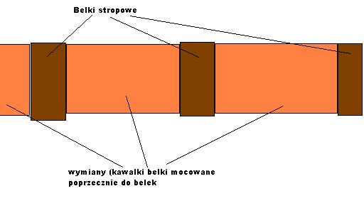

    Such stiffening of the ceiling is done differently.
    I don't know why everyone is blindly following the direction of the floor beams.
    If you add an additional beam (steel or wood), the beams will work independently anyway, which is what causes the tiles to crack.
    The floor beams you have there are sure to give you sufficient strength and you should rely on them, and stiffening the floor (s) is another matter.

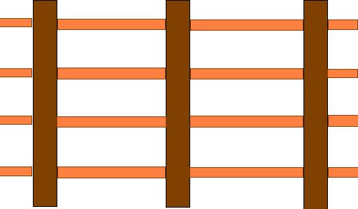

    For the tiles, you need to create a uniform and rigid board based on the beams that are already there.
    It needs to be strengthened (stiffen with beams in pieces. :-) Oh yes, beams in pieces. :-)
    Such pieces when used properly give the same as an entire extra beam. :-)
    I will try to make a drawing of a cross-section of such a stiffener.
    At construction sites, something like this is practically done on a daily basis to stiffen the ceiling.
    In the case of new ceilings, only 2-3 rows of replacements are made, which are made of waste pieces of beams.

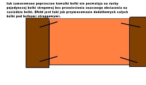

    The following method, in addition to stiffening the ceiling, provides additional support points for panel joints.
    These exchanges do not have to be as thick as the ceiling joists, 4-5 cm is enough, but the height should be min. 2/3 of the height of the ceiling joists.
    Fasten preferably with screws, but nails hammered in alternately in different (opposite) directions (angles) give similar results. see figure 4.
    The replacements should be cut at an angle of 90 degrees, but you know, the old ceiling is slightly sagging and the beams are slightly twisted, so you mainly need to make sure that the ends of the replacements adhere to the ceiling joists at the top and bottom, without gaps.

    A quicker and rather moderately good way is to use a flexible transition between the plate and the tiles (eastern glue), point gluing, and tiles of small dimensions, as well as givelarger than typical widths of the joints, which will reduce (spread) most of the stresses, but will not eliminate them completely.
    The support of the disc must be one way or another, only these replacements did not have to be that high.
    It is your decision, there is always something for something. The lower the quality of the stiffening, the greater the risk of damaging the tiles.
    You will make the stiffening solid, the plate will have good support and the plates will not crack.

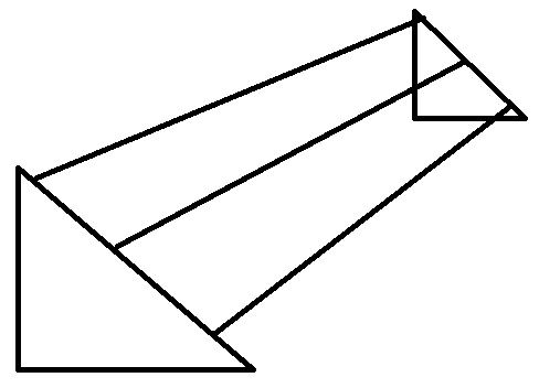

    What profile should I use so that the 6 m long hollow sections do not bend? I wanted to hang 3 photovoltaic panels on this, i.e. a weight of about 80 kg. Does this make any sense at all?
    Should I use 2 beams or 3?
    Schematic drawing of a triangular frame made of closed profiles, forming a mounting rack for photovoltaic panels. .
    >>21543826 .
    Check where the support-mounting points are according to the panel assembly instructions, as this will determine how many beams you will need.
    And for a 6m span I'd advise giving the same triangular support to the beams in the middle as at the ends. 6m is quite a lot, too much distance for the structure to be stable.
