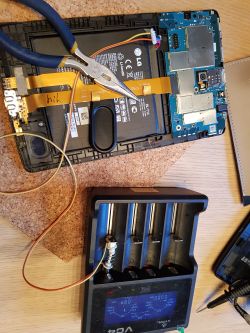

    After six months of use, the tablet has stopped charging. After connecting the charger the screen light up slightly and presents alternately the two icons that I insert (manual work, the second battery icon presents a kind of rotating progress bar that stands still :) )
    LG G Pad 8.0 Tablet Won't Start, Battery 0%: Charging Issues, Screen Icons & Potential Solutions
    Every now and then, the tablet seems to be trying to start, some sounds are heard and the desktop appears for a second, then goes out and the story comes to life. I thought maybe something with a charger or cable, but I do not have much accessories right now to check it out. In addition, after connecting the charging the tablet reacts as if recognizes that it is connected.
    Is this the end of the battery? What to do? Tablet for warranty, but maybe something can be done on its own?

    It looks like a dead battery. do not hesitate just use the guarantee.

    I would like to try it under the PC, maybe it will move and if not, advertise the warranty as above. For the future, you do not leave equipment with a discharged battery for a long time because later there are problems of this type.

    Deeply discharged battery may need external voltage boost

    The battery is not fully functional because it has a low voltage and therefore the charging system does not want to charge for safety reasons. As for the warranty, it is interesting whether or not you will be deleted for the replacement because the battery is a shorter warranty. In most such cases, to save the battery you just need to raise the voltage with external power, of course, if the battery is interchangeable without interfering with the device here, however, I advise you to take advantage of the warranty maybe you will get a new battery for free so you can use it.

    Rather, the backs are on the snaps, unless you disassemble during disassembly, therefore I recommend dismantling using a cut plastic punishment or guitar puzzle.
    Backup with a discharged battery rather falls out.

    Hello, I was met by the same problem, I managed to disassemble LG with a guitar dice. The latches are quite solid but can be opened. I had the battery discharged up to 2.5V and connected to an external power source and at the battery voltage of 4.05V the tablet started charging. LG G Pad 8.0 Tablet Won't Start, Battery 0%: Charging Issues, Screen Icons & Potential Solutions

    I also got my equipment. I left him for over a month watching. I managed the dice to install Brodit system phone handles.
    I connected to the charger :)
    and loads :)

    It works. It turned out that the voltage dropped below the minimum and the pad would not move. He works, recharges after resuscitation. After a full night of 100%, he was 98% in the vigil. And I already wanted to order a new aku.
