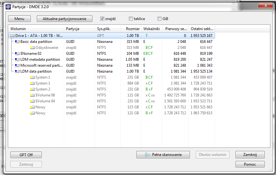

    I know that there are a few posts on this topic (similar), but there is no information on how to easily copy data from an undamaged Dynamic GPT partition.
    To the point :
    I have a 120gb SSD and I have the W7 Ultimate 64 bit system on it, and a 1T system on which I had data and two "once" systems.
    After starting the SSD, I made cleanup on the 1T disk and the partition called "DANE" (500gb occupied 320gb), on which I transferred all the data similarly :) , (Sysyemy has been "removed").
    The disk ran for a while, until I put the system back on the SSD, from then on it does not see my disk (probably).
    Now my question: how to copy data from this partition. (the disk is not damaged)
    Adds a snapshot of the current disk state from Mini TP.
    Thank you in advance and I count on your understanding.

    Show the DMDE screen from the Partitions window view after selecting a disk from physical devices.

  • #9 16501252
    mati211p
    Posts: 16923
    Help: 2585
    Rate: 1133
    You put it right, only DMDE has some problems with correctly displaying partitioning in GPT (not the first and not the last time from what I remember). The partition will be, and not be displayed like here. Often the indicator E and the partition type are displayed, and the rest is missing. In addition, the situation in the case of a dynamic disk is also often incorrectly shown. In this case, you can try to perform a full scan in DMDE, save the results to a file, then go to the partitions window and show the same window without switching off the program. You can, of course, from the live system, for example, using GParted to copy data to another disk temporarily, after ripping the data, reformat and re-upload the data (because I do not know with what effect the attempt to import a foreign disk will end - although you do not even have such an option).

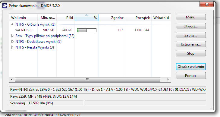

    I chose these options and started the scan (now waiting for the results).
    And is it possible, for example, to install a system on, for example, a ssd or pendrive, which would allow you to open these data and copy (because, for example, the "MiniTool Partition" program allows me to preview files but I cannot open or copy them)?
    I have one more question: do I have to have a 1T disk and a minimum of 500GB empty for copying or a 500GB disk with 340GB free as much as I have data on this disk (on this partition)?

    I also wrote about it, e.g. GParted / Parted Magic on a USB flash drive / CD and you can copy, 340GB of free space is enough (i.e. as much free as is occupied on this partition). Once DMDE finds it, it will go without copying.

    I am currently at this point in scanning.
    Added after 3 [hours] 31 [minutes]:
    Copying Data from Undamaged Dynamic GPT Partition on 1TB HDD with 120GB SSD & W7 Ultimate 64-bit
    The process finished and I got the log which I attach in winrar and partition screen without exiting the program.
    The program is on all the time in order to send any screenshots or files.
