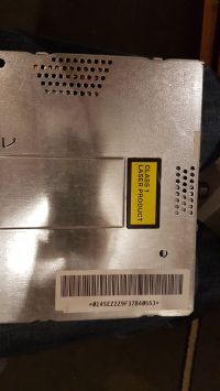

    Hello, as in the subject, I am looking for a way to attach an aux cable to the above radio, some schematic or guide where you can attach. I will be very grateful for your answer :)
    Greetings.
    @Edit: I attach photos.

    You must read the contents of the memory to generate the code.
    What code ?
    The questioner wants AUX.
    Added after 48 [seconds]:
    AUX changer emulator.

    Only the changer emulator comes into play? There is no other way? Is there a scheme for my own performance?

    SZYMON BYDGOSZCZ is right.
    A simple to perform and tested emulator in the attachment.

    Have you ever thought that to use a jack jack made in this way, you will have to work a CD player all the time?
    As for the 24c16 reading itself, using arduino, this should not be a problem. Everything is lined up like a tray. Read it, put the file here, then someone will help you calculate the code.

    Unfortunately, the program with me is the same 0, what to do with it?
    Seat Ibiza 3 FL Alana MP3 Radio: How to Attach AUX Cable, Wiring Schematics, & KOD Guide Seat Ibiza 3 FL Alana MP3 Radio: How to Attach AUX Cable, Wiring Schematics, & KOD Guide
    How to check if according to 24L16 responds>
    @Edit: did I accidentally overwrite this bone using 1 program? :D ?
    I still have an atmel usb version 2.0 programmer if it changes something
    @ Edit2: On the basis of my home-made research, I am able to say that my 24L16 corresponds to a rally is not so bad :D (I pulled out the port SDA, from the controller, mass ect and came to such a conclusion.) I am dark with such programming, I will be grateful for any help, any helpful comment after success, of course, I will reward :)
    @ Edit3: If I broke down and overwritten the memory by 0 (which I have the impression I did ...) then I found the batch but apparently it is broken someone will confirm?
