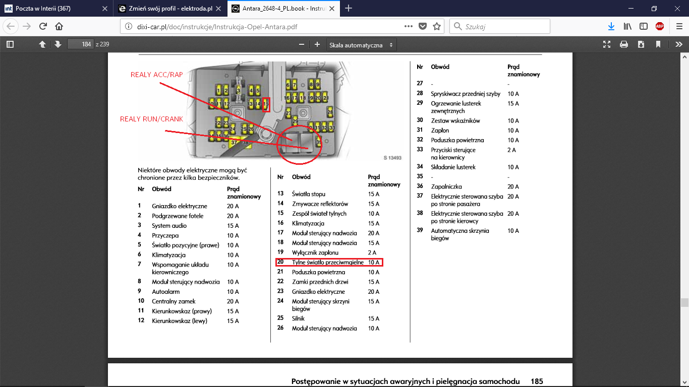

    slawomirczajka
    Please look at the pictures.
    It looks like there is no rear fog light relay in the fuse box in the cab under the hood.
    From the front fog there is a relay in the box under the hood described as FRONT FOG.
    If there were a rear fog lamp relay, it would be alogically described as REAR FOG as a fuse.
    The front halogen ones are on the relay because of the current they consume. And the rear is only 2x21W so Opel may not have used a relay.
    Where else to look here?
    Best wishes.

    #6 16865064
  • #7 16865249
    slawomirczajka
    Thank you very much.
    Look, maybe something will be explained.
    Added after 1 [hours] 15 [minutes]:
    Chicken. It's like you write.
    Only where to look for this relay K 58 ???
    XBCM - Body control unit, additional I don't know what it is.
    The designations of fuses F18 and F 19 in the diagram do not match those in the fuse box.
    Maybe in this model that I have there have been some changes in the installation.
    Nothing.
    Thanks again for taking the time.
    It's still a long way to go :) , maybe by then something will be clarified, and if not, the Opel service will probably remain
    Regards
    Slawek

    slawomirczajka
    Thanks.
    I will definitely make pics.
    Regards
    Added after 44 [minutes]:
    I wonder where to look for it, the location doesn't show up in this drawing, or I can't interpret it :)
    You do not need to disassemble the entire desktop ...?
