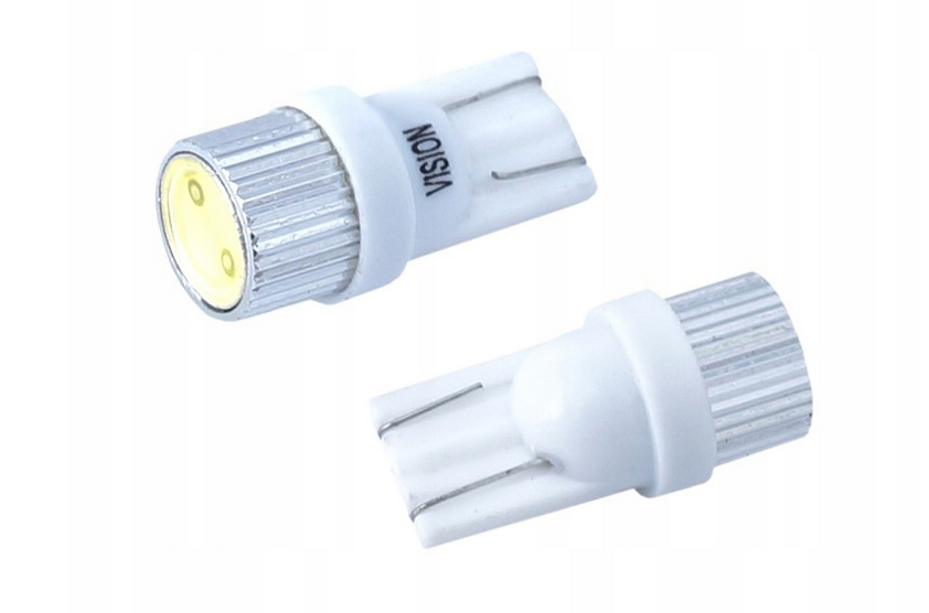

    Hello. I have such a problem, the point is that I replaced the parking bulbs in the car and from the registration backlight to Ledy. Everything is OK . I also decided to replace it in the interior lighting, i.e. in the headliner. Here is the problem, so I replaced the bulbs with LEDs in the backlight at the front and everything is fine. Everything works, but when I replace it in the headliner at the back, there is a problem :( the fuse burns and when you insert a larger one it burns that Leda. What to do ? There is also LED in the glove box and the boot and it's okay. I even did so that I took out all the LEDs from the lighting and put only these two LEDs on the back and also the fuse was burning. What is a cause of it ?

    Turn to the opposite side or cover one of the LED wires, times 2. See how the wires are arranged in the bulbs and how in the led in your photo.
    On one side you have two wires, and look at the holder that contacts these two wires at once, + and -.
    These leds have contact wires on both sides? Total 4 contact points? You make a short circuit with this led. The bulbs have only two points, and it seems to be on opposite sides, and this holder is a bit strange, certainly not for these leds.

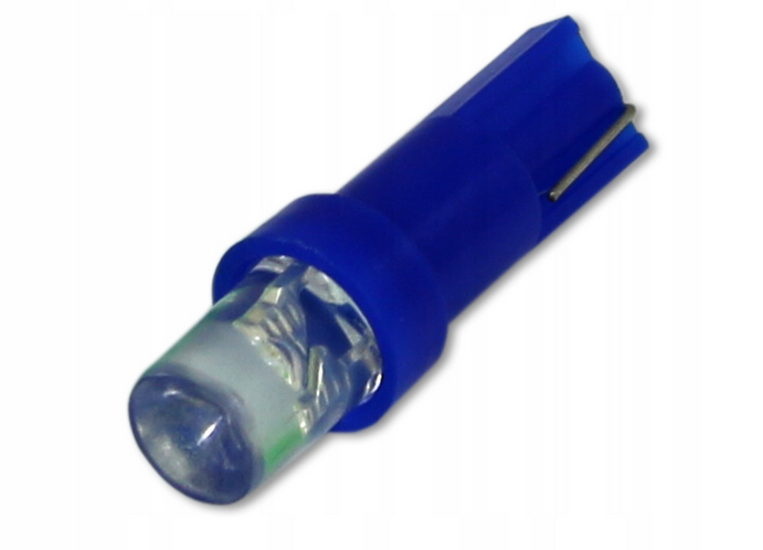

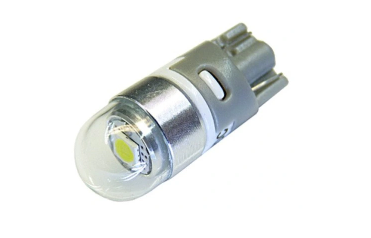

    Opel Astra H GTC Interior Lighting: Replacing Parking Bulbs, Astra H 1.4 LED Issues & Solutions Opel Astra H GTC Interior Lighting: Replacing Parking Bulbs, Astra H 1.4 LED Issues & Solutions Opel Astra H GTC Interior Lighting: Replacing Parking Bulbs, Astra H 1.4 LED Issues & Solutions
    Do you see the difference? Because only two LEDs from "my" photos will work with this lamp, due to its construction.
