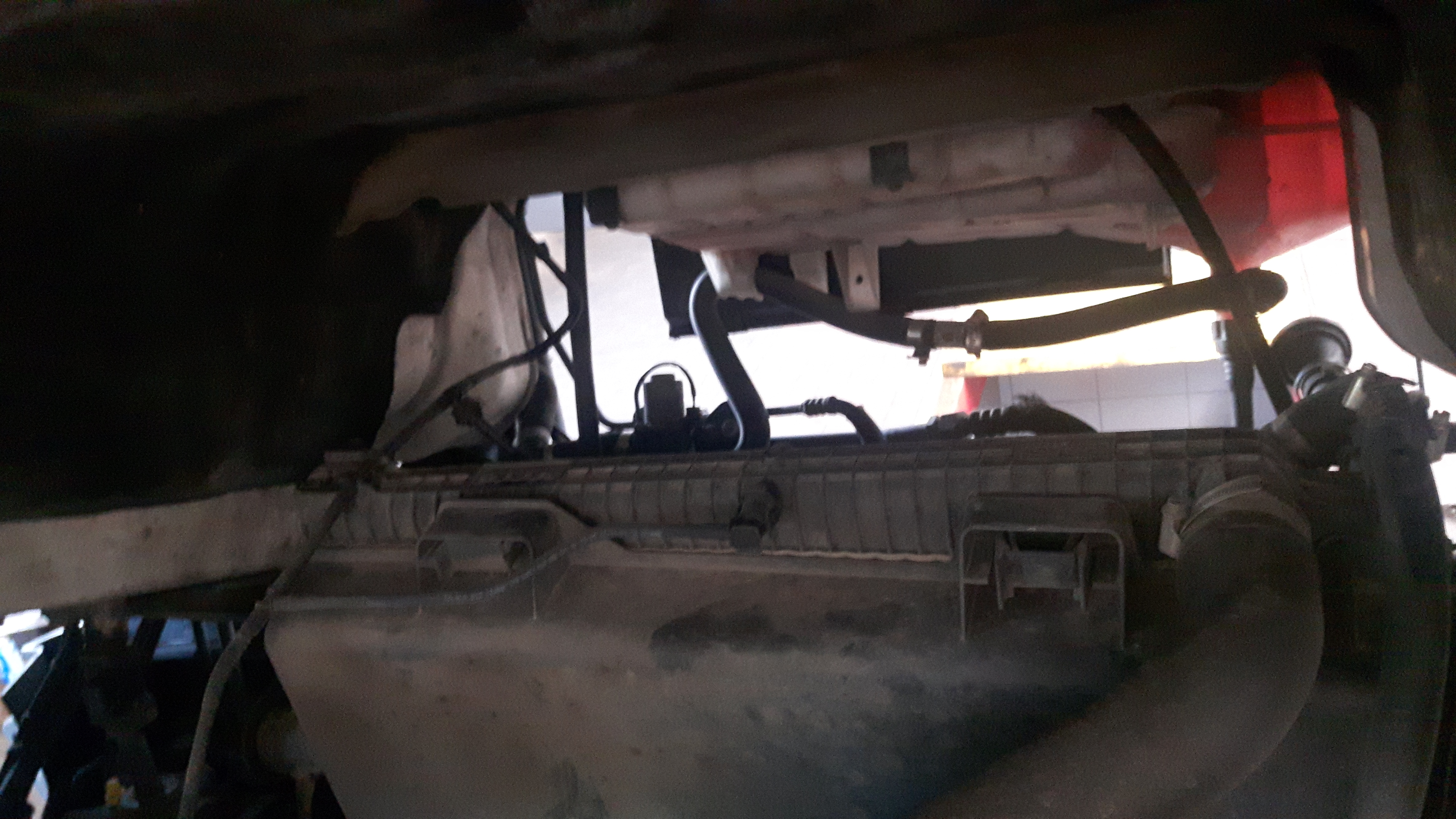

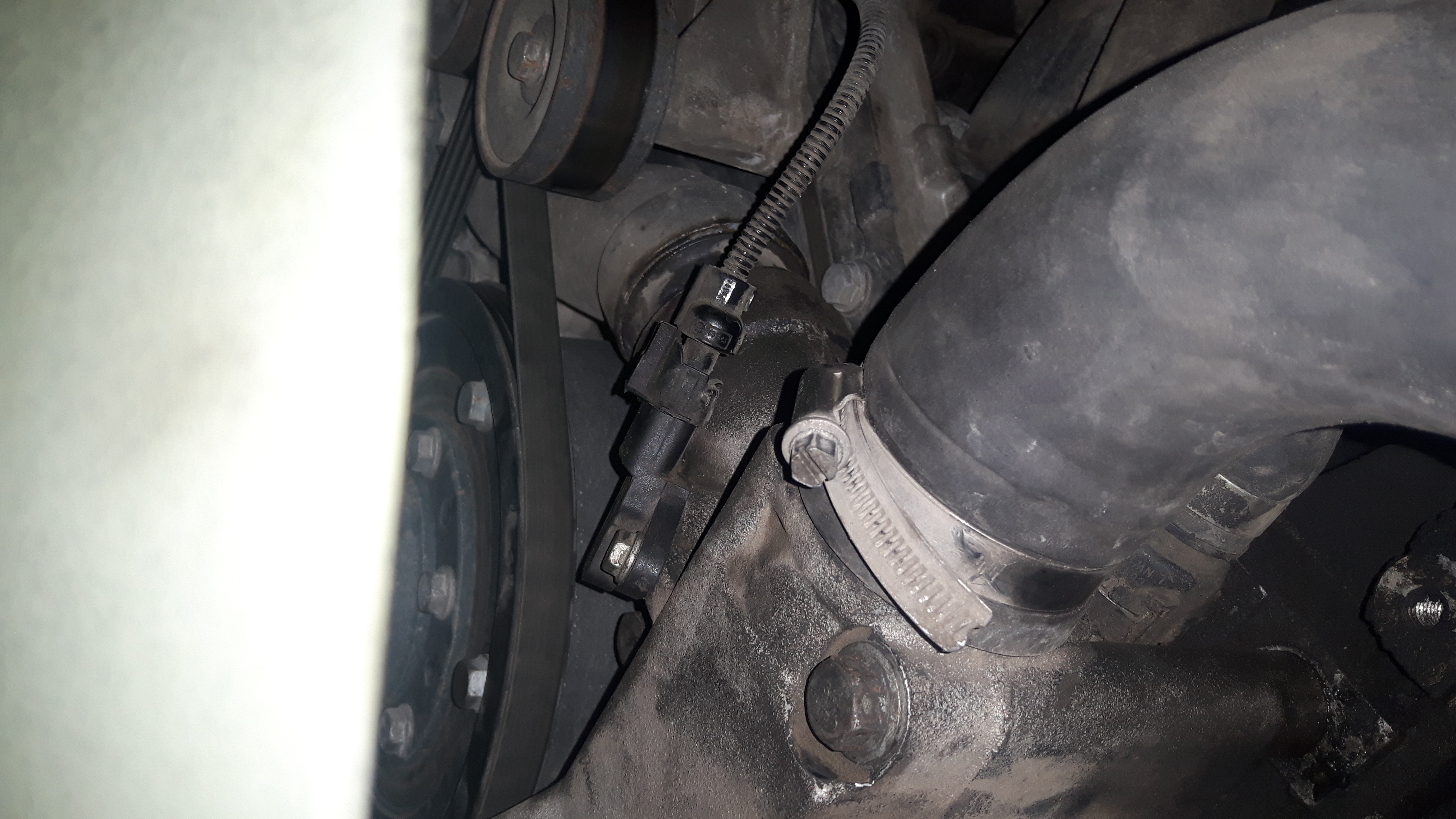

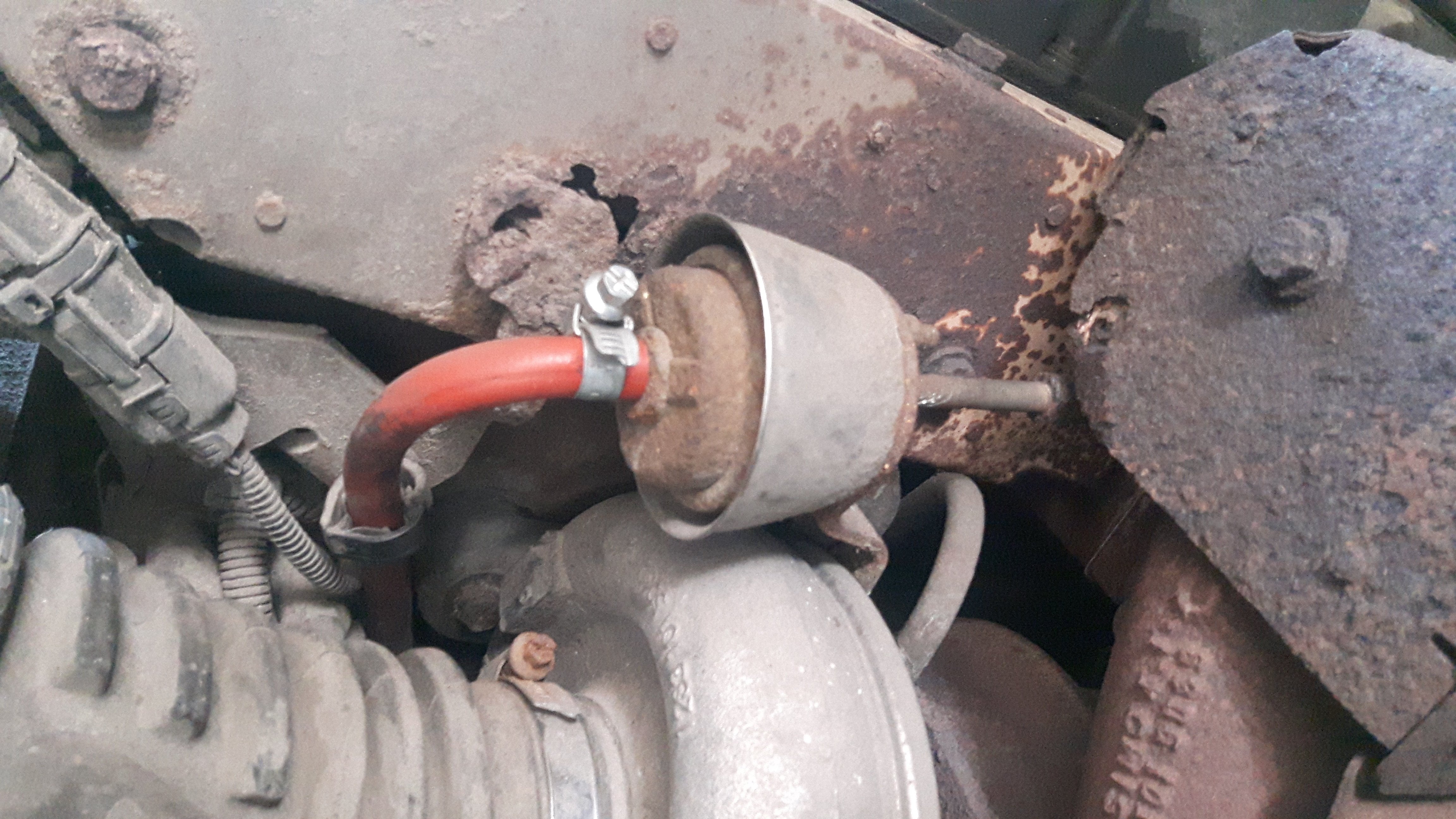

    Hello, after a long break. Unfortunately, the problem could not be solved. In the meantime, the car began to eject the liquid and the charge air cooler (intake) with thermostats was replaced with it. New original parts. It stops throwing out the liquid but the power is limiting. The turbine control valve has been replaced. The currents reach the valve, the air pressure too, the bar on the turbo works smoothly. We noticed that the error and power cut occurs at the intake air temperature of 81 degrees, sensor replacement and the same situation but at 83 degrees. It always cuts off the power at this extreme temperature. After it cools down, it is ok until it is reached. The service checked the site and claims that it is ok. Please help, because they are all over it. Best regards.

    You have 2 boost valves in your engine, when replacing the boost cooler they put a special valve (you will see it on the second cooler at the top) and hoses to protect the boost cooler?
    Dismantle the agr flap cylinder only and take a ride if nothing changes after replacing the second sensor.

    There are two sensors (each of them measures the pressure and temperature in a given place, one of them is behind the turbine and the other is on the top-up cooler), but there is one valve limiting the turbine boost pressure. I changed the sensors but the indications did not change. There is another temperature sensor on the collector acting on the resistance. I put a resistor to show 70 degrees all the time but cut off the power based on the values of those sensors. I detached the agr cylinder and tied the flap in the closed position, but no changes. In general, the car heats up very quickly to operating temperature, even without a thermostat. Is a possible dirty radiator wreaking such havoc? There are two coolers, but connected with each other by thin wires, but it is possible that one of them is from the engine and the other from the top-up? Man TGM 18.290 Euro5 Engine D0836LFL64 - Error EDC 2 03946-03 Charge Air Cooler Issue Man TGM 18.290 Euro5 Engine D0836LFL64 - Error EDC 2 03946-03 Charge Air Cooler Issue Man TGM 18.290 Euro5 Engine D0836LFL64 - Error EDC 2 03946-03 Charge Air Cooler Issue

    They are linked so it is possible that there are quite a few leaves between them.
    More I will not ask about the protection of the coolers - it is in your interest if you have installed a valve on the pipes because if the situation repeats you have air coolers to replace
