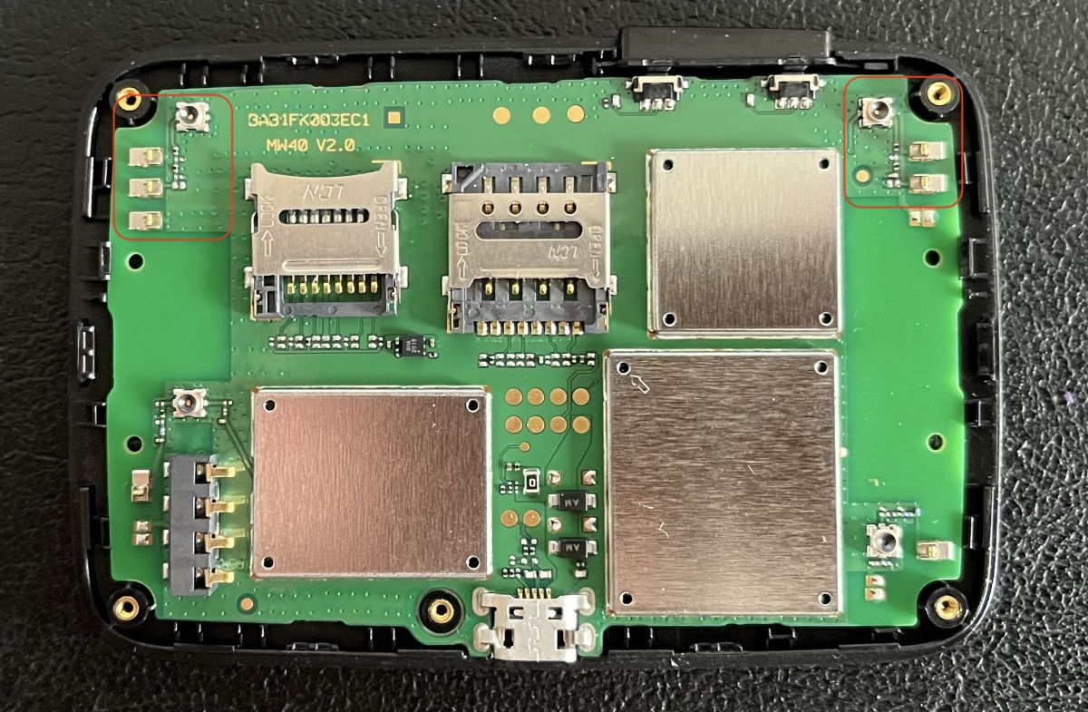

    I would like to ask you, is it possible to increase the range in the Airbox LTE MW40V router? The router I can see that it has a socket, but nowhere I can find information whether it is an antenna socket or not. I mean exactly this place:
    Airbox LTE MW40V Router: Increasing Range, Antenna Socket Compatibility & Poor LTE Coverage Issue
    In general, I have about 3 km in a straight line to the mast. The router is right next to the window from which I can see without any obstacles. There are no trees, no chimneys, nothing. Phones that are not next to the window have LTE full coverage. The router has a max of 1 bar and this is a miracle as it is because it usually receives LTE but the range is 0 bars. It often jumps to 3G. Before I buy a new router, I thought that maybe an antenna could be connected to this socket. It just so happens that I am playing with Arduino a bit and I have a few such entenki exactly with this input, but I don't know if this socket is for this purpose.
  • #3 21124602
    michaelcyroll
    Never ever in this world there are service Connector. The connectors are directly placed at the native pins for the wifi and lte antenna on each side. So when you have an external Antenna. Maybe like this https://www.ebay.de/itm/283109098488 you can test it.
