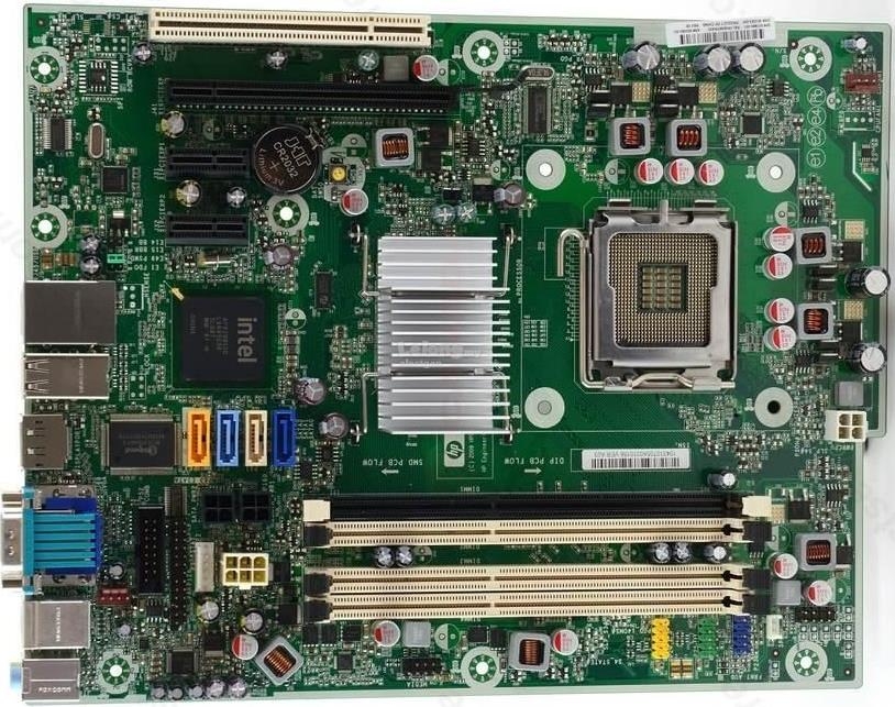

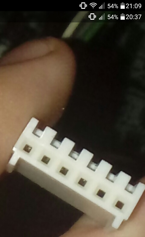

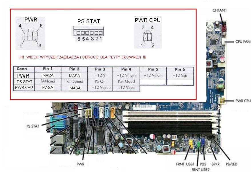

  • #8 16871754
    Alicja249
    Posts: 9
    What is the name of this connector? It is stamped into such needles on the motherboard
    • Choosing an Appropriate Power Supply for Gaming PC with Intel i5 2400, GTX 1050TI, 8GB RAM Capture _2017-12-05-21-09-26.png (313.44 KB) You must be logged in to download this attachment.
  • #9 16871770
    Kasek21
    Posts: 45660
    Help: 4981
    Rate: 3547
    AUX or APC (Auxiliary Power Connector) - you will not need it; unless you are playing with older equipment (eg P4).

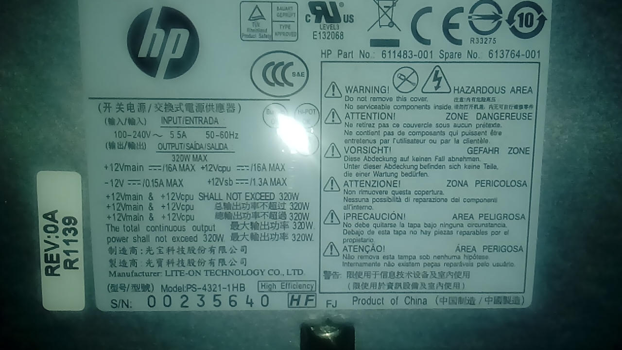

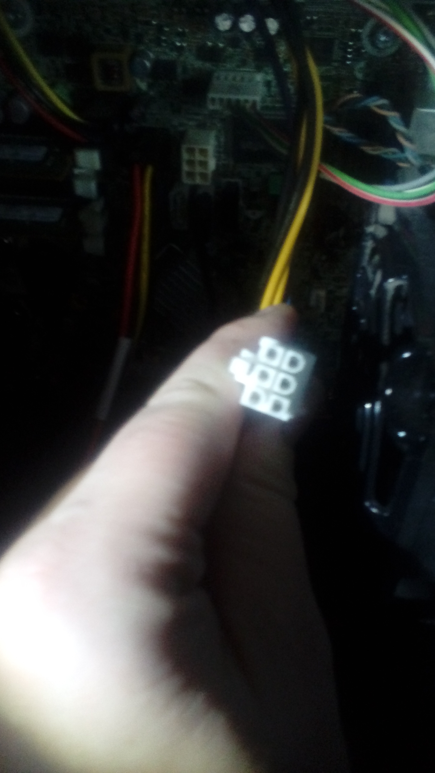

    It does not look like an old AUX plug to me. Firstly, too small, secondly, no one used it in power supplies for Core II gen. However, it seems that my friend has an HP computer, which is very likely to have a non-standard power supply.
    An example power supply from such an HP may look like this:
    If such a power supply is included in this computer, then most of the standard power adapters available at a computer store do not have a chance to work with this computer.
    On the other hand - why did everyone assume the need to replace the 320W HP power supply? If it has two lines of 18A with a total limit of 320W (26A), one line of which is for the CPU (which needs 8A), then 18A remains on the other line to use for the rest of the hardware. GTX1050Ti needs 75W (rounding 6.5A), the rest of the equipment (reserve) maybe 4-5A.
    If it is functional, you can connect the GTX1050Ti to the current power supply and there should be no problems with it.

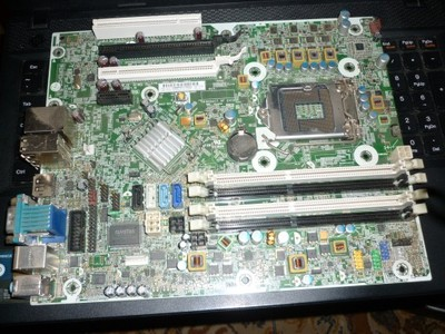

    This is probably PS STAT - a model of the board or power supply would be useful [you can also check the used pins in the connector / cable, if 4 is rather PS STAT]
    You can take a look - https://www.elektroda.pl/rtvforum/topic2621023.html

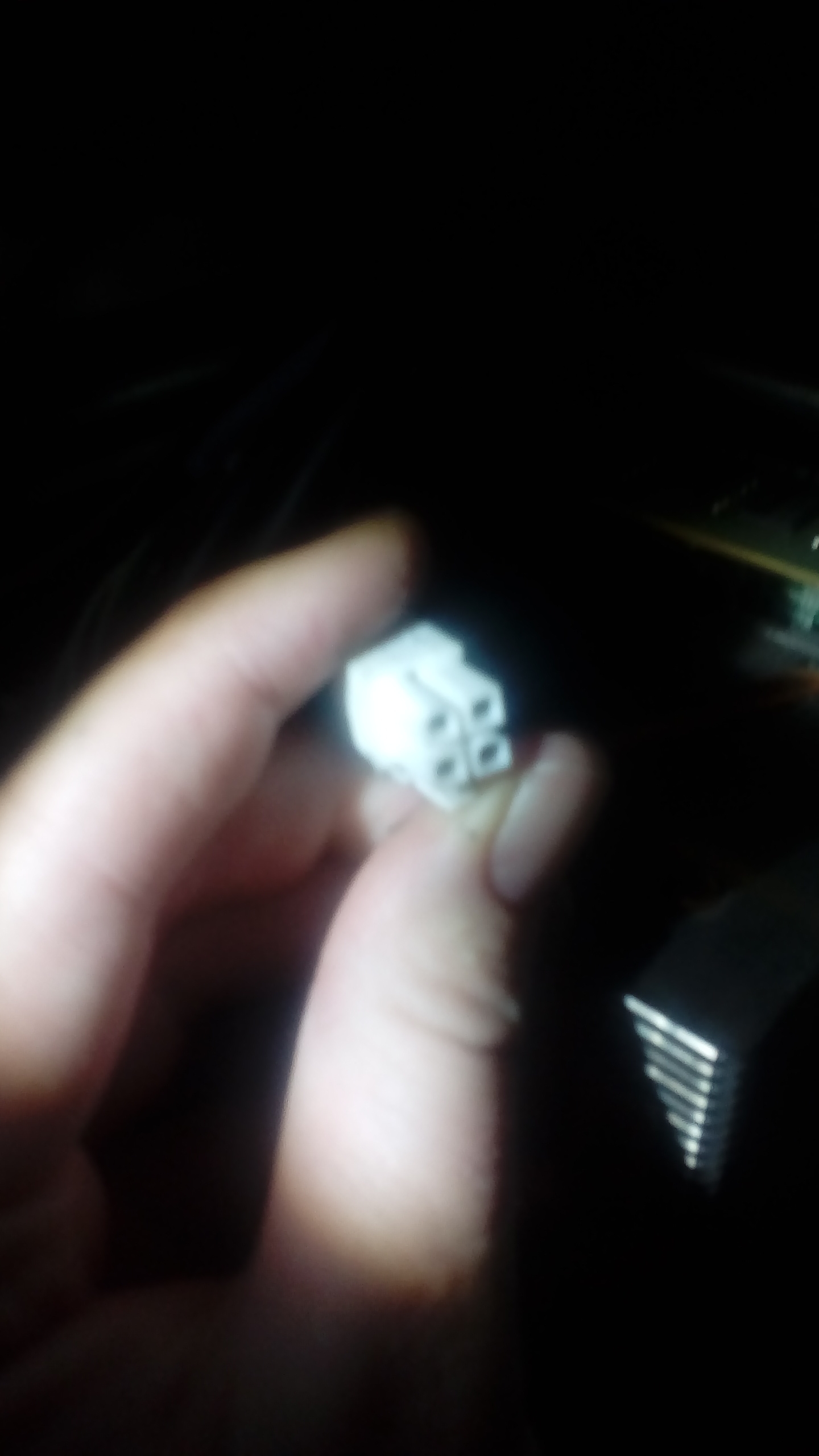

    Yes it is the HP power supply Choosing an Appropriate Power Supply for Gaming PC with Intel i5 2400, GTX 1050TI, 8GB RAM
    and I'm thinking of replacing it with a stronger one, because it's a graphics card, slinger processor , windmill fan on the back cover and games that have their own requirements - and if you sit for a few hours on one, it would be better if there was a more powerful power supply, I think?

    Alicja249 wrote:
    and I am thinking of replacing it with a stronger one, because it is the graphics card, processor, fan on the back cover and games
    I have already counted my friend's pessimistic assumptions:
    - processor: 95W
    - graphics card: 75W
    - all the rest of the stuff: 50W
    Together, this gives 220W at maximum load and quite pessimistic assumptions. The power supply has a capacity of 320W at 12V, which gives it 100W of reserve.
