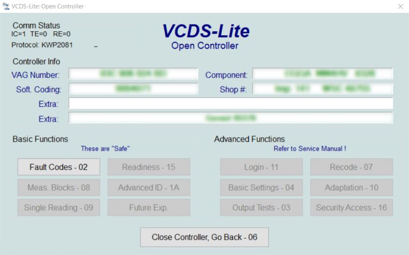

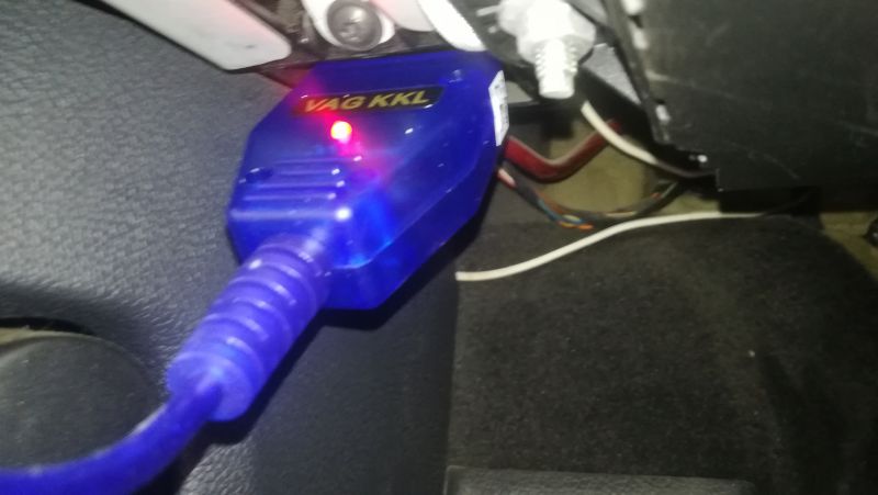

    I wanted to add cruise control to the Volkswagen Golf 6. I replaced the left stalk switch with cruise control buttons. By VCDS Lite 1.2 I wanted to activate this equipment in the engine control unit. To connect to the engine control unit, I used the VAG KKL cable, previously used in the Volkswagen Polo III 6n2:
    VW Golf VI - Activation of the cruise control in the engine control unit
    After correct initialization of the connection and switching to engine management, all buttons are inactive.

    You need a HEX-CAN interface because with K-Line you will not do anything in this model.
    Polo III and Golf VI is a technological gap ;)
