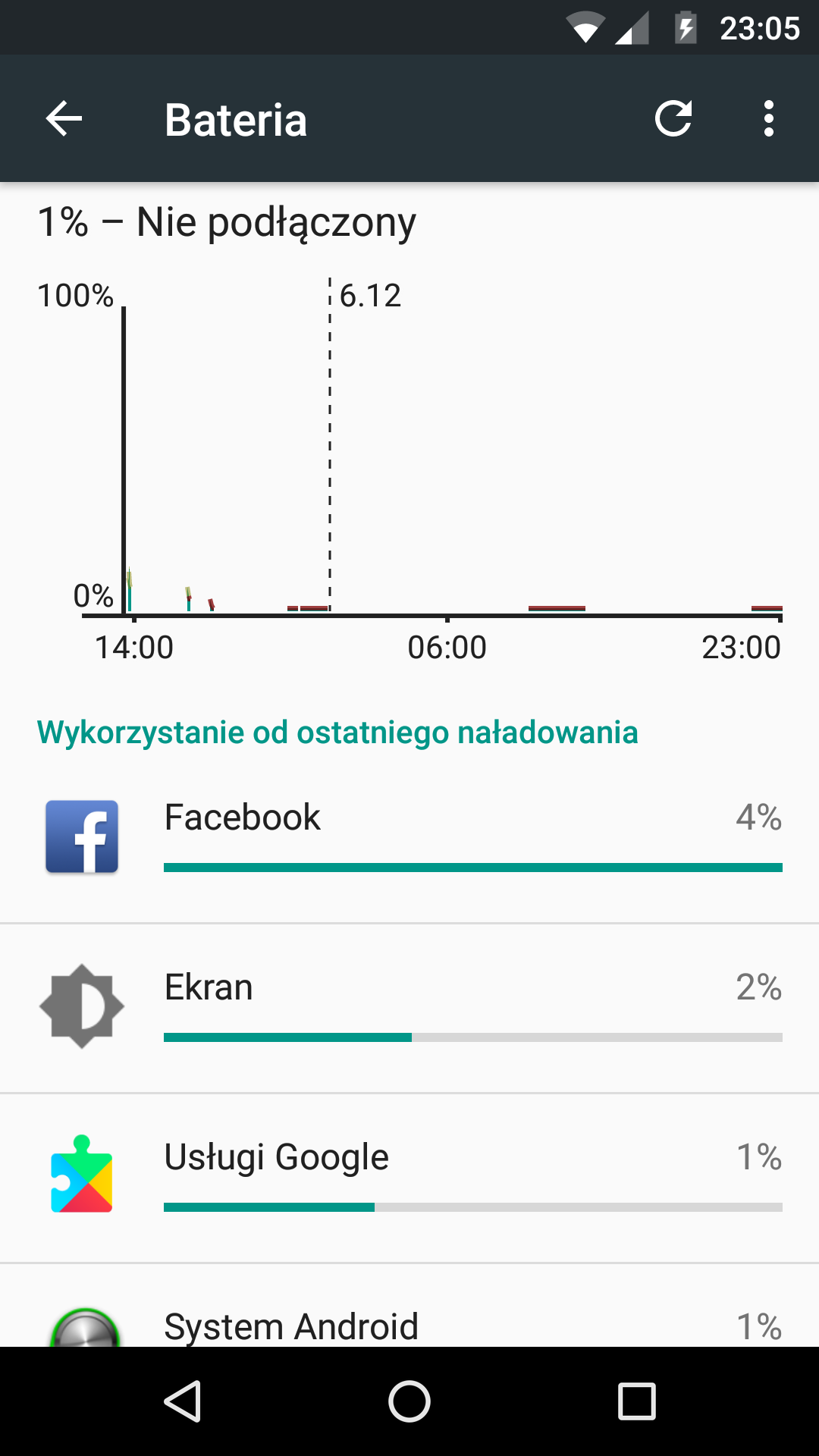

    I warmly welcome. I have a problem with my motorola after connecting to the charger only maintains the batteries at 1% shows the charging icon and the battery menu says not connected ... as in the attached photo. Please help, I tested on several chargers and various cables.

    In that case, the charging socket, battery or charging system is damaged.

    To start with, spin up the phone and see if there is any dirt, moisture around the USB port.

    Hello, I have the same thing, I was able to establish something, I will add that I am still charging on the off phone, on the turned on, it shows that it is loading but the percentage is not rising.

    It may seem strange but I did Alcatel Pop C7 today. Symptoms like yours. I demolished, cleared the nest with isopropanol, corrected February and started moving.

    I will try tomorrow but I read a little on other forums and I see that a lot of people in this model had such a problem. I also think it could be a battery connector. I will keep you updated on progress, but if something comes to your mind, please write.

    So yes, the socket is replaced, the plate cleaned with ultrasound, it is still the same, I changed the soft, I did a hard reset and nothing, ideas, maybe someone has a loading system diagram ...
