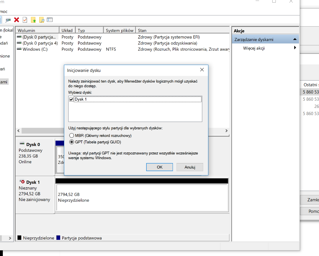

    Hello. I have a problem.
    Yesterday while copying data between disks using docking station, suddenly the disk stopped showing up in My Computer. It is a disk mounted in the docking station.
    In the disk management tab, the disk is visible, but the system prompts you to initialize it. Disk memory was 80% full. There is no formatting involved, I want to keep this data. Nowhere could I find a precise hint on the forums what to do with it.

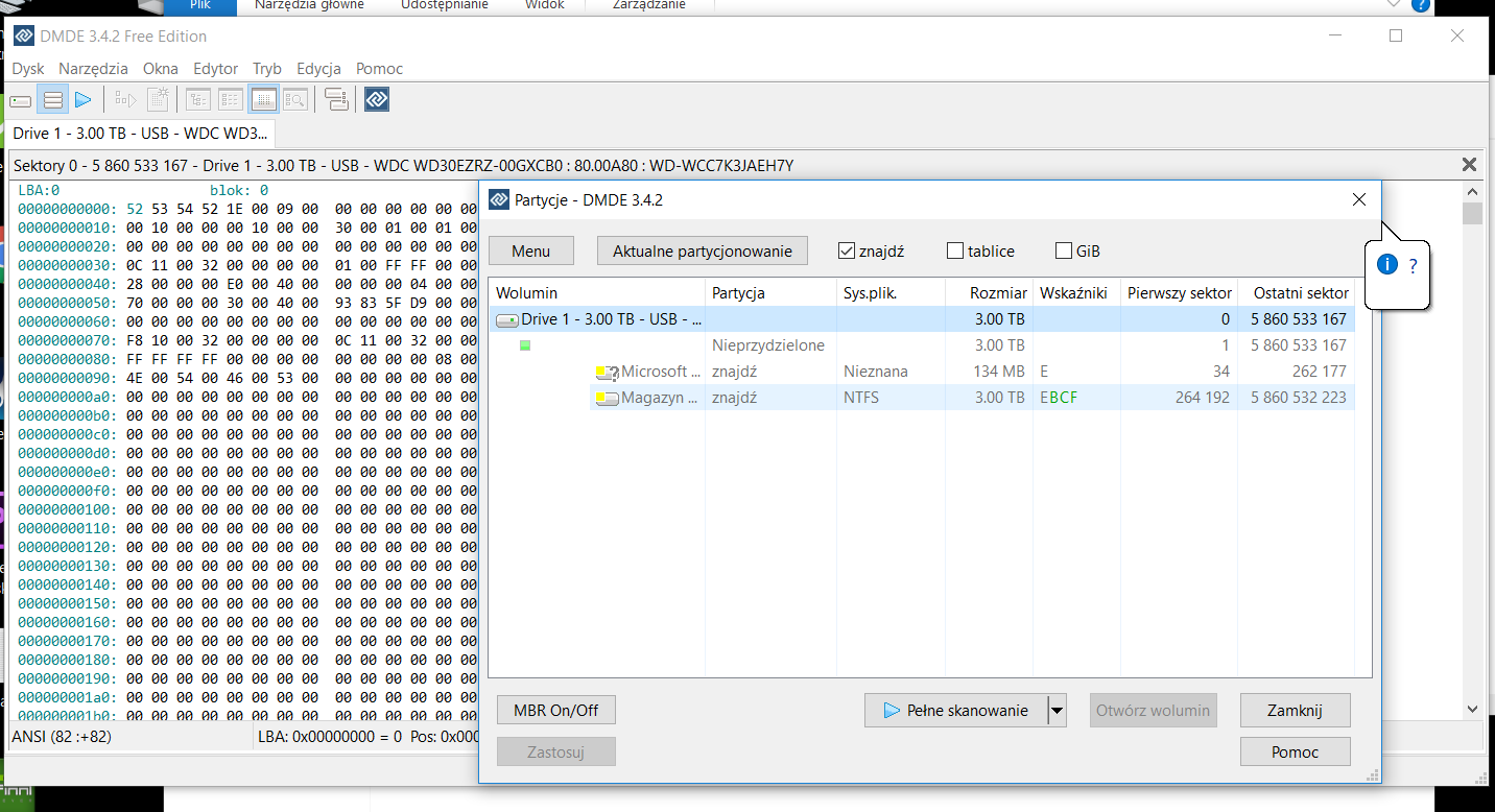

    I ran a full disk scan with dmde-3.4.2.722. During the scan, you could see in the preview that it finds files from the disk. What to do? Below are some prtsc. The disk does not make any suspicious sounds, when connected, you can hear the disk booting, no clicks, grinding etc. The docking station is functional, it can easily see other disks.
    Docking station: Unitek y-3025
    Disk: WD30EZRZ 3TB
    Windows: Windows 10 Home, version: 1703
    WD3tb drive full / Docking station - windows prompts to initialize.

    First of all, connect it to a SATA port without USB and show SMART.

    $ LogFile in sector 0? How did it happen? If SMART is ok then insert the Storage partition in GPT and save the changes. Then disconnect the USB drive by safely removing it and reconnect.
