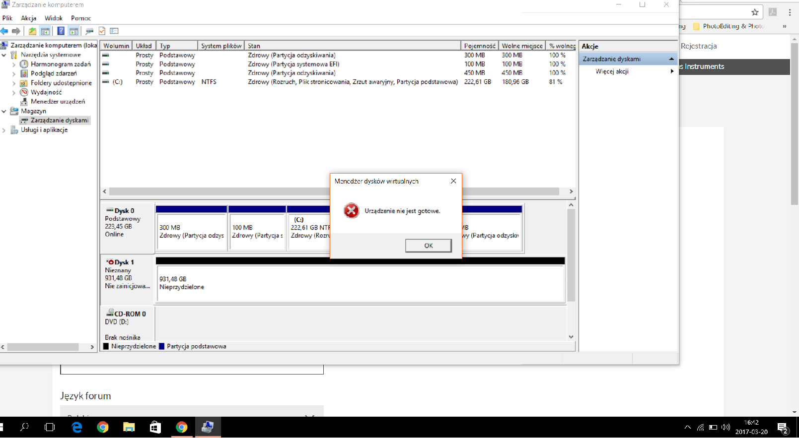

    Hello. Today something happened to my WD My Passport Ultra 1TB WDBZFP0010BBK portable disk.
    Namely, when I was doing a data transfer, the disk crashed, showing that the device is not ready.
    I tested it on windows 7, and on another computer with windows 10 and the same.
    Earlier, a few months ago, the system stopped seeing it as a plug-in under USB 3.0, but under USB 2.0 it flashed normally.
    After several times rebooting the system, sometimes the disk caught, however, some of the folders he read, and as in others I wanted to enter it again showed the message that "the device is not ready."
    After a few attempts, he does not even see him in "My Computer" anymore.
    However, in "Disk Management" one can see it once and once it does not.
    For example, now I have such a view when I try to initialize it:
    WD My Passport Ultra 1TB WDBZFP0010BBK: System Fails to Recognize Disk During Data Transfer
    Both as I try to initiate by the MBR or GPT style shows such a message.
    Can anyone advise you? I really care about this data. How could I get them back in a sense to move to a hard disk? Is there any chance to repair this disk?

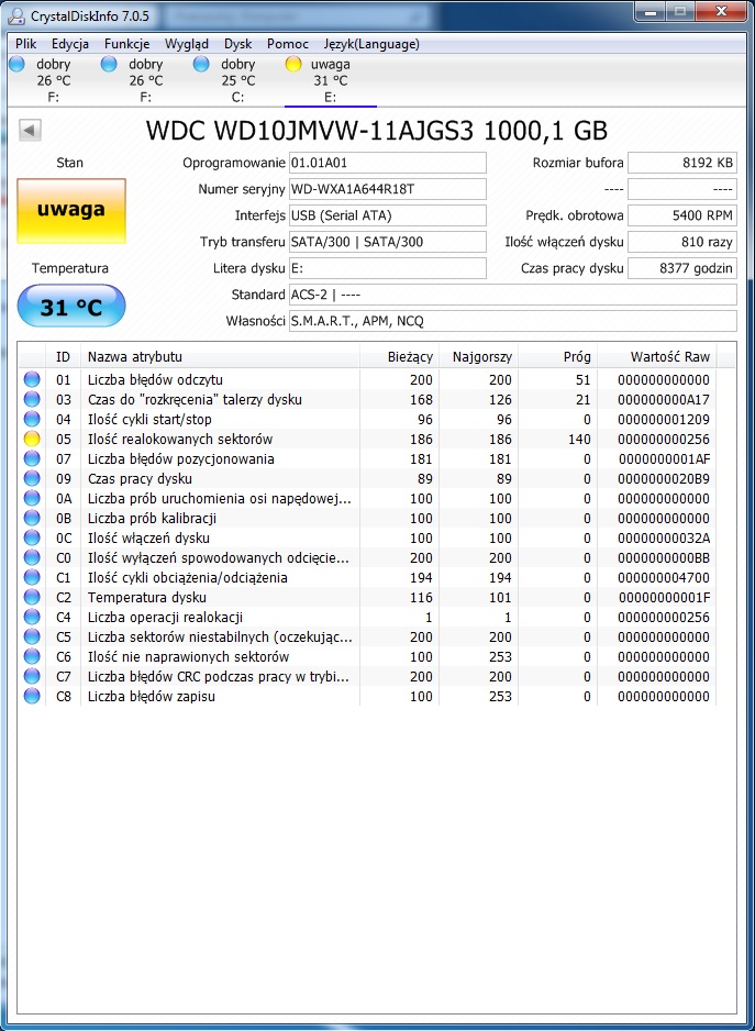

    I managed to recognize this disc in one of the computers. Here is the screen from Crystal Disk Info
    And what is the situation? There is a chance to somehow fix the disk, or at least copy the data?

    #7 16359385
    Kasek21
    Posts: 45661
    Help: 4981
    Rate: 3547
    No.
    You need to make a copy of the hub on another disk if it depends on the data.
