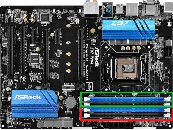

    Hello, after cleaning the computer I have a problem as in the topic. When turned on, you hear four beeps and nothing is displayed on the monitor. This only happens when I connect the RAM memory to the slots marked in red in the picture. I have four dice of 4 gb each, before cleaning there were no problems, all four slots worked properly, the memory chips are functional, because if I put the ones in the "green" field into the "red" one, it doesn't change anything, and as they are only placed in "green" slots it works, but I have 8 instead of 16gb of ram.

    First try to put 2 dice into the blue slots and try to turn it on, then 2 more.

    First of all, the dice should work in dual mode. So, as rcnitros mentioned, put two dice in the blue or black slots and write what effect.

    Unfortunately, this does not help if I connect to the blue or black slots. I even tried with one die and the computer turns on properly only with the slots marked in green in the photo from the first post.
    Added after 1 [hours] 29 [minutes]:
    Oh sorry! Four beeps are when turning on the computer! I read on the internet that this is a system clock error and the bios should be updated, but I don't know how to do it.
    In addition, I noticed that one of the fans on the top of the case (the one closer to the front) starts late and spins slower.

    The picks only occur when you connect the frame to at least one of the two slots on the edge of the motherboard (even if there is only one bone) and it works on the processor side. And if there is a system clock error then the time should be wrong, right? And the clock is still well set.
    Maybe remove all the memory chips, do a CLEAR CMOS and then load all 4 at once - just like you had in the original.

    This, unfortunately, did not help either.

    It looks like the motherboard is actually faulty.

    Defective motherboard.
