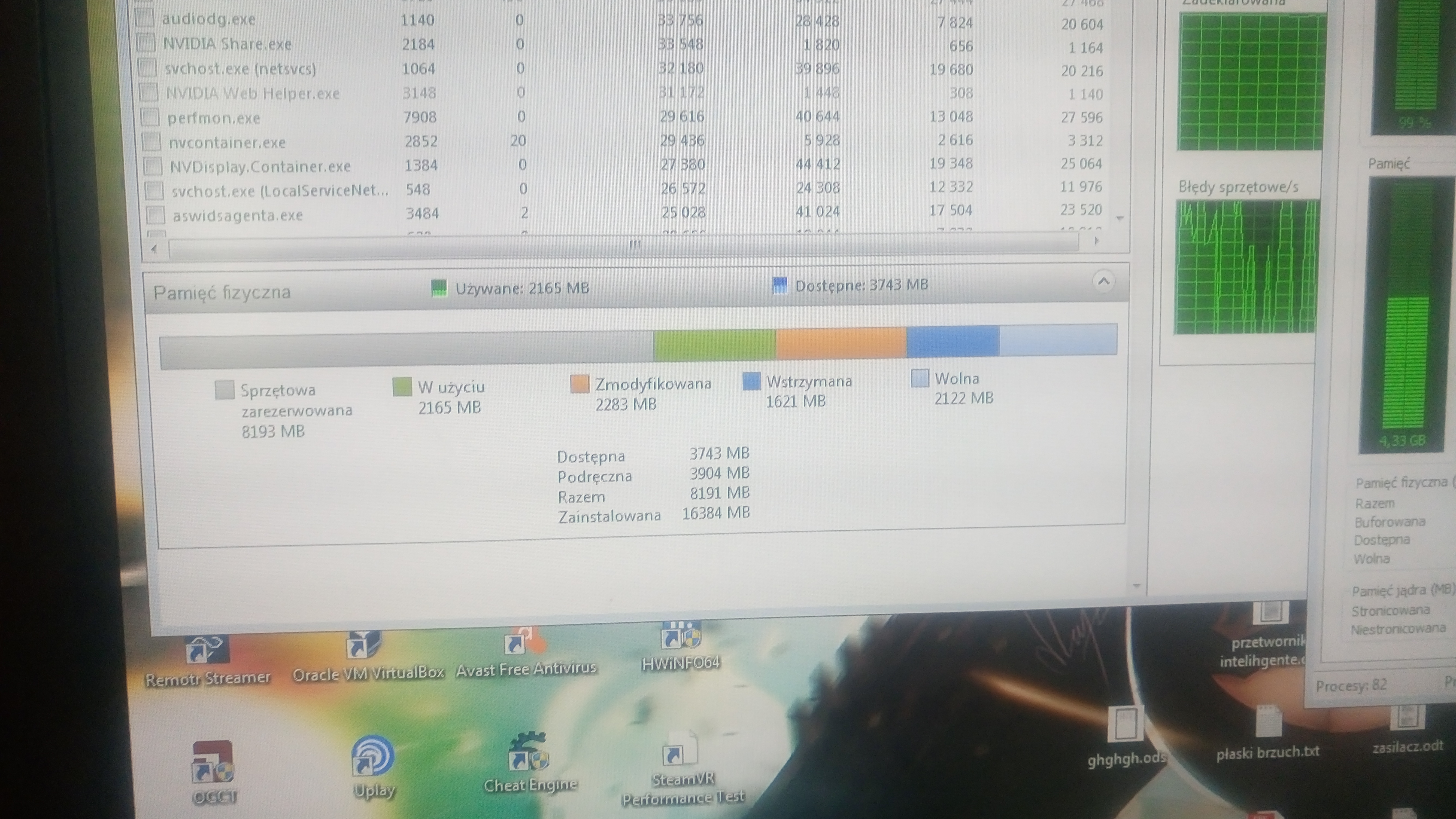

    I have 16GB of Ram 4x4GB and unfortunately the system is reading 8GB. After changing the cubes, it shows 4GB or 12GB of available memory and even nothing changes. Memories of the same company are stapled together. 0MB virtual memory, maximum memory checked off. Please help
    https://imgur.com/a/3ltKNE1
    PC Specs:
    Windows 7 Home Premium
    ASRock 980DE3 / U3S3
    AMD Fx-6300
    2x4GB DDR3 1600MHz Crucial
    2x4GB DDR3 1333MHz Good Ram
    Gigabyte Nvidia Geforce GTX 1050Ti OC

    muzeum wrote:
    If so, the graphics card is most likely to blame, and it "steals" some RAM for its own use.
    Sure, but how are we going to find out about it without the information we need?
    Post the resource monitor, the memory tab and specify how much VRAM on the card.

  • #7 17350521
    zwinka25
    Posts: 27
    Which tab from the resource monitor do you need?
  • #8 17350530
    safbot1st
    Posts: 21951
    Help: 2719
    Rate: 1583
    ... Memory? ;)
  • #9 17350534
    zwinka25
    Posts: 27
    Memory is in the first screenshot in the first post

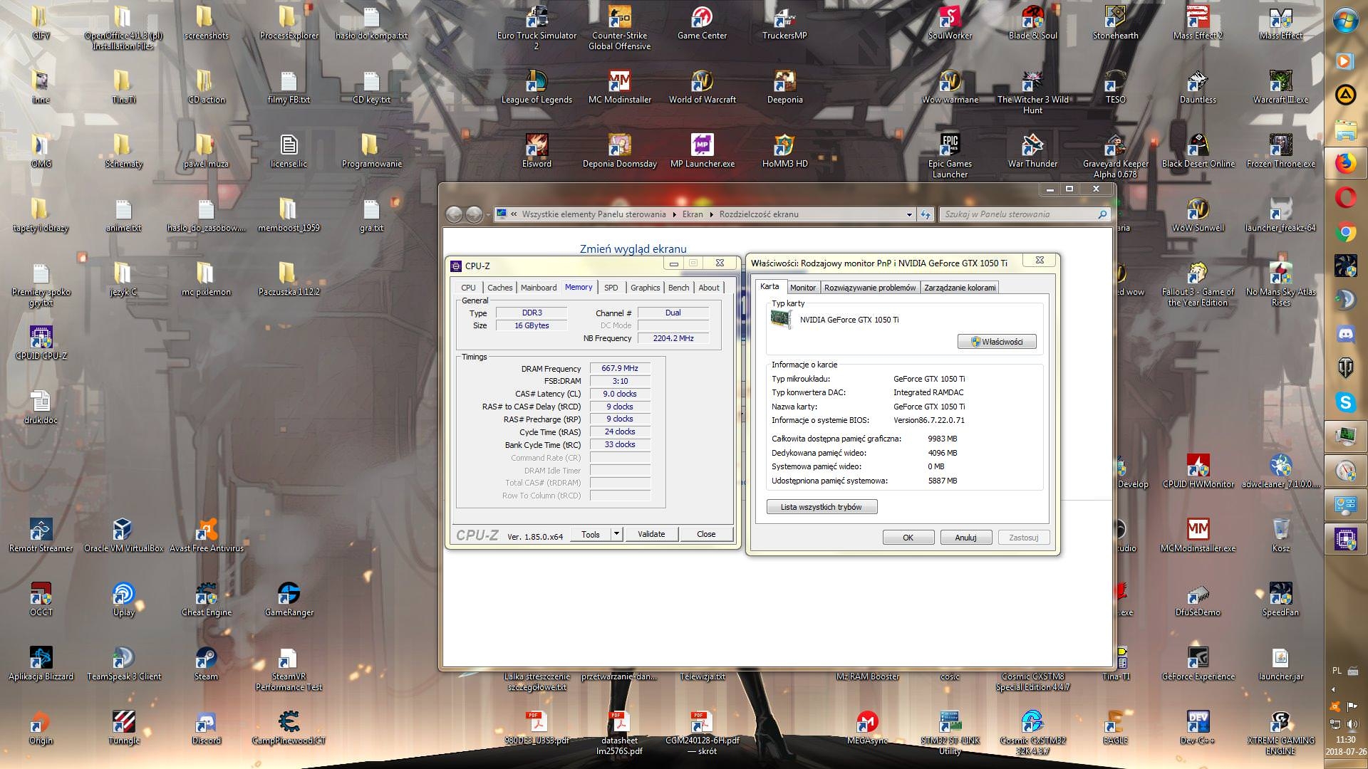

    Ok, I will do what the author does not intend to do: post the pictures correctly.
    System Memory Reserved Issue: 16GB RAM (4x4GB) Showing Only 8GB - ASRock 980DE3 / U3S3, AMD Fx-6300 System Memory Reserved Issue: 16GB RAM (4x4GB) Showing Only 8GB - ASRock 980DE3 / U3S3, AMD Fx-6300 System Memory Reserved Issue: 16GB RAM (4x4GB) Showing Only 8GB - ASRock 980DE3 / U3S3, AMD Fx-6300 System Memory Reserved Issue: 16GB RAM (4x4GB) Showing Only 8GB - ASRock 980DE3 / U3S3, AMD Fx-6300 System Memory Reserved Issue: 16GB RAM (4x4GB) Showing Only 8GB - ASRock 980DE3 / U3S3, AMD Fx-6300
    I do not know if it is normal that the system reserves such a gigantic amount of memory, because for me it is only 98 MB when you have 4 GB, and whether you have already looked for how to disable RAM sharing with an nvidia graphics card.
    EDIT:
    I found the solution http://windows7forum.pl/system-rezerwuje-za-duzo-pamieci-ram-41662-t?pid=184689#pid184689

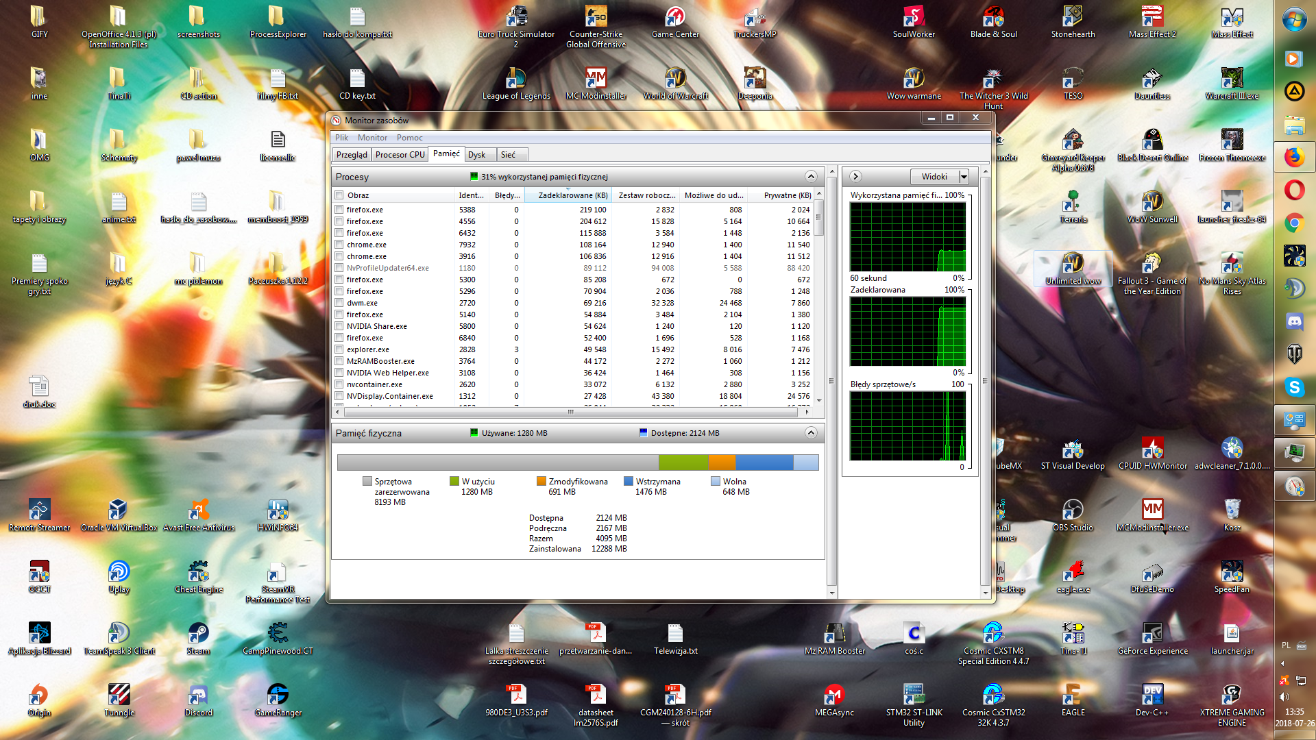

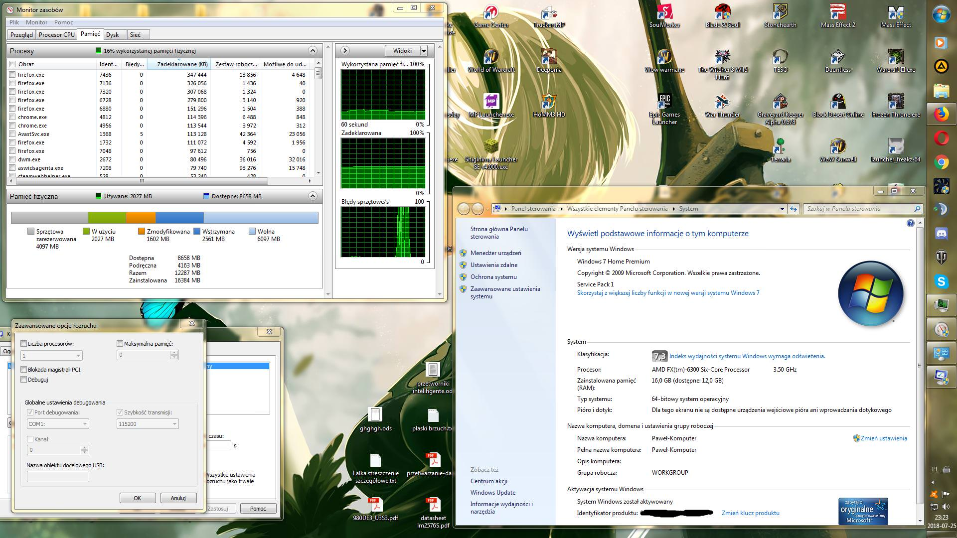

  • #13 17350726
    zwinka25
    Posts: 27
    I did what icooz found and with 4GB available from 12GB
    Added after 4 [minutes]:
    safbot1st wrote:
    When did you update it?
    Before installing the system on SSD
    After setting the max memory, nothing else
    The situation with Witcher 3 enabled
    in addition, the computer was terribly muddy

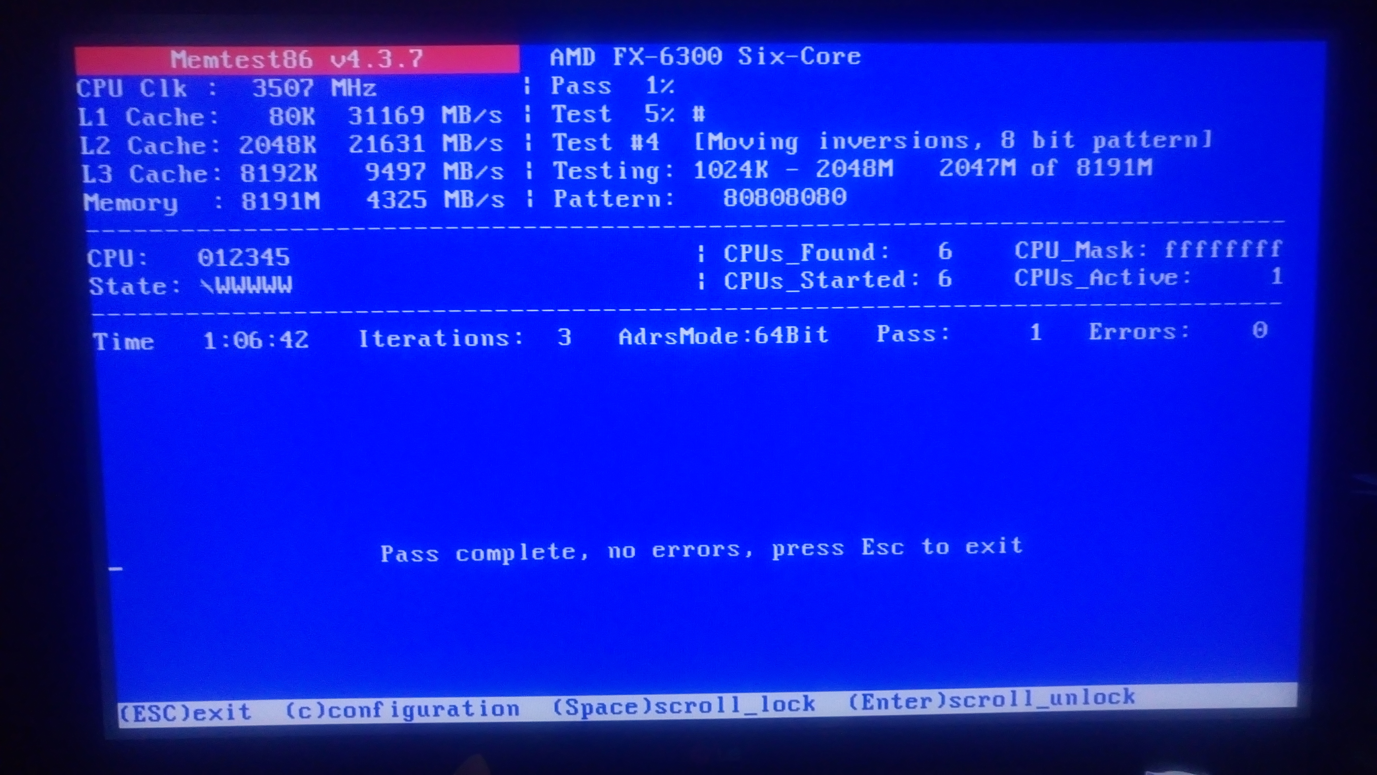

    Added after 3 [hours] 17 [minutes]:
    Results from Memtesta

  • #19 17351059
    zwinka25
    Posts: 27
    For 12GB, 4GB available
  • #20 17351065
    enhanced
    Posts: 10437
    Help: 963
    Rate: 881
    And with 16GB 8GB? With 12GB, or 3 dice, maybe you changed the slots on the disc or something will not change?
  • #21 17351068
    zwinka25
    Posts: 27

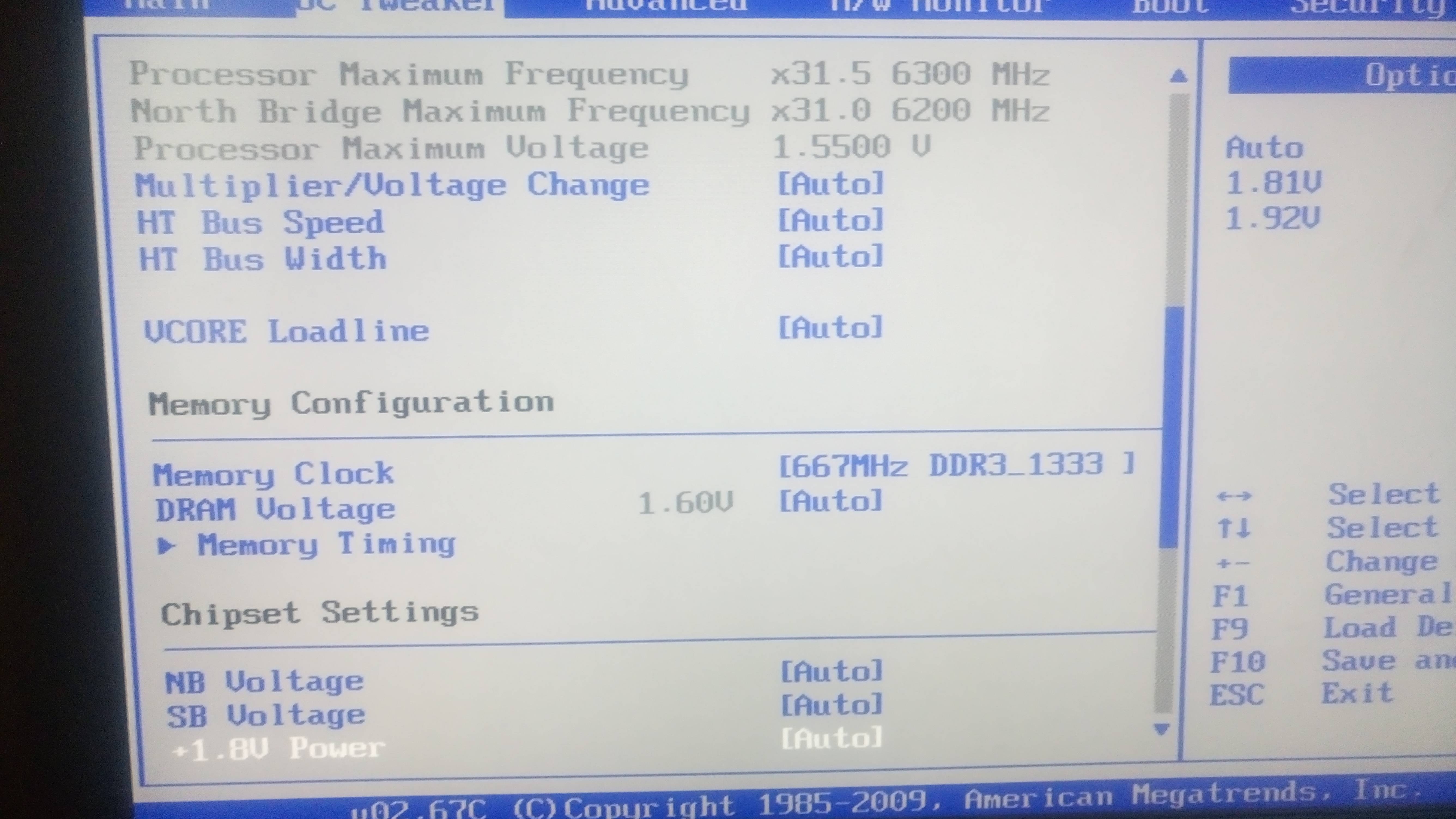

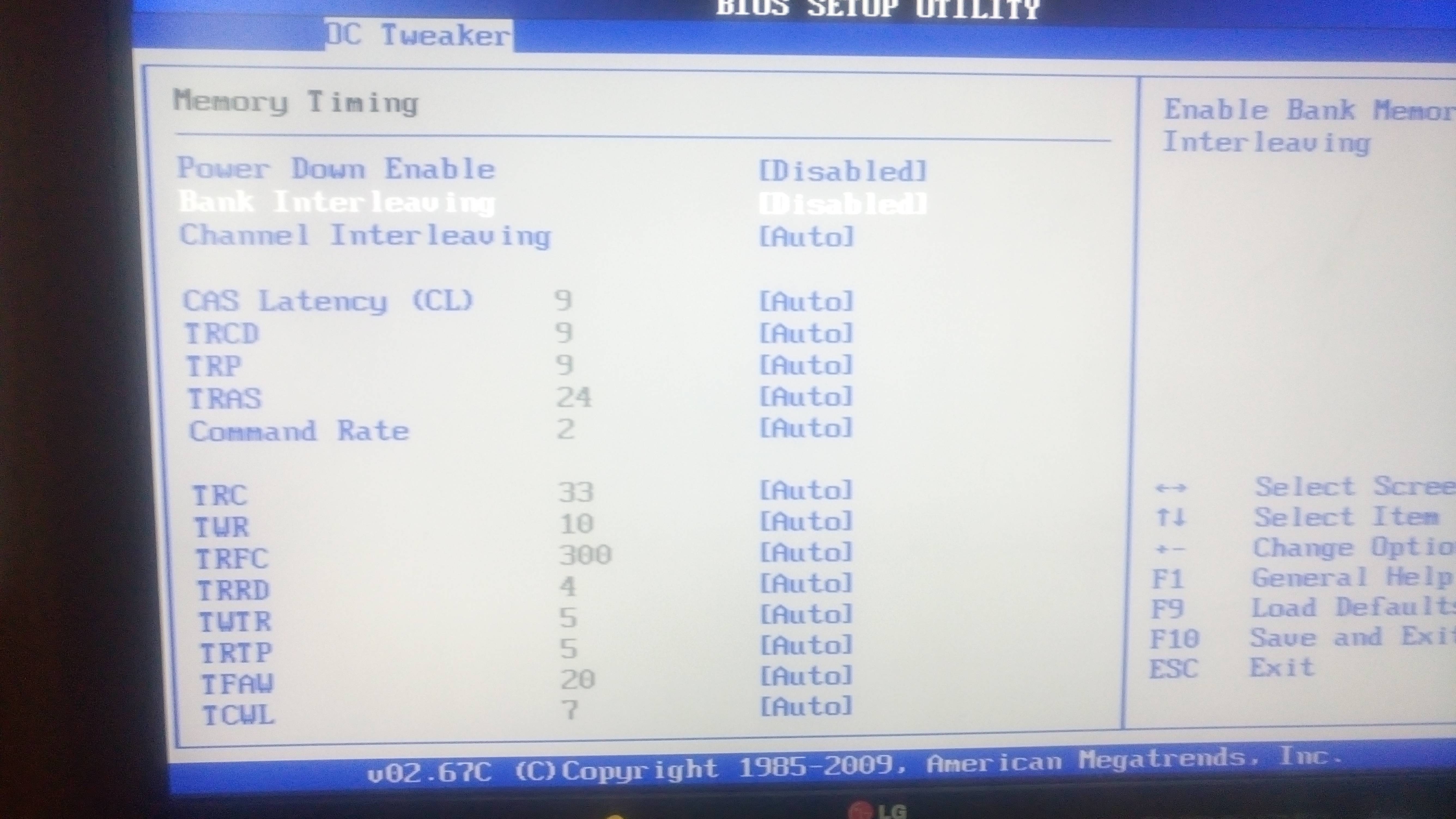

    Once, with 4 bones, I changed their places until there was 0MB reserved.
    #22 17351078
    enhanced
    Posts: 10437
    Help: 963
    Rate: 881
    Maybe you need to set pairs 1333 with 1333 and 1600 together or mix them with the slower ones in the first slots. If the CPU used to work on it, now it must also.
    Do you have the latest BIos of course?

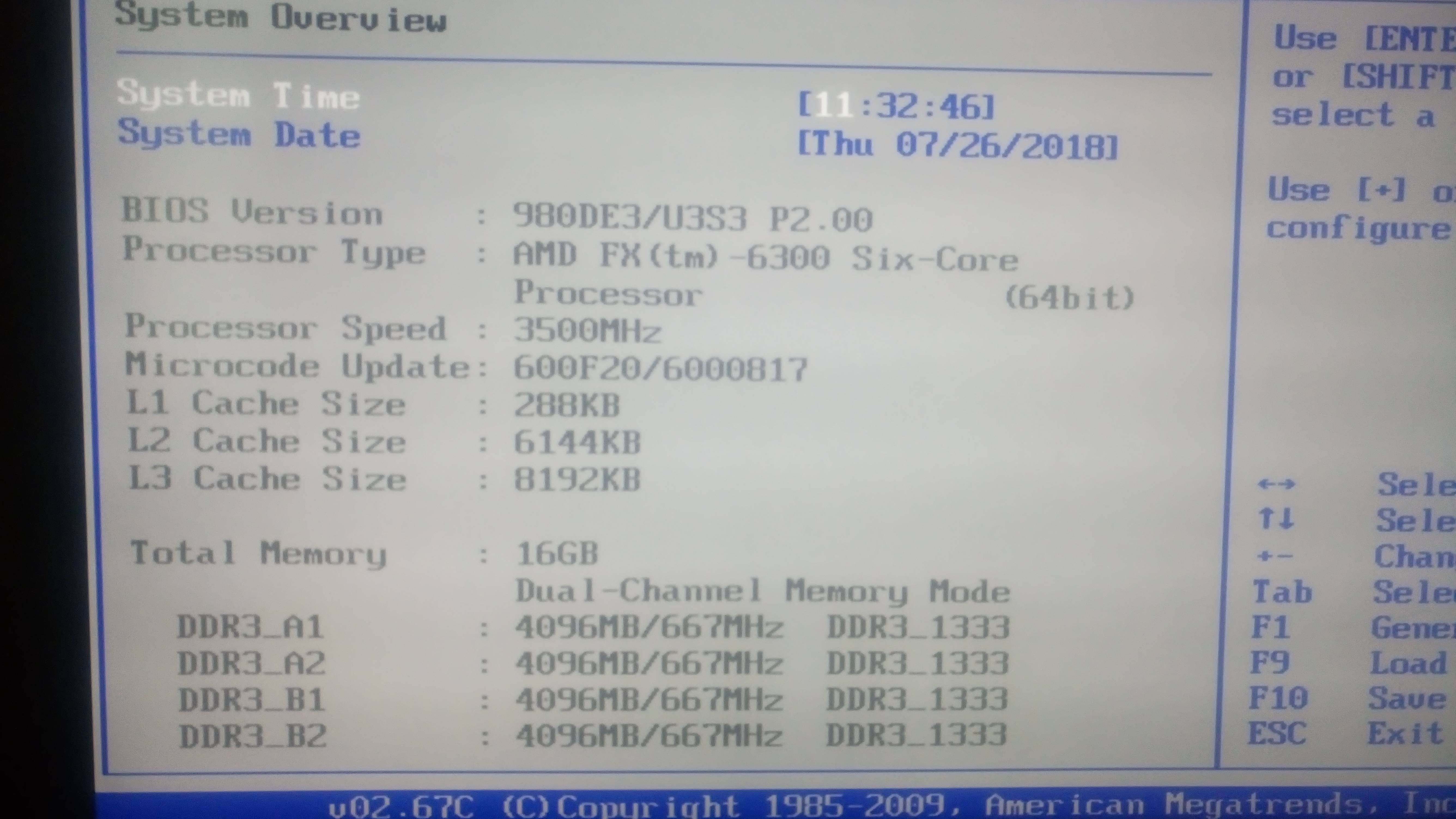

    It's Goodram 1333mhz in the first pair and Crucial 1600 in the second pair.
  • #27 17351124
    zwinka25
    Posts: 27
    After plugging GoodRam into A1 and B1 slots and Crucial in A2 and B2 slots, it is full of 16GB
  • #28 17351130
    enhanced
    Posts: 10437
    Help: 963
    Rate: 881

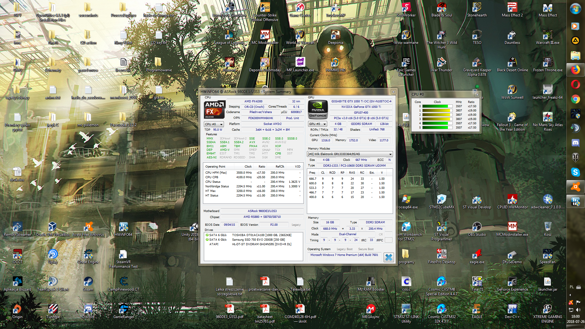

    And what are the clock and CL now - in cpu-z the SPD tab or the hwinfo summary will be visible. Do they work with stock?
    Apparently they couldn't rip at 1600MHz.
  • #29 17351140
    zwinka25
    Posts: 27
    It's strange that they couldn't get together because it worked earlier
