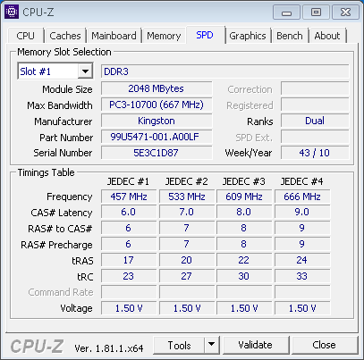

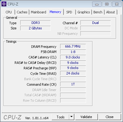

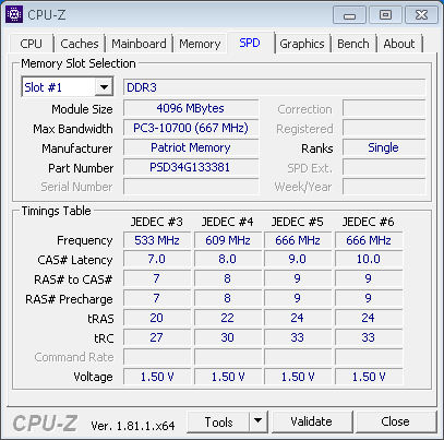

    Post screenshots from CPU-Z -> Memory and SPD tabs for both bones.

    - Computer Won't Boot with 6GB RAM: Mixing Kingston 2GB 1333MHz & GOOD RAM 4GB, ASRock Q1900M MB - Computer Won't Boot with 6GB RAM: Mixing Kingston 2GB 1333MHz & GOOD RAM 4GB, ASRock Q1900M MB - Computer Won't Boot with 6GB RAM: Mixing Kingston 2GB 1333MHz & GOOD RAM 4GB, ASRock Q1900M MB - Computer Won't Boot with 6GB RAM: Mixing Kingston 2GB 1333MHz & GOOD RAM 4GB, ASRock Q1900M MB

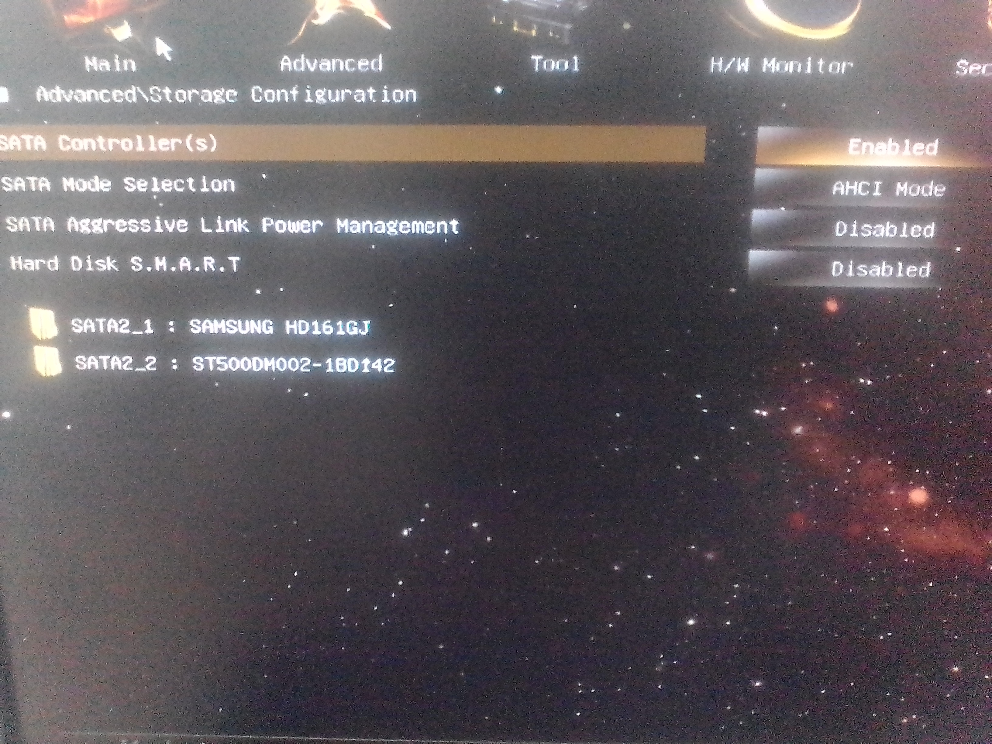

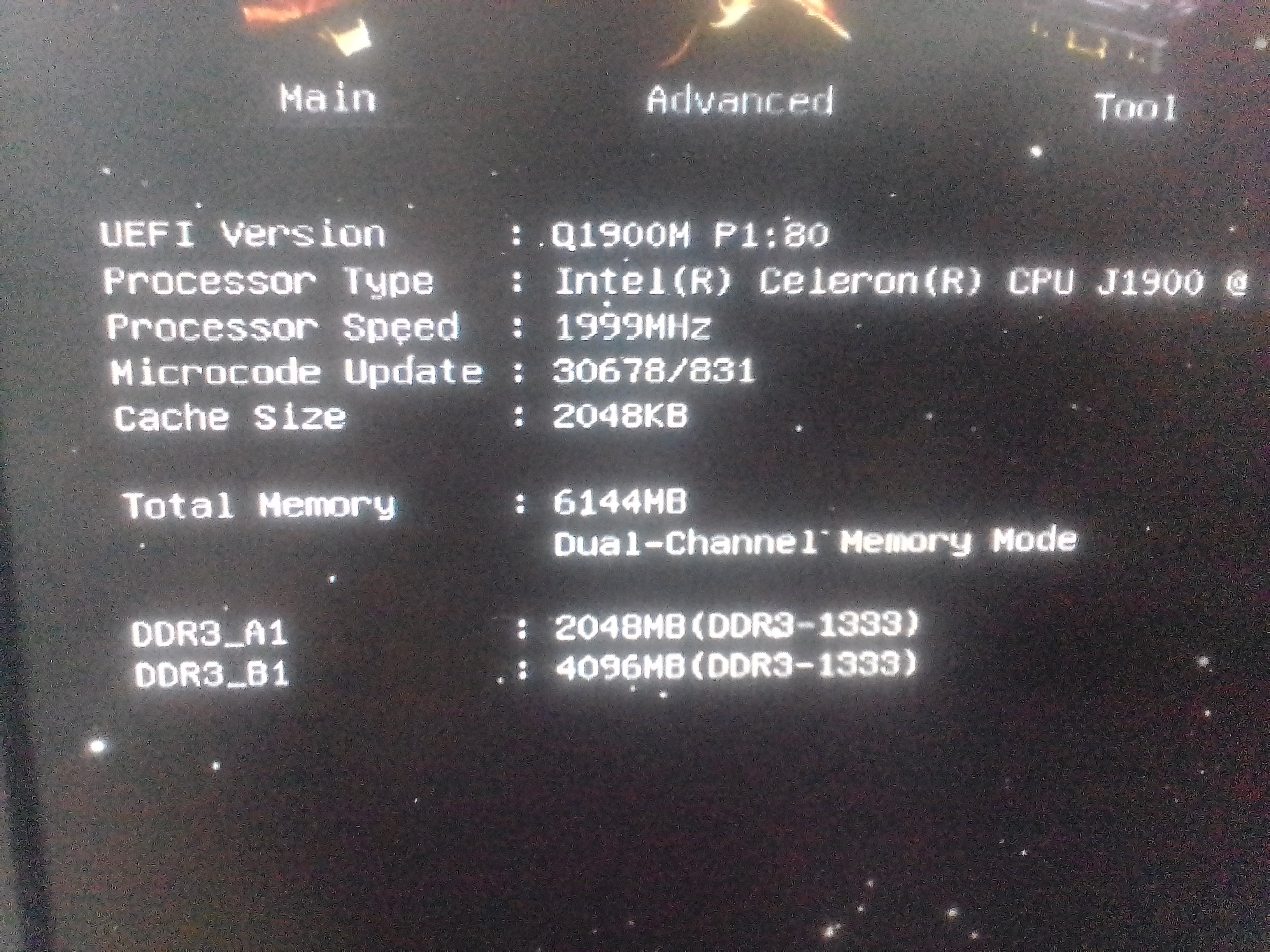

    I don't know why you gave the same thing twice instead of showing the rest of the bone slots.
    szwaja99 wrote:
    Where will I find and increase tRAS????
    in the BIOS,
  • #15 16813509
    Kasek21
    Posts: 45667
    Help: 4981
    Rate: 3549
    He did everything right!

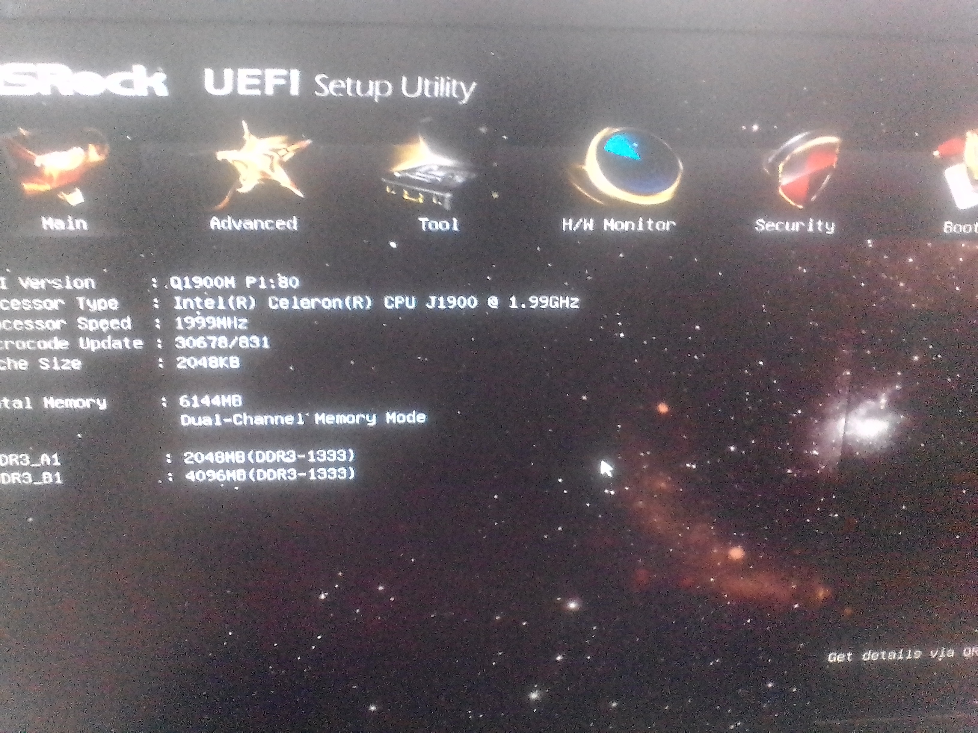

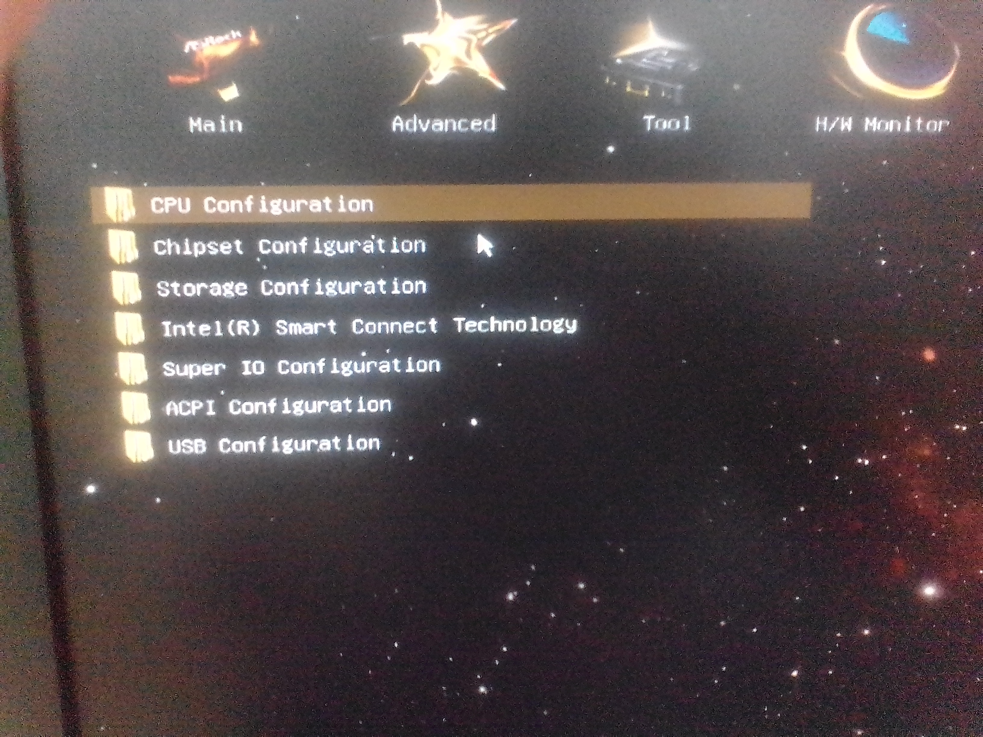

  • BIOS photos show mixed RAM causes boot hang
    #16 16813518
    szwaja99
    Posts: 26
    Rate: 12

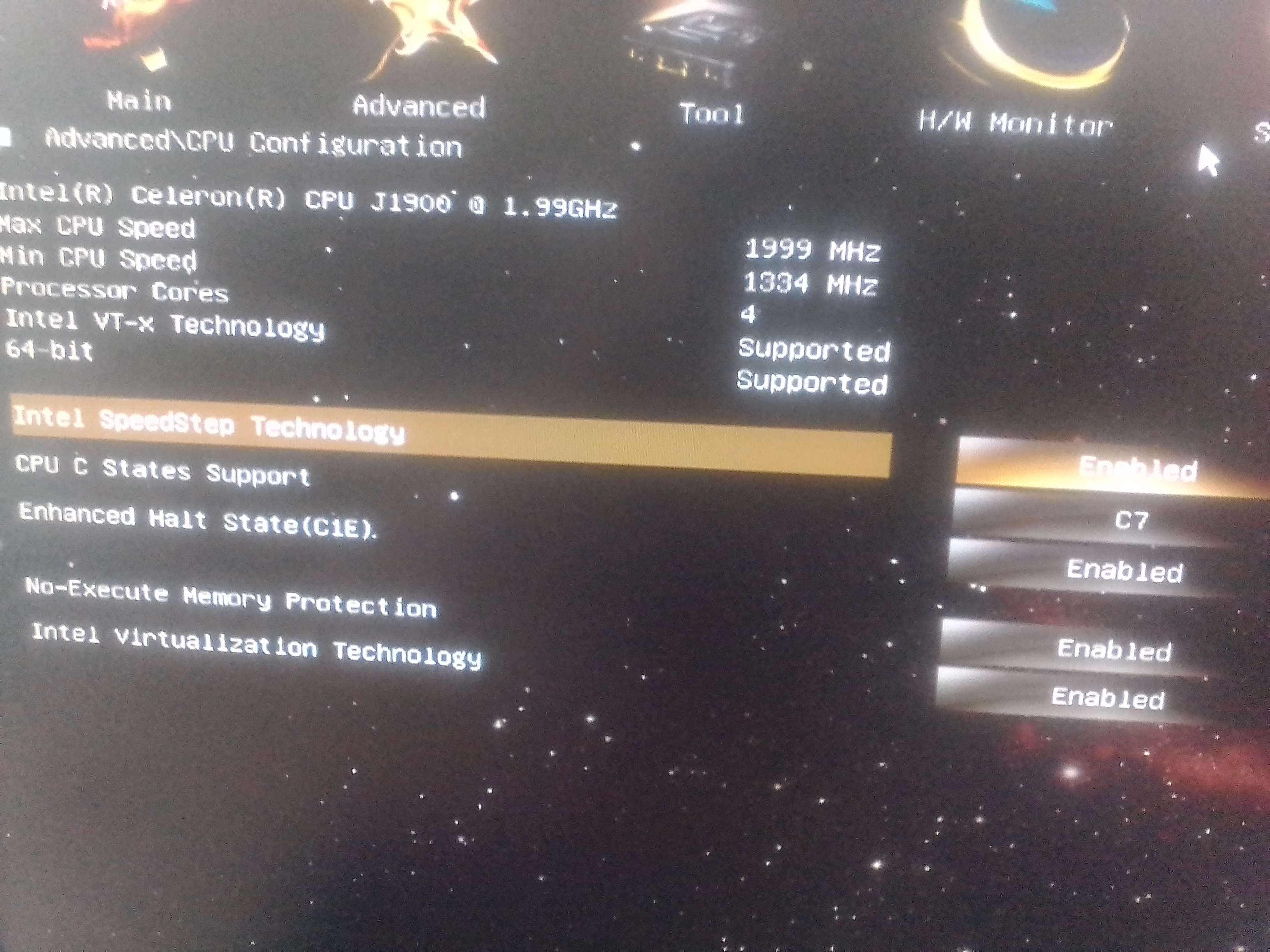

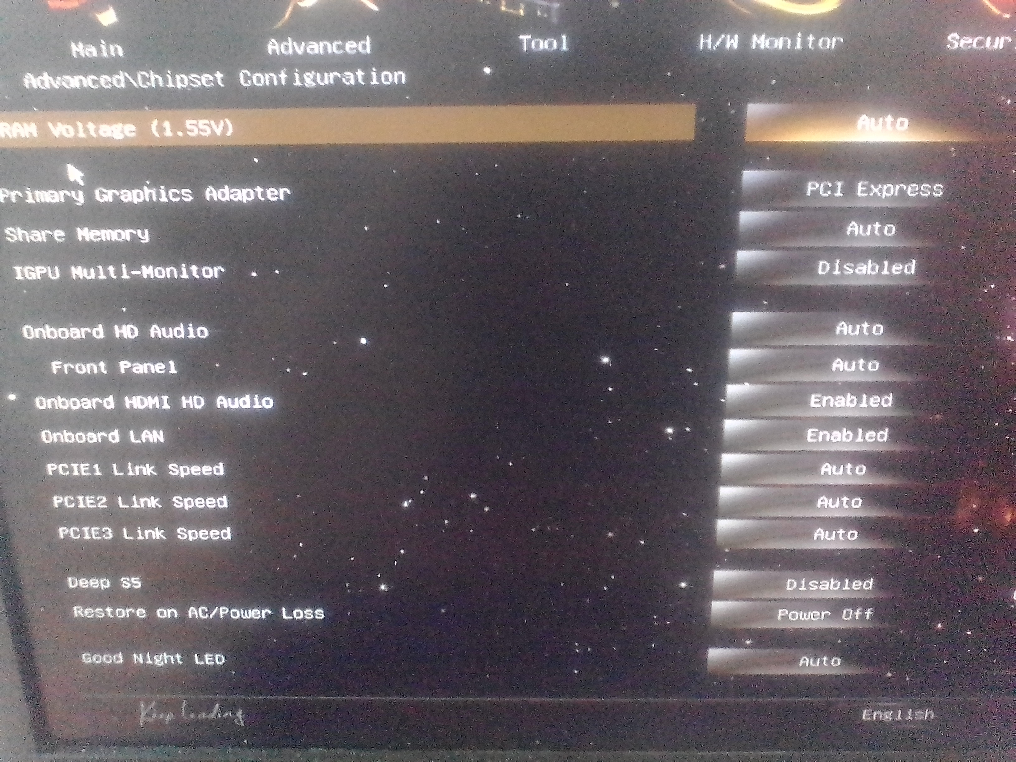

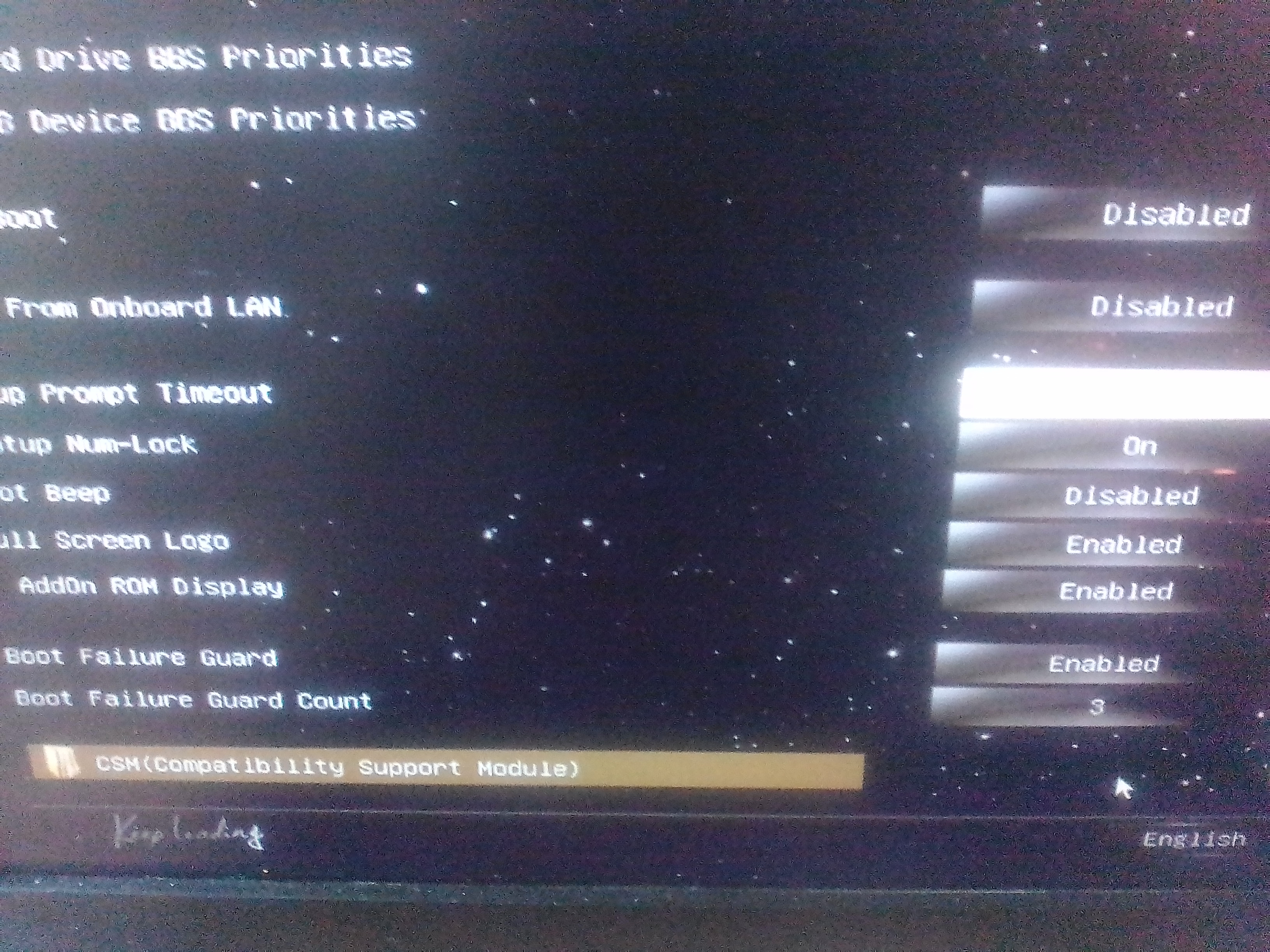

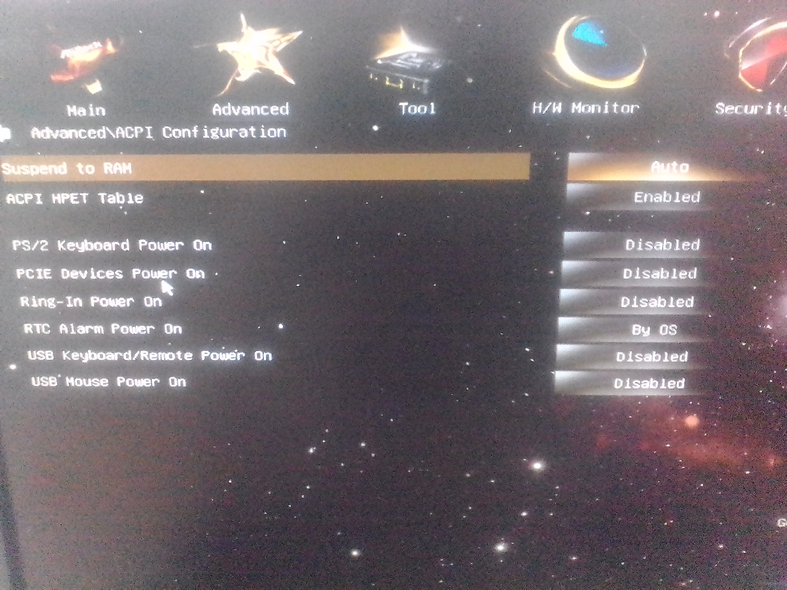

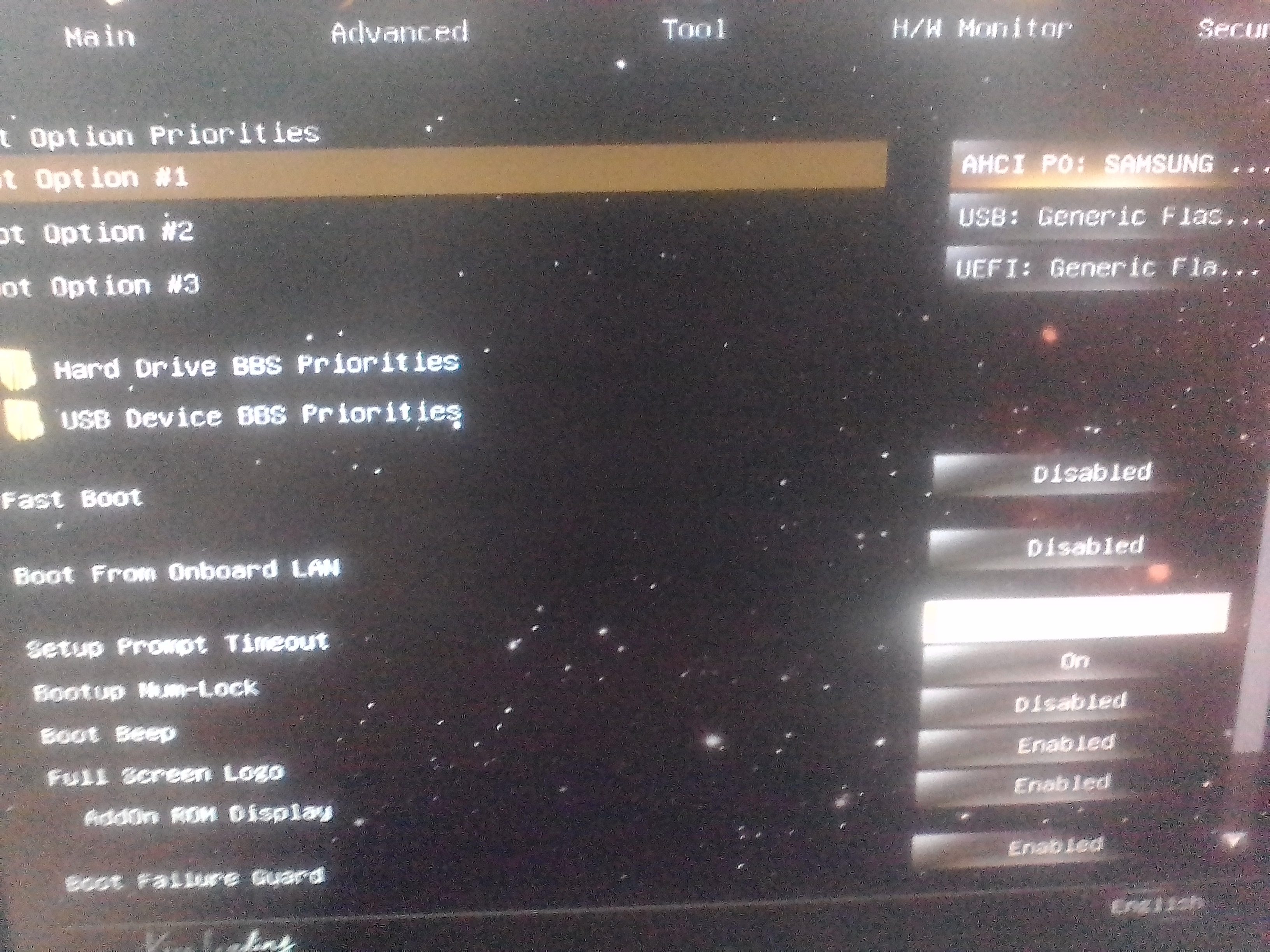

    As for these photos.
    I didn't show 2 slots because I had to insert 1 bone to make a screen, pull out, insert the second one and make a screen again.
    I mentioned that when I put both of them in, the screen does not light up, as I put two in reverse, it jams when loading the system and I can't do anything.
    Added after 40 [minutes]:
    These are photos from the bios (sorry, the quality is poor 8-) read it) I think it will help you.
    - Computer Won't Boot with 6GB RAM: Mixing Kingston 2GB 1333MHz & GOOD RAM 4GB, ASRock Q1900M MB - Computer Won't Boot with 6GB RAM: Mixing Kingston 2GB 1333MHz & GOOD RAM 4GB, ASRock Q1900M MB - Computer Won't Boot with 6GB RAM: Mixing Kingston 2GB 1333MHz & GOOD RAM 4GB, ASRock Q1900M MB - Computer Won't Boot with 6GB RAM: Mixing Kingston 2GB 1333MHz & GOOD RAM 4GB, ASRock Q1900M MB - Computer Won't Boot with 6GB RAM: Mixing Kingston 2GB 1333MHz & GOOD RAM 4GB, ASRock Q1900M MB - Computer Won't Boot with 6GB RAM: Mixing Kingston 2GB 1333MHz & GOOD RAM 4GB, ASRock Q1900M MB - Computer Won't Boot with 6GB RAM: Mixing Kingston 2GB 1333MHz & GOOD RAM 4GB, ASRock Q1900M MB - Computer Won't Boot with 6GB RAM: Mixing Kingston 2GB 1333MHz & GOOD RAM 4GB, ASRock Q1900M MB - Computer Won't Boot with 6GB RAM: Mixing Kingston 2GB 1333MHz & GOOD RAM 4GB, ASRock Q1900M MB - Computer Won't Boot with 6GB RAM: Mixing Kingston 2GB 1333MHz & GOOD RAM 4GB, ASRock Q1900M MB - Computer Won't Boot with 6GB RAM: Mixing Kingston 2GB 1333MHz & GOOD RAM 4GB, ASRock Q1900M MB

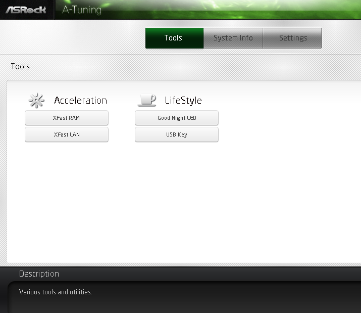

    A-Tuning is ASRock's all-in-one software with a new interface, more new features, and enhanced usability. It includes EZ OC, Auto Tuning, XFast LAN, XFast RAM, OC tweaker , Live Update, Tech Service and many more!
    Download: ASRock A-Tuning utility and use OC Tweaker.
    http://www.asrock.com/mb/Intel/Q1900M/index.pl.asp?cat=Download

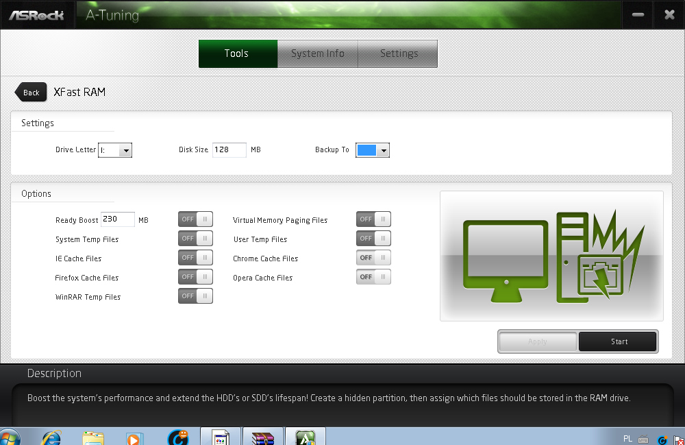

    Ok, I installed it, now what????
  • #21 16813897
    Kasek21
    Posts: 45667
    Help: 4981
    Rate: 3549
    You have OC Tweaker app there you can set RAM parameters.
    Added after 3 [minutes]:
    OC Tweaker I don't see anything like that
  • #23 16813931
    Kasek21
    Posts: 45667
    Help: 4981
    Rate: 3549
    This is info from the manufacturer's website - I do not know this board - in UEFI you do not have this option, so either the application remains, or this board does not have software to change the working parameters of RAM memory modules (which I doubt),
