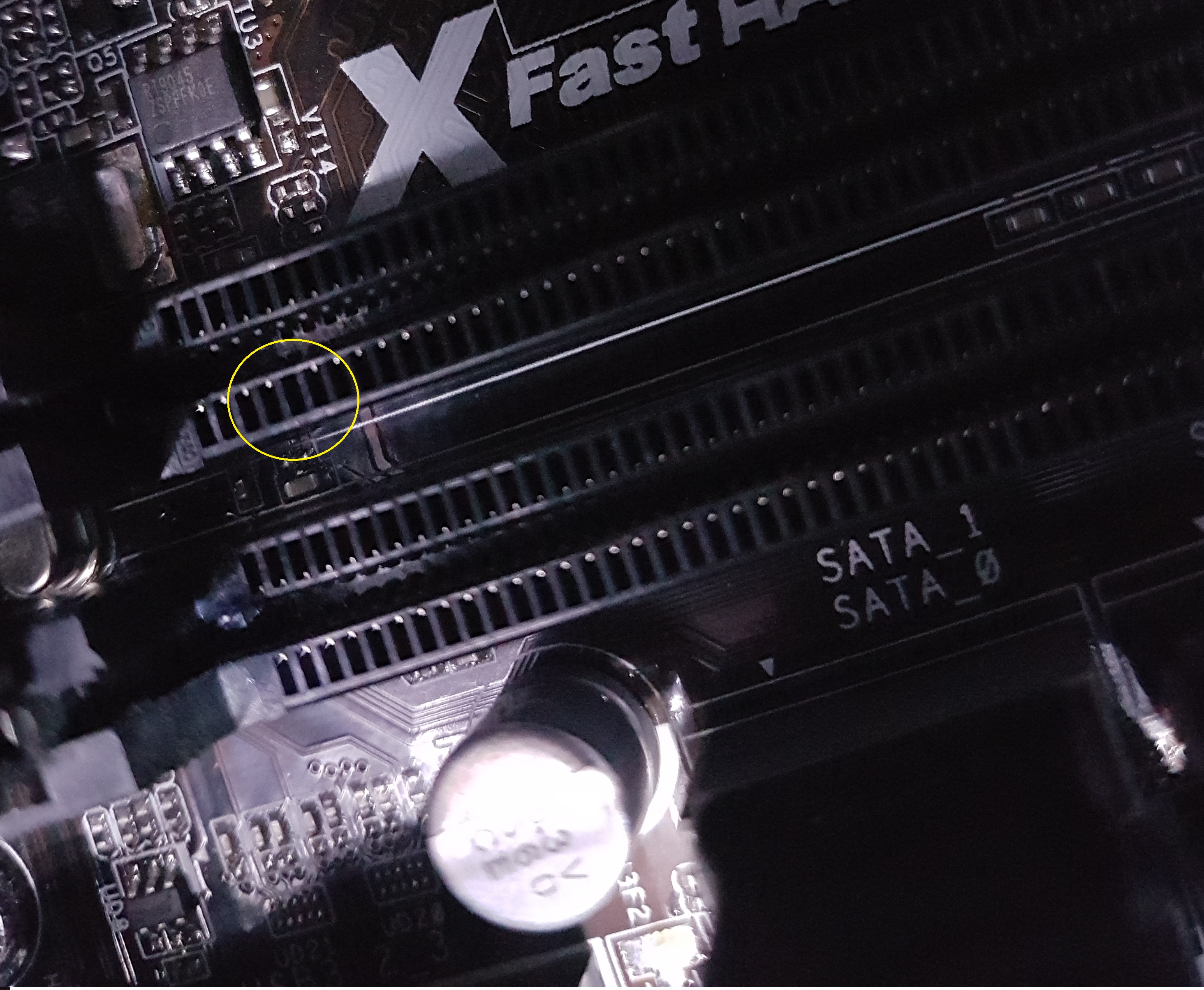

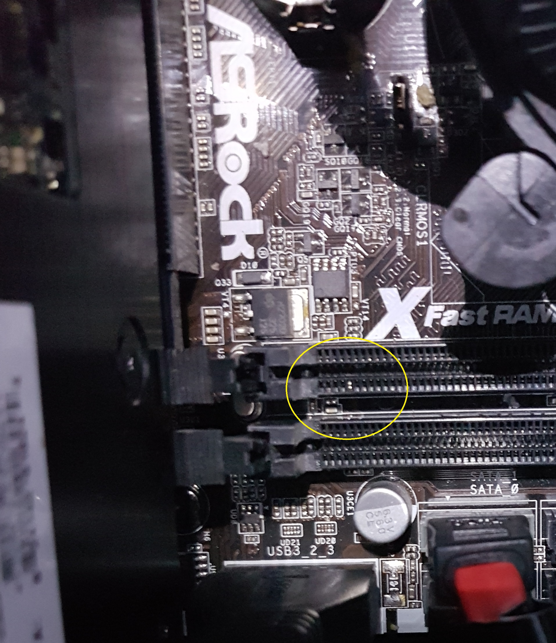

    Following the advice from 310artur, I looked at the RAM bone slot - such a non-obvious obvious, because no one was looking there.
    It turned out that one "golden" was, I vomited a tiny brush and carefully dusted it all.
    probably someone tried to insert the ram bone upside down because the slot - 5th "pad" - it looks like he lost his "connectors" (which corresponds to the 5th "gold on the bone - photo post above")
    Below are photos before sweeping. Computer Beeping Errors: Ram Slot Issues and System Clock Errors - Seeking Guidance
    Photo after cleaning: Computer Beeping Errors: Ram Slot Issues and System Clock Errors - Seeking Guidance
    In another computer, I was unable to check the RAM because the bios has the option of detecting another new bone, but since such a message was the same ram, it probably detected? or even if there is no framework, the bios gives the same message ??
    I think I have a damaged first ram slot. and it doesn't read RAM dice - if I'm wrong correct me.
    Believing the computer service. My motherboard must have a die in 1 slot, and cannot have the first empty and a die in the second slot
