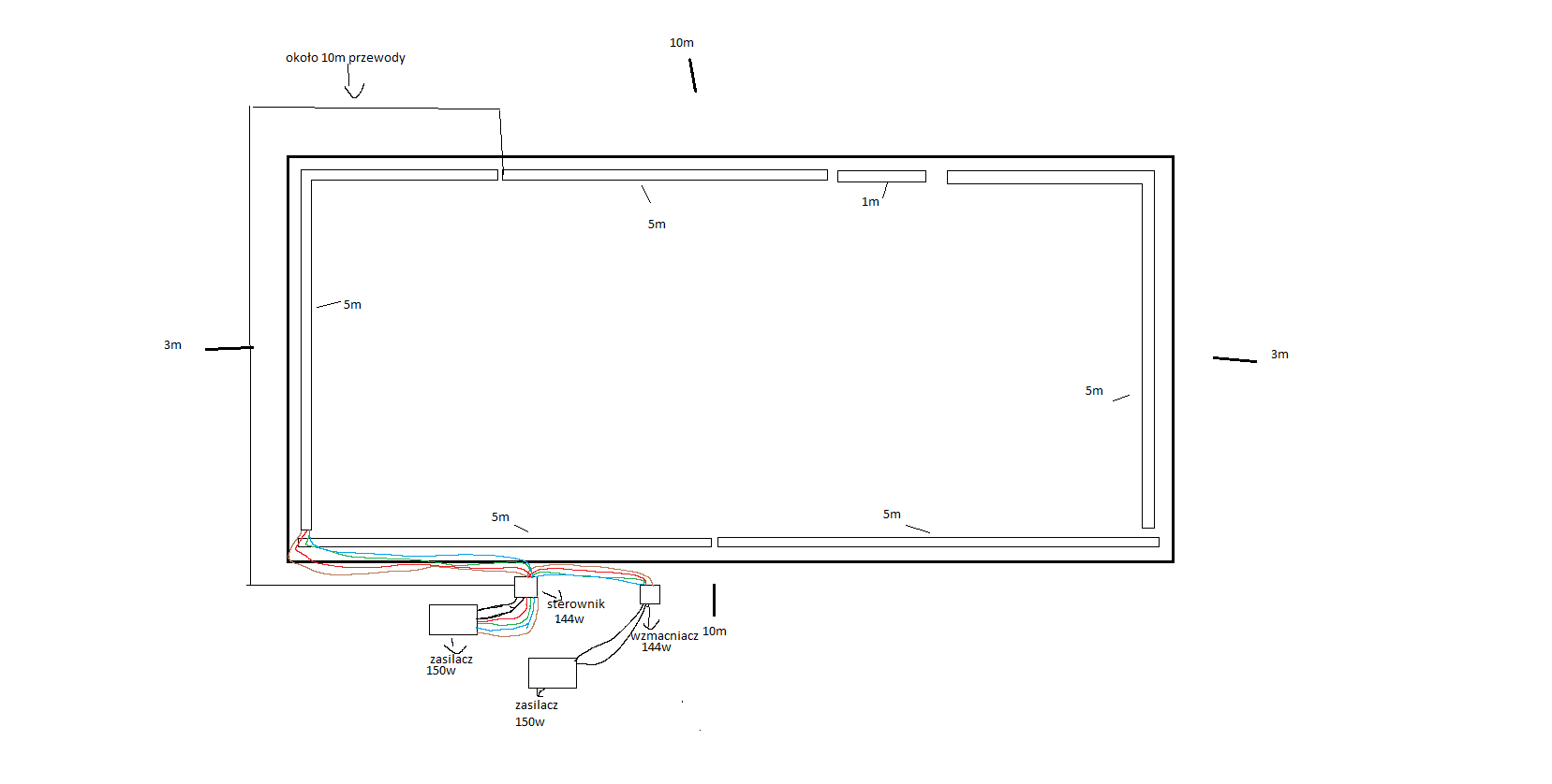

    The topic has already been discussed many times with led strips on other topics, I found answers to all my questions, except for one what cables to choose; / so I'm going to connect the rgb 7.2w / 1m led strip in the ceiling, the total length is 26 m and each 5m of the tape will be powered by a separate cable and just I do not know what the cross-section is, I was counting on the calculator, the wires were 4mm each. Two 5m strips will be close to the controller, that's where I think 4x0.5mm is enough, but the next 5m of tape is a 5m cable and the last strip is 10m away from the controller. And my question is what will be the cable cross-section for 5m and 10m
    I am pasting a plan more or less, how I am going to do it, maybe someone will write the appropriate cables on it
    best regards

    thanks for the answer, so it results that for a length of 5m 4x1mm is enough
