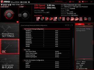

    Hello. I have the kit as below, but I have a problem with the ram memory. The board automatically sets the clock to 2133MHz, using the xmp-1 profile manages to start the computer with the memory clock speed of 3066MHz, but after a few days or a reset, the computer has a problem and cannot start - the clock returns to 2133MHz. I tried to manually set the ram voltage from 1.35 to 1.38 and the 3066MHz clock, but the computer immediately throws a ram error and returns to 2133. (Bios latest).
    Processor: Ryzen 7 1700
    Motherboard: MSI B350 TOMAHAWK
    Ram: G.Skill [Ripjaws V] F4-3200C16D-16GVKB (2x8GB 3200MHz)
    Power supply: Corsair VS-450
    I am asking for help in setting these memories to work best at 3200 or at least 3066 each time ;)

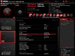

    Set the main timings to even numbers.
    Increase the ProcODT value to 60 Ohms
    Turn off Power Down Mode.
    Try higher voltages, e.g. SOC 1.1v DRAM 1.4v
    If higher voltages don't work, try lower ones like 0.95v SOC 1.35v DRAM
    Do not switch immediately from 2133MHz to 3066Mhz, instead increase the clock gradually, e.g. first 2667Mhz, then 2933MHz and then 3066MHz

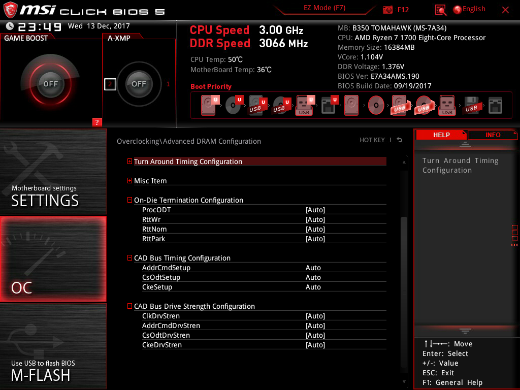

    Unfortunately, I did not find only the "ProcODT" option, but thanks to the Power Down Mode option and the 1.38 voltage, I was able to set the framework to 3066mhz so that the computer wakes up every time ;) Unfortunately, 3200 failed, i.e. 3200 sets and flashes, but when I turn off the computer, it will not get up later ...
    lisek wrote:
    Perhaps this will help in selecting RAM Link_ gskill_configurator
    They chose the Ram in the store for the whole set, so I didn't even check it myself before.
  • #9 16888397
    Piterixos
    Posts: 1396
    Help: 38
    Rate: 56

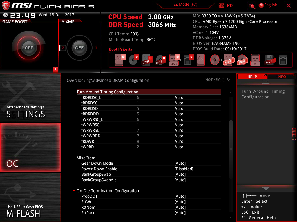

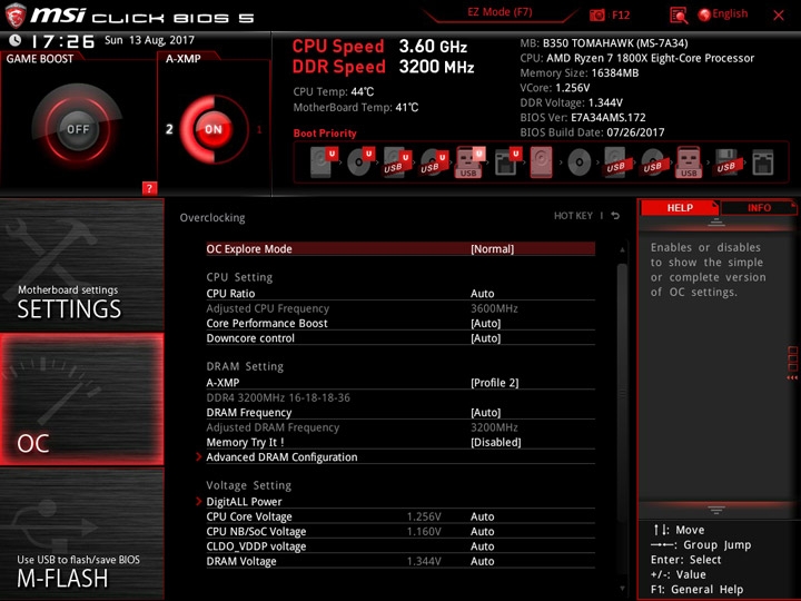

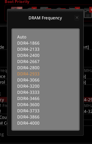

    Ryzen 7 1700, MSI B350 TOMAHAWK, G.Skill Ripjaws V F4-3200C16D-16GVKB: RAM Clock Issue at 3200MHz Ryzen 7 1700, MSI B350 TOMAHAWK, G.Skill Ripjaws V F4-3200C16D-16GVKB: RAM Clock Issue at 3200MHz Ryzen 7 1700, MSI B350 TOMAHAWK, G.Skill Ripjaws V F4-3200C16D-16GVKB: RAM Clock Issue at 3200MHz

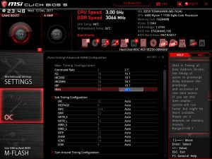

    In the third screen, you have this option, it can help.
    By the way, could you upload screenshots of your settings? I mean the settings that are visible in the screenshots I posted. I am also trying to set the clocks to at least 3066Mhz.
  • #10 16889015
    cysiu388
    Posts: 20
    Rate: 7
    Please :D
    Ryzen 7 1700, MSI B350 TOMAHAWK, G.Skill Ripjaws V F4-3200C16D-16GVKB: RAM Clock Issue at 3200MHz Ryzen 7 1700, MSI B350 TOMAHAWK, G.Skill Ripjaws V F4-3200C16D-16GVKB: RAM Clock Issue at 3200MHz Ryzen 7 1700, MSI B350 TOMAHAWK, G.Skill Ripjaws V F4-3200C16D-16GVKB: RAM Clock Issue at 3200MHz Ryzen 7 1700, MSI B350 TOMAHAWK, G.Skill Ripjaws V F4-3200C16D-16GVKB: RAM Clock Issue at 3200MHz
    It is stable at the moment :)

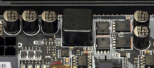

    I would probably sit at 2666MHz instead of 2933Mhz, and Timings instead of being quite pampered as they would be the default now.
    Just control the temperatures and voltages, because today two such boards were brought (MSI B350 TOMAHAWK) for OC RAM and CPU, burned in part DC-DC RAM power supply
    - 1-phase power supply for the Richtek controller marked as 8Y = 3L (??) and two field Nikos PK616BA / PK632BA

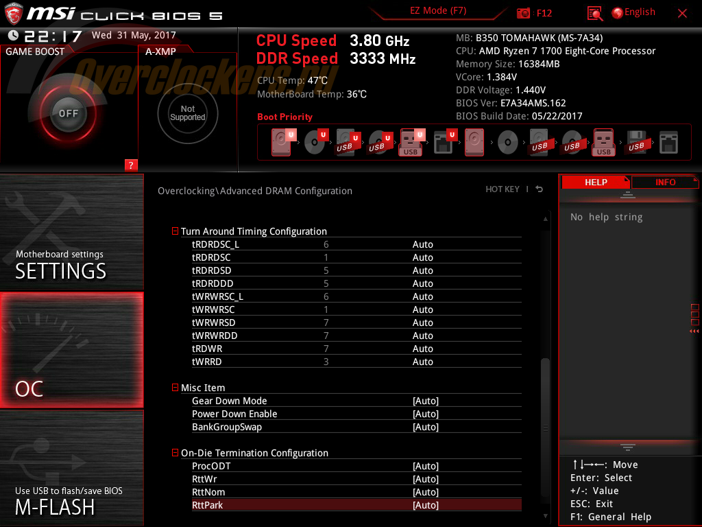

    * possibly a solution from older boards on AMD X370

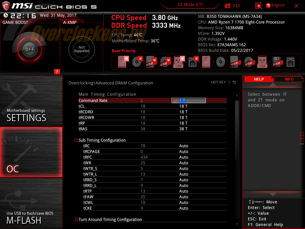

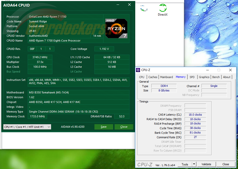

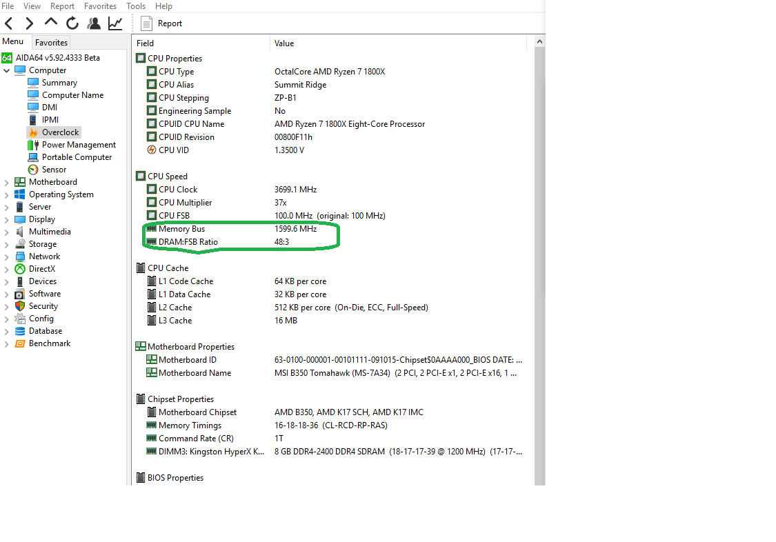

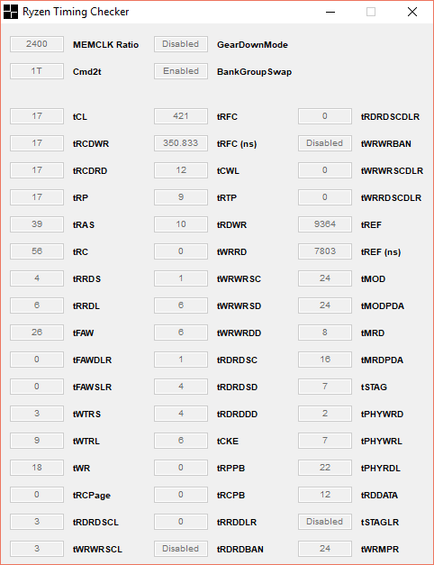

    ps
    That's for 2400 MHz RAM
    Here for 3200
    * it's circled

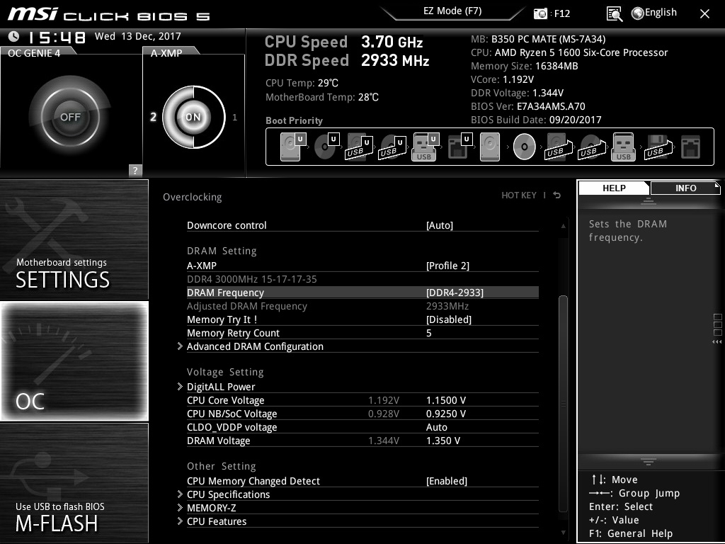

    I will not hide that I do not understand what these screens are for.
    After all, I didn't buy 3000MHz CL15 RAM to make 2400MHz CL17 out of it. And the bios screen shows nothing interesting.
    You did not write the most important thing - was this defect due to overclocking? And if so, how strong? DDR4 can finally run safely even at 1.5v, so I can not really imagine a situation that even the strongest OC at 1.35v would be able to overheat anything.

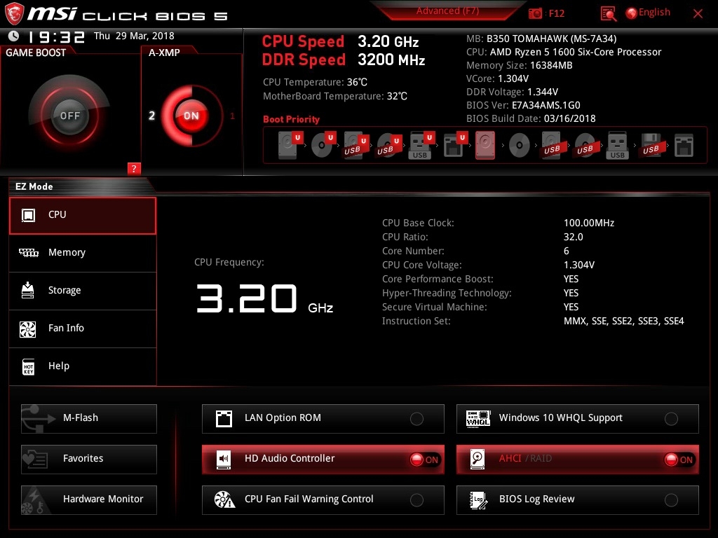

    Ok, I did an update it looks like it's okay. It even works on 3200, the last bios from March 16, 2018. The store wanted me to send them the bones, they did not write anything to me and this, as you can see, was not a problem in the bones.
