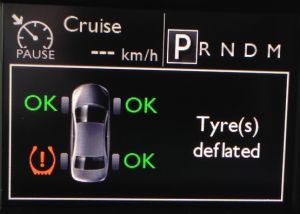

    Hello, Colleagues
    Is it possible to activate the pressure in wheels / tires to be displayed on the radio display in Peugeot 5008 or maybe someone succeeded? Greetings Marcin

    The original radio is probably not possible, they are aftermarket, dedicated to the car model.

    On the radio with navi, it displays info about the wheel mismatch and the indicator on the meter has determined this option in partner III
    In those with rd4 only the indicator on the meter

    My colleague Starost is rather about something like that

    That's what I mean, it should show the pressure value on individual wheels, as in the attached photo by ladamaniac. Thank you, if anyone knows how to do it, please give me a hint. Greetings Marcin

    This effect cannot be achieved on the original radio. It is similar in the higher models.

    I saw in lexia that there are 3 settings in the radio display, but nothing was shown on the display, there is still an air conditioning display, but it showed 0.0. If you can't, you need to close the post. Best regards, Marcin
