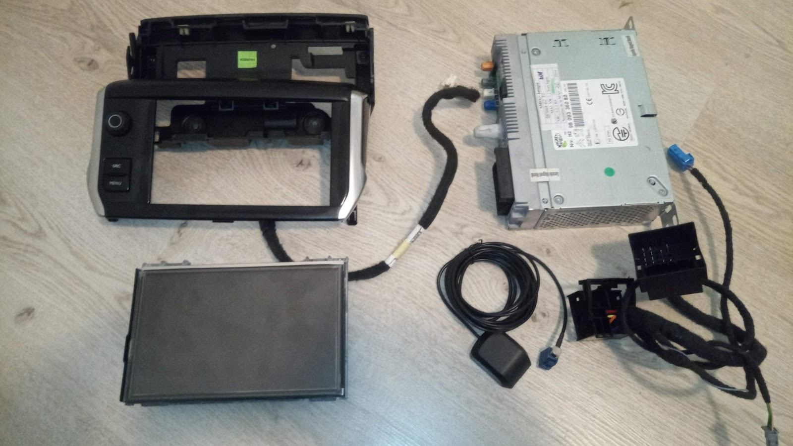

    seba019 wrote:
    It is about changing the radio from a normal radio to a large original 2 din touch. Does the installation need to be reworked for it, or does everything fit?
    The missing signals + LVDS cable for the screen need to be added. Correct kit looks like this:
    Complete set for car screen installation with main unit and cables.
    - screen
    - bezel + button panel
    - GPS antenna
    - LVDS cable
    - radio head unit
    - cable-transfer adapter
  • #18 21061442

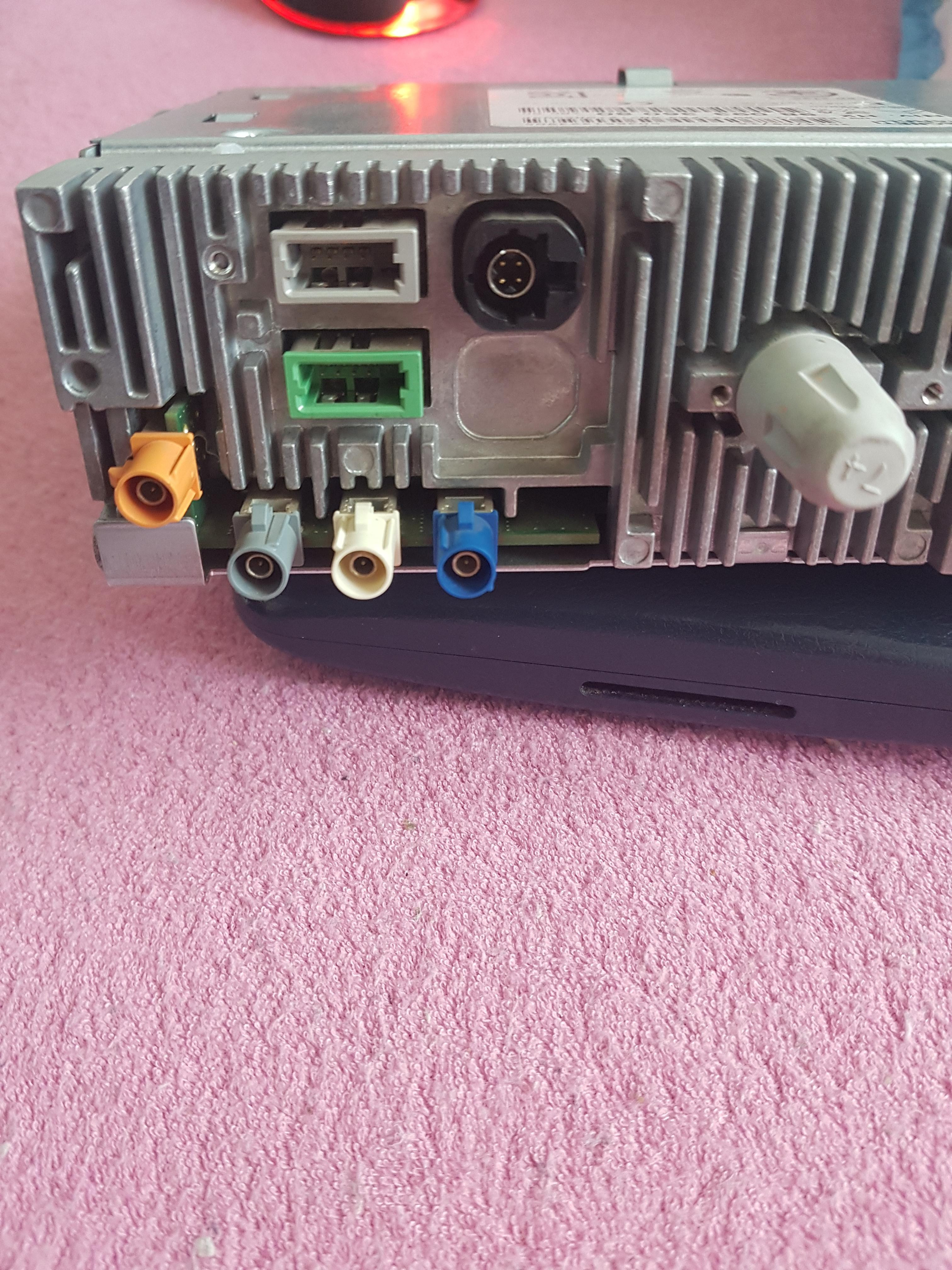

    Genua2580
    I have a 2014 208 with a small radio. I have bought a large navi with radio but without wires or harness. Can you give me some hints what to buy to make it work?
    • Peugeot 208 Original Navigation Installation: Plug & Play or Modifications Needed? 20240229_190814.jpg (965.33 KB) You must be logged in to download this attachment.
    • Peugeot 208 Original Navigation Installation: Plug & Play or Modifications Needed? 20240229_190918.jpg (1.28 MB) You must be logged in to download this attachment.
    • Peugeot 208 Original Navigation Installation: Plug & Play or Modifications Needed? 20240229_191142.jpg (1.13 MB) You must be logged in to download this attachment.
    • Peugeot 208 Original Navigation Installation: Plug & Play or Modifications Needed? 20240229_190934.jpg (843.08 KB) You must be logged in to download this attachment.
  • #19 21061708
    artur.heise
    Posts: 1637
    Help: 226
    Rate: 614
    Genua2580 wrote:
    I have a 2014 208 with a small radio. I have bought a large nawi with radio but without wires or there harness .Can you give me some hints on what I should buy to make it work?
    Compare with the list above.

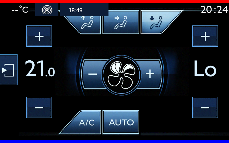

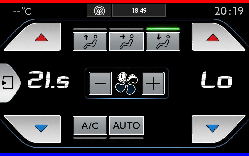

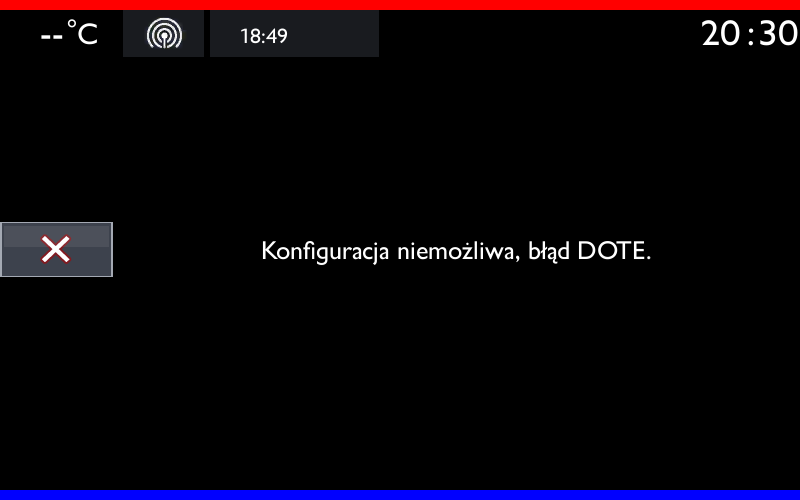

  • #20 21230322
    123Irek
    Posts: 17
    >>18266941 unfortunately, but this is not the case, after changing the VIN, the radio does not beep, but after pressing the menu button it says: configuration impossible, DOTE error.
  • #21 21230396

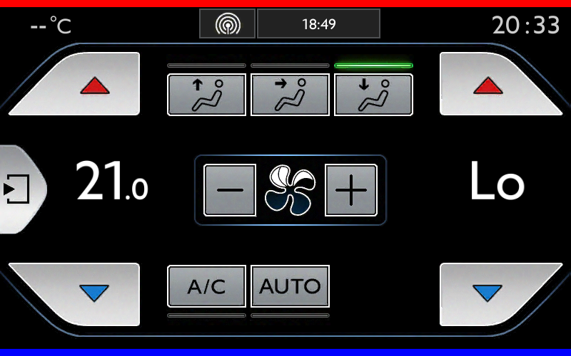

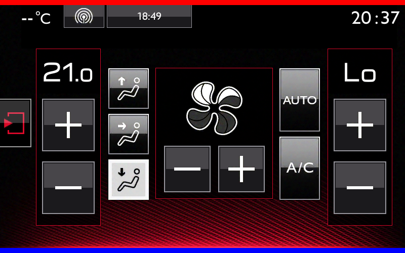

    artur.heise
    Posts: 1637
    Help: 226
    Rate: 614
    123Irek wrote:
    DOTE error.
    That is, a telecoding (configuration) error - the settings for the vehicle type and version of the so-called "harmony" (i.e. the type of graphics displayed) are not correct. You can still switch between screens - try pressing 2-3 times.
    Here are some examples of the same screen for different settings:

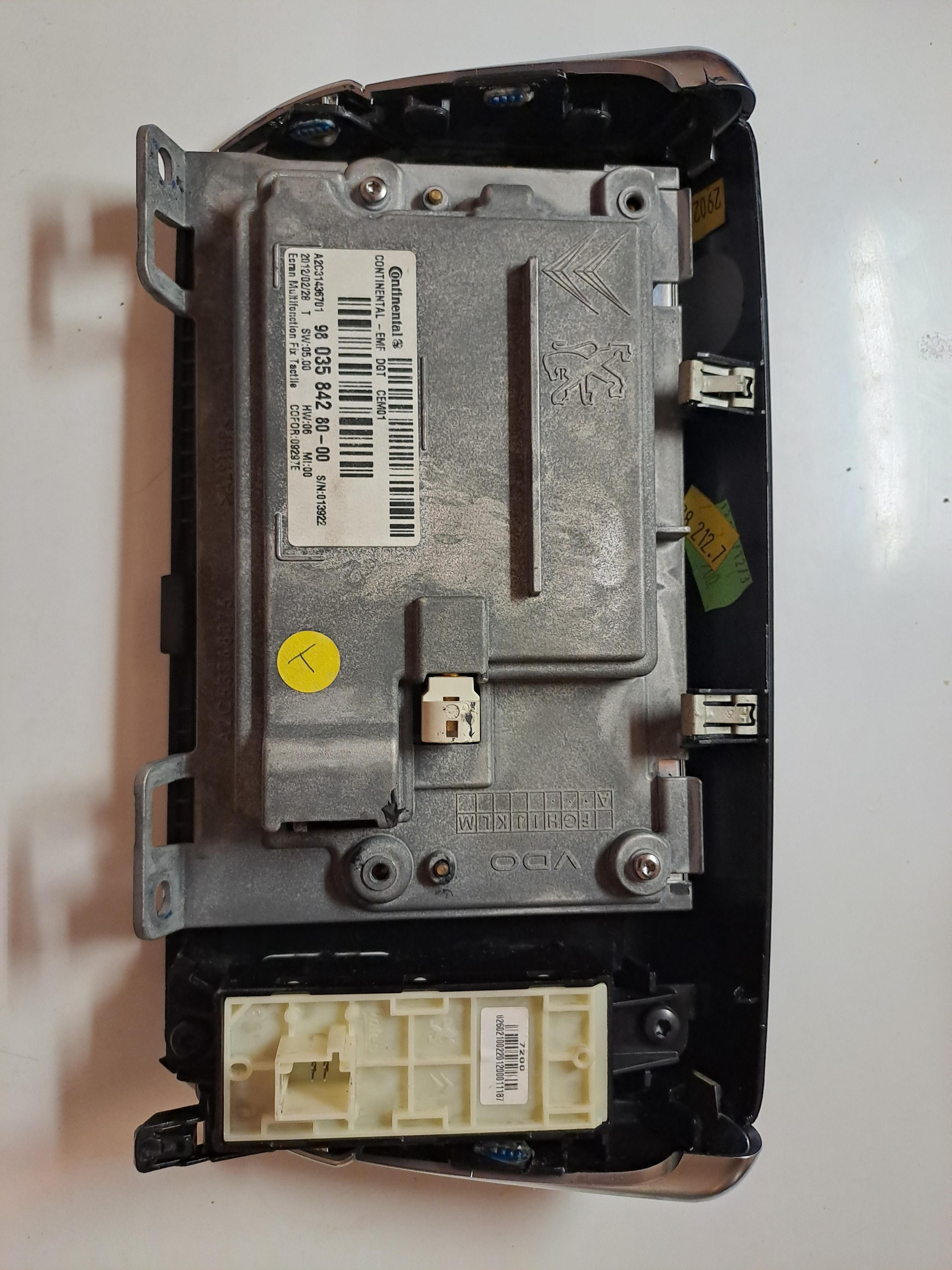

  • #22 21230707
    123Irek
    Posts: 17
    >>21230396 I removed the radio because the professional who changed the VIN said I bought the wrong radio and recommended looking for another. But I can reinstall and see if that will do.
  • #23 21231334
    artur.heise
    Posts: 1637
    Help: 226
    Rate: 614
    Show what you bought as I'm afraid it's not a professional, just a clicker who only knows how to change the VIN and nothing else.
  • #24 21231777
    123Irek
    Posts: 17

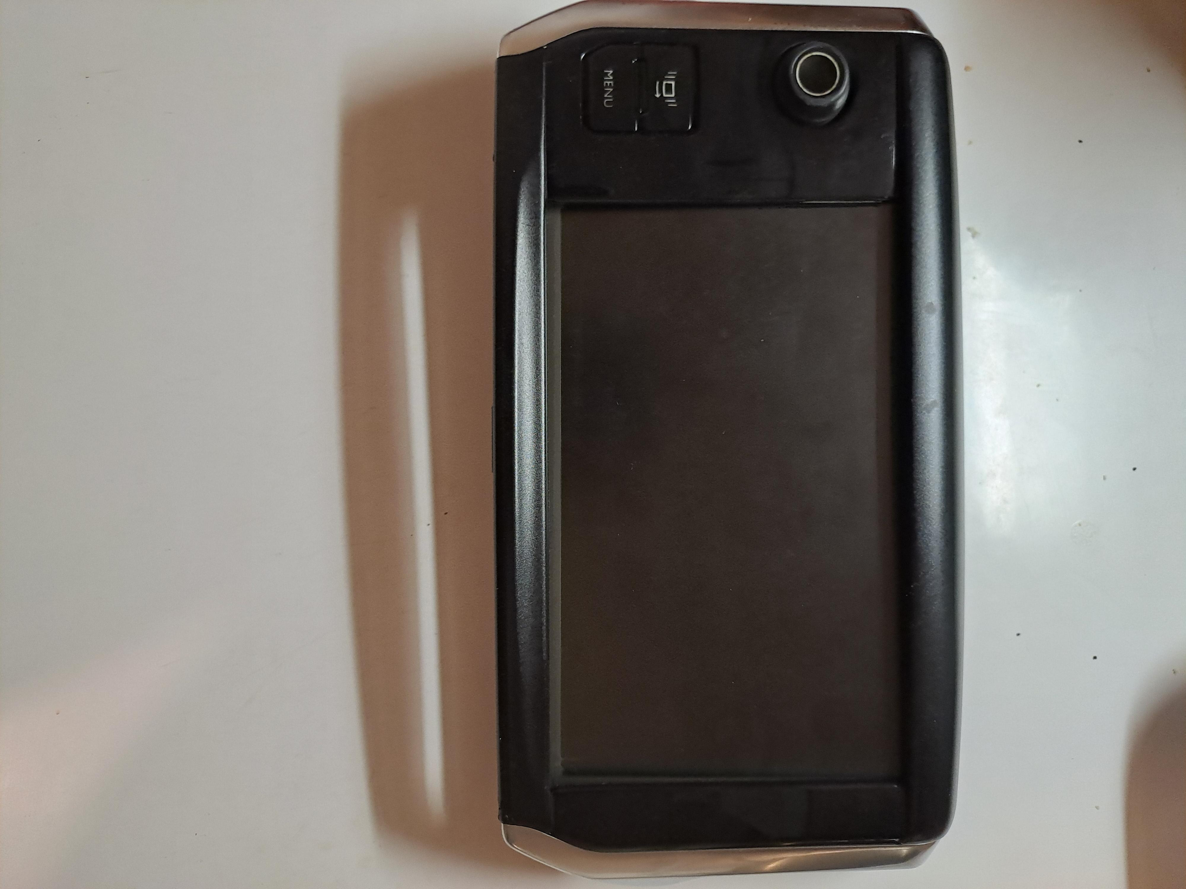

    Such was the factory-fitted
    • Peugeot 208 Original Navigation Installation: Plug & Play or Modifications Needed? 20240913_130837.jpg (1.07 MB) You must be logged in to download this attachment.

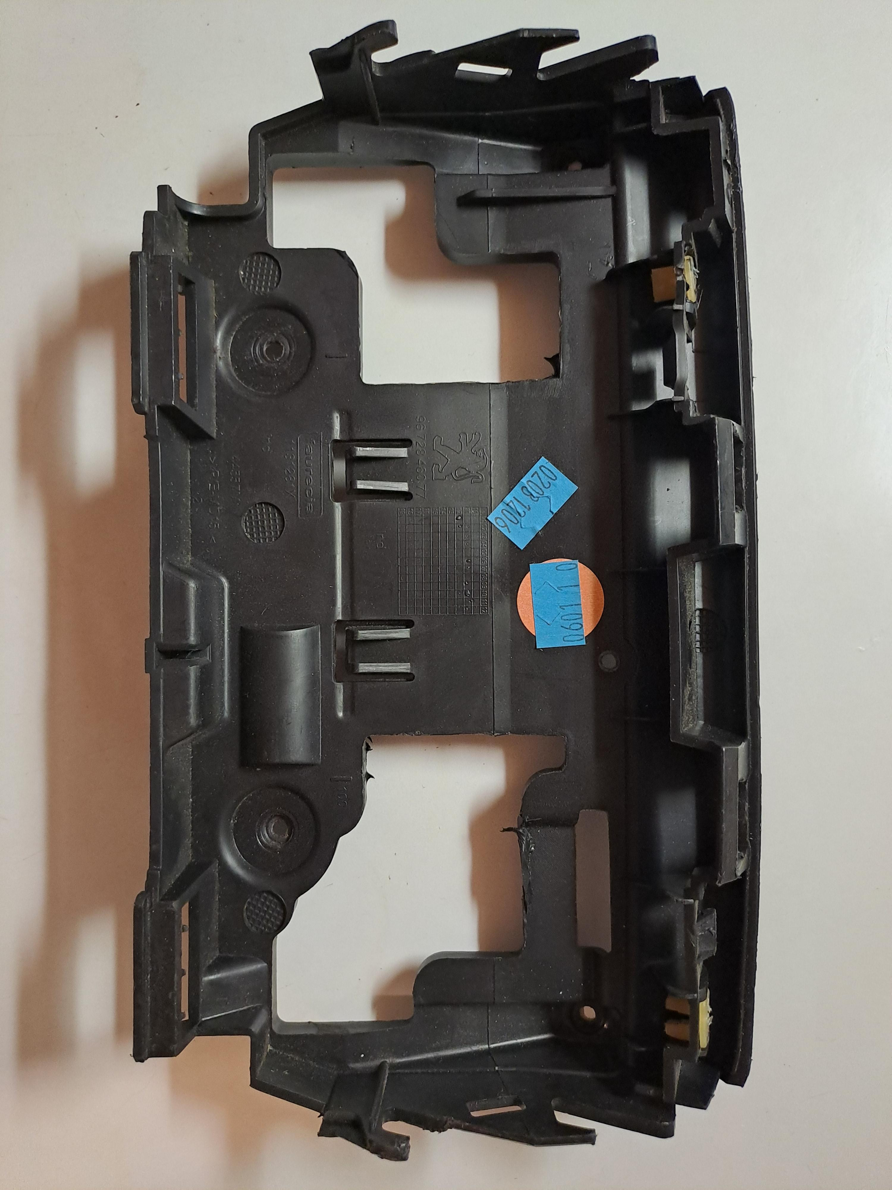

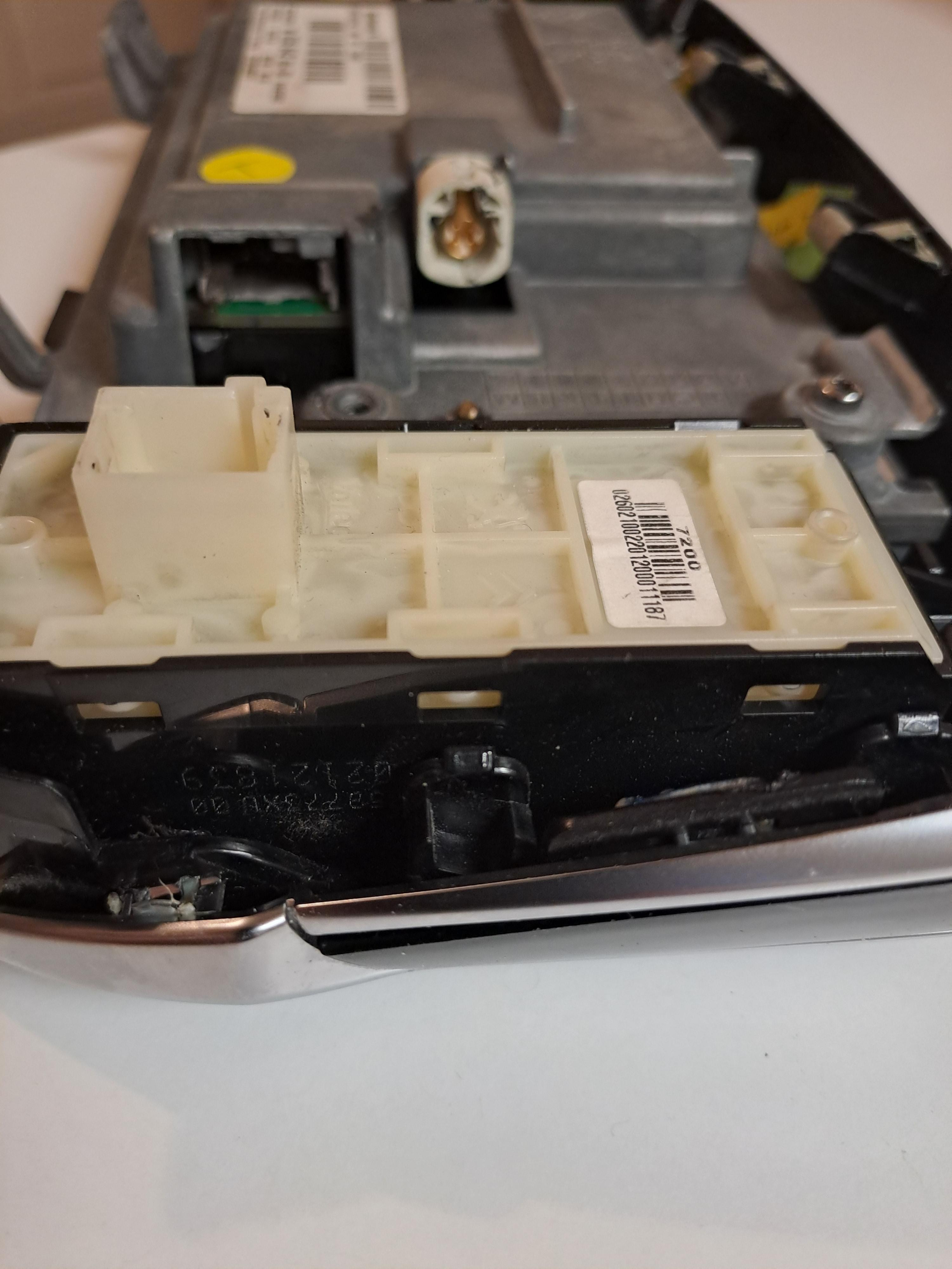

  • #25 21231779

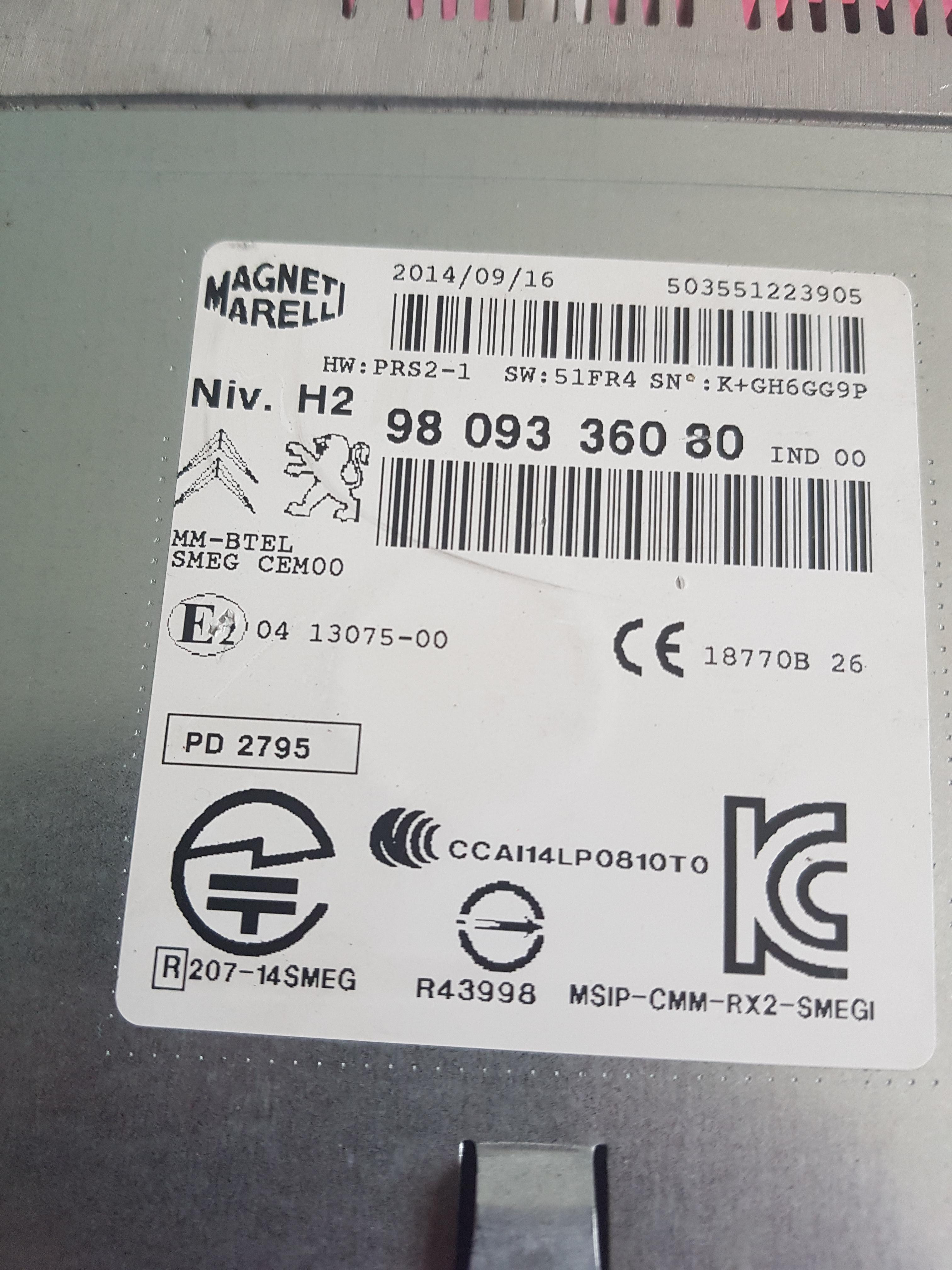

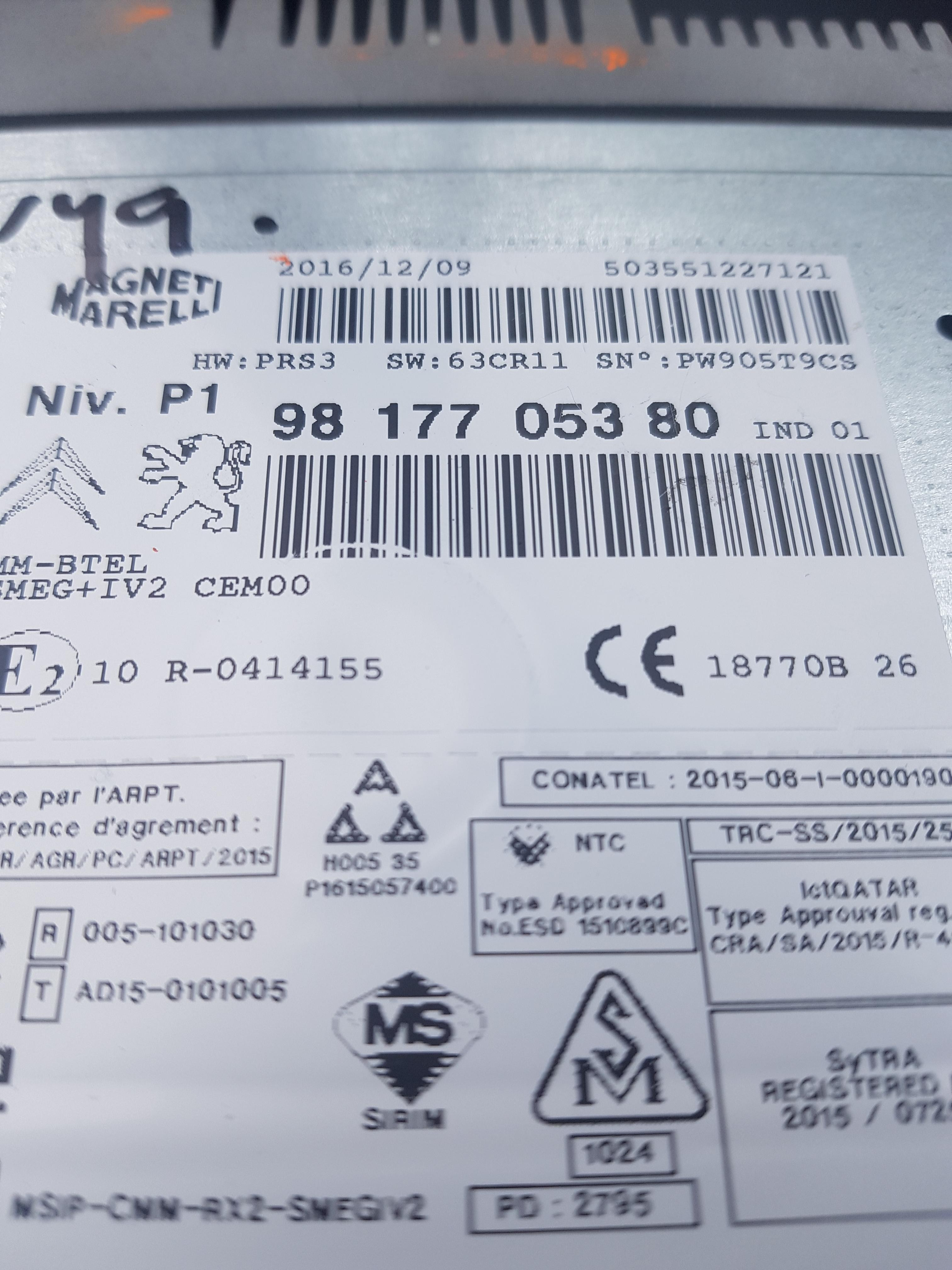

    123Irek
    Posts: 17
    >>21231777 and these are the ones I bought
    • Peugeot 208 Original Navigation Installation: Plug & Play or Modifications Needed? 20240919_102416.jpg (1.29 MB) You must be logged in to download this attachment.

  • #26 21231807
    artur.heise
    Posts: 1637
    Help: 226
    Rate: 614
    >>21231779 .
    So, all in all, you bought an older version- but that still doesn't change the fact that it can be configured, as long as you know which parameters you need to set (and apparently the "expert" doesn't). :)
