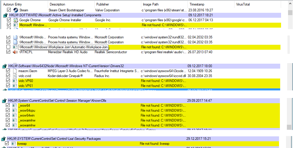

    SleepyOne
    Posts: 10
    I do not search for such an entry in autoruns (I even entered components of this entry in "filter", but found only what in Annex 1)
    > I don't know if this will help, but I made screenshots of all the underlined bars in Autoruns, where it says "file not found" - attachment 2
    • RunDLL Error: Problem Starting C:Program - Module Not Found, How to Fix with FRST? 2.png (50.78 KB) You must be logged in to download this attachment.
    • RunDLL Error: Problem Starting C:Program - Module Not Found, How to Fix with FRST? 1.png (21.58 KB) You must be logged in to download this attachment.

    That's not it, that entry has a C: \ Program path.

    In Autoruns he doesn't search for this post in the filter for me:
    \ Microsoft \ Windows Live \ SOXE \ Extractor Definitions Update Task Windows Live Social Object Extractor Engine Microsoft Corporation c: \ program files (x86) \ windows live \ soxe \ wlsoxe.dll 2014-01-01 05:28
  • #13 16937229
    Kolobos
    IT specialist
    Posts: 85178
    Help: 17171
    Rate: 10456
    It should be in the Tasks tab. But if you do not have it, do not look, it may well be another entry that you can not see here.
    In any case, it should be an entry with a dll file.
