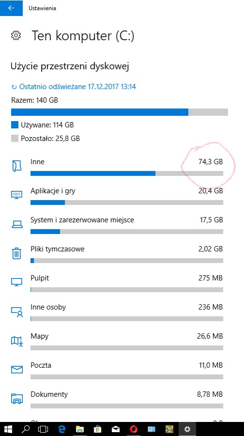

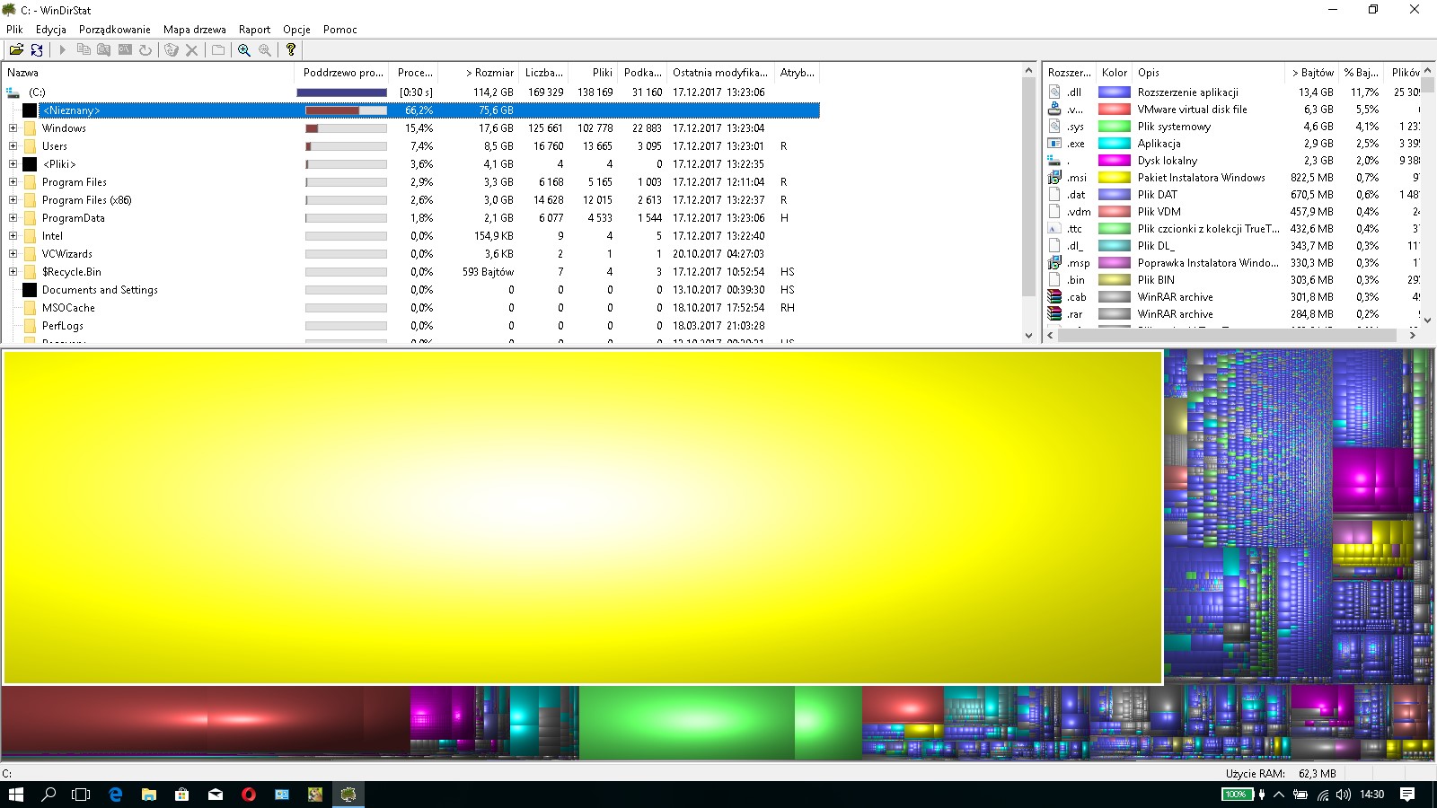

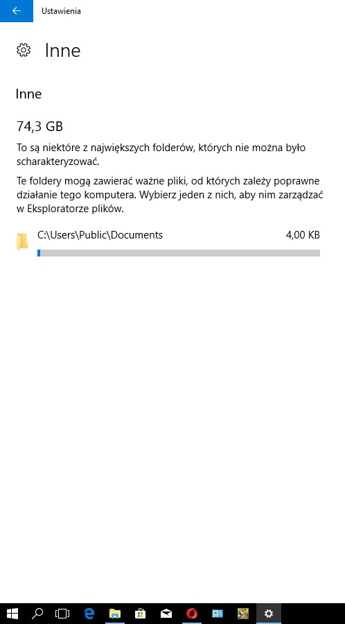

    Hello, In a laptop with a win 10 system and an ssd disk, I noticed a strangely decreasing free space on the system disk. Does anyone know what it is and can it be controlled? The attachments should better understand the topic.

    pagefile.sys should be directly on the C partition: Check how much it takes, including showing hidden and system files. Perhaps this backup takes so long?
  • #3 16896812
    cyk_pct
    Posts: 49
    Rate: 19
    I have enabled showing files (all), not much when searching for pagefile.sys - no results. And the backup is on a separate disk.

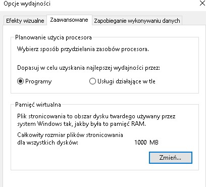

  • #4 16897267
    sylweksylwina
    Posts: 13216
    Help: 1882
    Rate: 2355
    Show paging file settings after clicking "Change ..." from the performance options (screen above).

  • #8 16901357
    cyk_pct
    Posts: 49
    Rate: 19
    Hello, I was away for a while. It was not a Windows file, unfortunately. I remembered that once I made a backup of the system, but I stopped it because it was created on the system disk. I did it again on the spare disk and forgot about it. Windows, however, probably somehow reserved a space on the disk and it was impossible to remove it or look for programs of all types. I installed Win again and it's ok. Lesson for the future. You can close the topic. Thank you all for participating. Best regards.

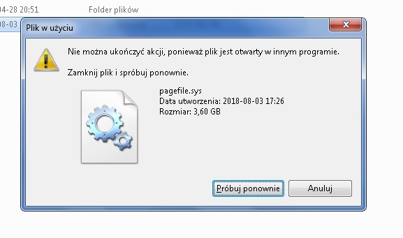

  • #9 17365875
    keseszel
    Level 26  
    Posts: 4103
    Help: 54
    Rate: 558
    I will refresh the cutlet.
    120GB SSD, several partitions.
    Partition D -> 23GB -> Movies.
    Empty partition, one folder containing files -> 1.3GB
    Space used on the partition -> 6GB. WTF?
    After discovering all the babol -> pagefile.sys WTF files?
    Delete-> rather yes, because I need it ...
    Unfortunately-> according to the screen below ..
    Where did it come from? Good fairies have an idea?
    Is this pagefile.sys? Win 10 Laptop, SSD Disk, Decreasing Free Space Issue & Control Methods

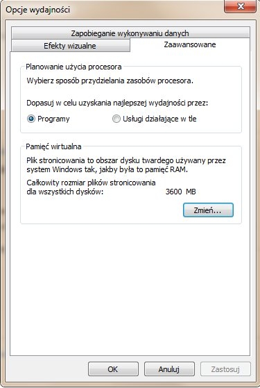

  • #10 17365948
    witoj
    Level 30  
    Posts: 1421
    Help: 110
    Rate: 138
    You have set virtual memory to 3600MB
    Or the system automatically manages this size :)
