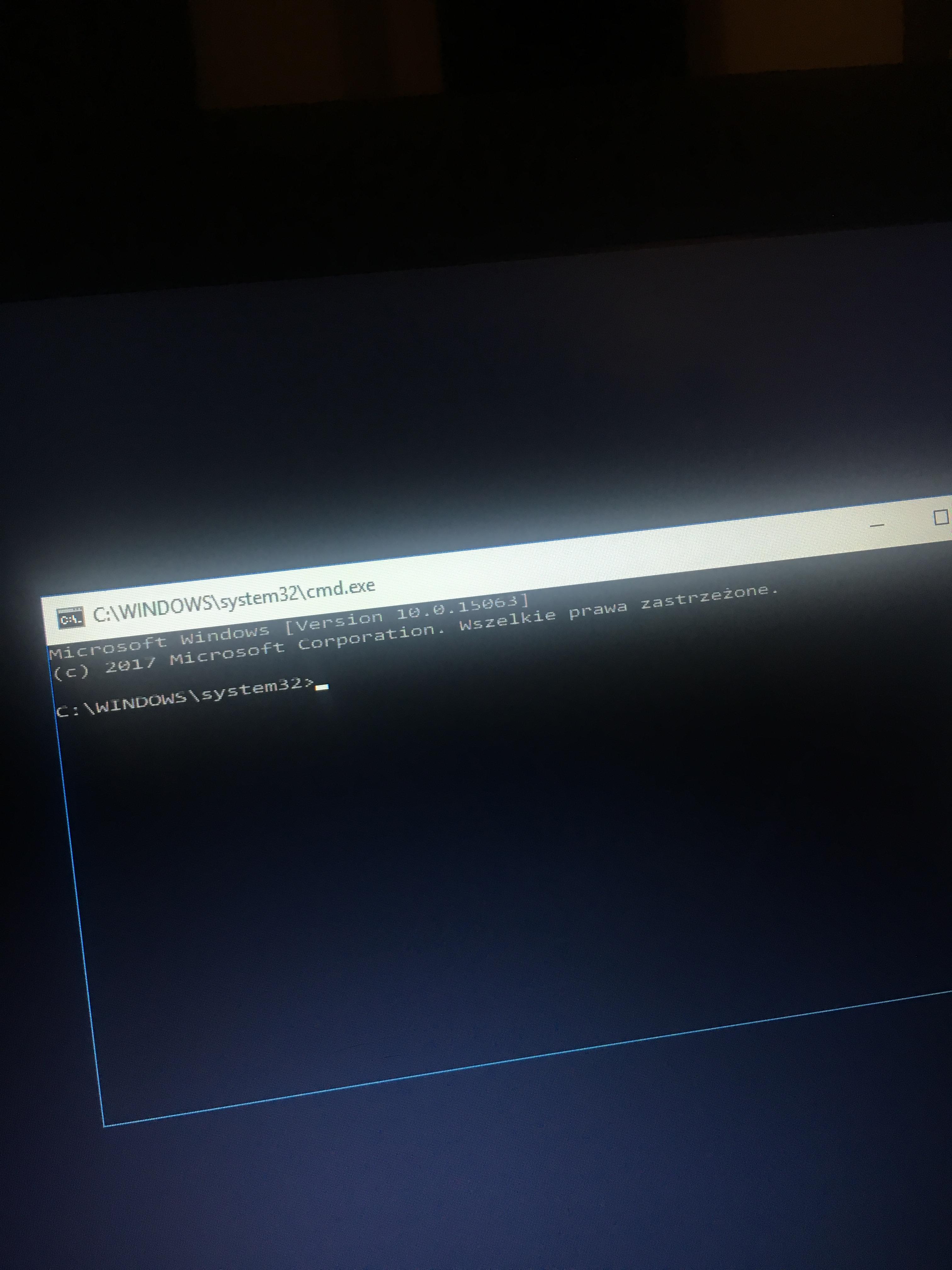

windows 10 - Black desktop screen, window c: \ windows \ system

    It looks like cmd is set as a shell.
    After pressing alt + ctrl + del, the manager switches on? If so, run the new task: explorer.exe
    Then add the logs from the FRST in the attachment, from the scan (Frst.txt and Addition.txt):
    http://www.bleepingcomputer.com/download/farbar-recovery-scan-tool/

    I had to miss a new post in the thread, there were no answers.
    Uninstall Asus WebStorage.
    Next to frst.exe, create a Fixlist.txt file with the contents:
    Task: {0CC370FF-D624-47F0-9E17-69A5E56E8C36} - \ WPD \ SqmUpload_S-1-5-21-3921098667-3587354944-498991832-1004 -> No file No file C: \ WINDOWS \ system32 \ pcalua.exe -a "C: \ Program Files ( x86) \ Common Files \ EAInstaller \ The Sims 4 \ Cleanup.exe "-c uninstall_game -autologging
    Task: {3759EEE2-7185-44D1-AB98-0C4DD9AE9CAD} - System32 \ Tasks \ CreateExplorerShellUnelevatedTask => C: \ WINDOWS \ explorer.exe / NOUACCHECK
    Task: {541128CB-3BFC-4C2C-A7AA-C07A198FCD7A} - \ Microsoft \ Windows \ Setup \ GWXTriggers \ refreshgwxconfig-B -> No file C: \ WINDOWS \ system32 \ pcalua.exe -a "C: \ Users \ Olga \ Desktop \ Age of Empires 2 \ Age of Empires II \ Age of Empires II \ EMPIRES.EXE "-d" C: \ Users \ Olga \ Desktop \ Age of Empires 2 \ Age of Empires II \ Age of Empires II "
    Task: {5F9E0C65-3EF0-4150-A1D2-BE25C6A74969} - \ Microsoft \ Windows \ Setup \ gwx \ refreshgwxconfig -> No file No file No file No file No file No file No file No file No file No file No file C: \ Program Files (x86) \ ASUS \ WebStorage \ 2.1.11.399 \ ASUSWSLoader.exe [63296 2014-08-20] ()
    HKU \ S-1-5-21-3921098667-3587354944-498991832-1004 \ ... \ Run: [GoogleChromeAutoLaunch_2BB54E580DFAD1E560CE0BD70940F48C] => C: \ Program Files (x86) \ Google \ Chrome \ Application \ chrome.exe [1556312 2017 -11-10] (Google Inc.)
    HKU \ S-1-5-21-3921098667-3587354944-498991832-1004 \ ... \ Run: [ALLUpdate] => C: \ Program Files (x86) \ ALLPlayer \ ALLUpdate.exe [3670472 2015-07-28 ] (ALLPlayer Group Ltd.)
    HKU \ S-1-5-21-3921098667-3587354944-498991832-1004 \ ... \ MountPoints2: {f7124897-e2ef-11e5-828d-1cb72c0cc843} - "F: \ setup.exe"
    HKU \ S-1-5-21-3921098667-3587354944-498991832-1004 \ ... \ Winlogon: [Shell] C: \ Windows \ System32 \ cmd.exe [271872 2017-03-18] (Microsoft Corporation)
