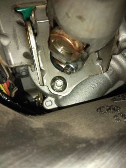

    Hello, toy car Clio II 1.2 75 HP 55 kW petrol. I have a problem with the steering wheel, it turns hard and when turning while driving does not return to its place, does not straighten. I noticed it only when changing to other Clio, the same model, it works like a rocket. The problem was already a year ago, but the steering wheel returned to 45 degrees. This winter, I noticed that the problem got worse, now it doesn't come back at all, I have to straighten it myself, and when it comes back I jump more than smooth movement. Nothing knocks on the steering wheel. What could be the reason?

    A system with or without support? If power-assisted then what electro-hydraulic or electric?

    See if these items are in the car and if there is liquid in the reservoir.

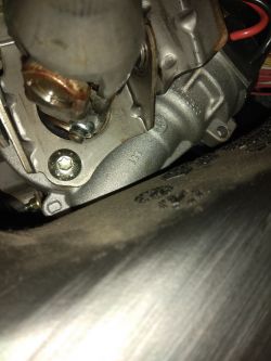

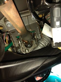

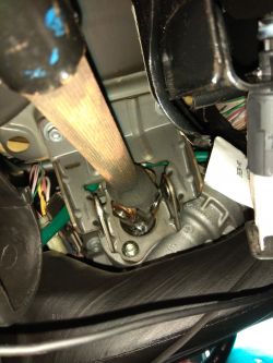

    I took pictures quickly, I had little time I could not remove the bottom case, and probably there would be the most.

    As you can see the electric support. You need to connect the diagnostic computer with the support module to see if there are errors and what.

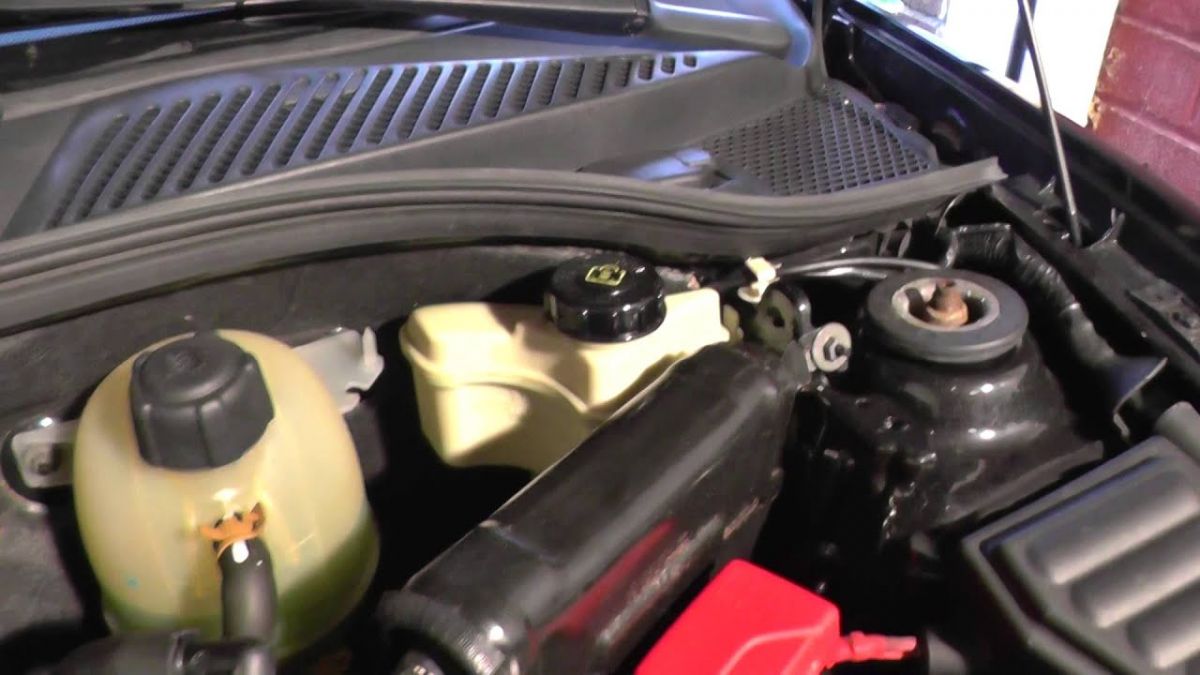

    Hello, did you find this power steering fluid reservoir? I wanted to attach to my Clio and have the same as yours.

    The tank is here
    View of a car engine compartment with visible fluid reservoirs. .

    it should be there, but I don't have it, just like in your picture above

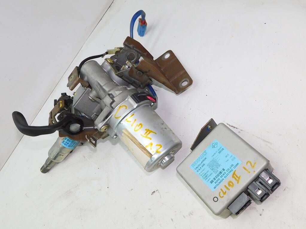

    m2606
    Posts: 2764
    Help: 172
    Rate: 570
    Because you have such a thing in your car contained in the steering column
    Motor with gearbox and sensors from the steering column and electronic control module.
    You don't have a tank , because there is a motor with a gearbox and sensors, not a pump.
