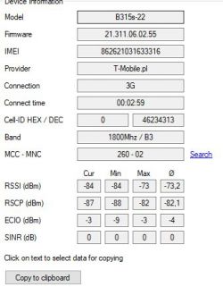

    Hi, I need help with the B315s-22 router. I have LTE internet at T-Mobile. I live in Turku street Radiant. Someone would help me with the router settings to have the best range, etc. (or buying an antenna). Thanks in advance.

    B315 works with http://www.lte-anbieter.info/ltewatch/count_huawei.php?Datei=ltewatch_h or http://www.mediafire.com/file/1yz26m6u8gfl16n/E5186_Toolbox_latest_v0.9.zip In these programs after logging in in them, the B315 can force LTE bands, they also show the LTE and CID BTS signal parameters. What is T-Mobile's offer? The nearest BTS NetWorks is Milewski 10, it operates LTE1800NetWorks and LTE800 T-Mobile and their aggregation. You force LTE1800 and LTE800 in turn, check the speed and signal and CID parameters of the BTS, show screens. The choice of antenna depends on it, B315 does not support LTE band aggregation.

    LTE800 from Milewski overloaded, signal parameters good. On the LTE1800 sufficient signal, average speeds, you can try to improve the signal parameters using the Dual LTE antenna at 1800MHz but it is difficult to predict how it will improve the speed. It is worth checking them under BTS in your direction, for testing an LTE phone with the Network Cell Info application, connects to LTE1800 and check the speed with the correct signal parameters and these will depend on the load of "your" sector. This way you can check what to expect with your antenna.

    Speeds depend not only on the signal parameters but largely on the number of users using a given sector on BTS. There are three on it, you use the third one. Orange with T-Mobile share the LTE1800NetWorks bandwidth, 15MHz in MIMO2x2 and DL up to 112Mbps. Test under BTS on your direction to use the same sector, because LTE1800 has priority over LTE800 but has a smaller range that connects you with this band. Test near BTS - signal parameters will be optimal and speed will depend only on the number of users in the sector. Test at this time because it is an internet peak. In this way you will get data on the maximum speeds to be achieved on LTE1800 in Orange from this BTS. If they are much better than those you have at home, you buy a directional antenna for this band. Of course you have no guarantee that they will last. T-Mobile is now selling an unlimited offer with hardware for little money and the number of users is growing. This is evident in the LTE800, which has a longer range and is already clogging, DL

    I was on Saturday towards BTS on my direction and it turns out that even the 1800 band is clogged and now I don't know what to do about it: c

    See how 3G works on B315, UMTS2100HSPA + DC T-Mobile also works on Milewski's BTS. In Turku, these NetWork BTSs are from you practically in one direction, you could try to connect with those further on Polna 5 and on the chimney of the Adamów power plant.

    So I would have to ride a little evening again like that? Sory, that I didn't write back earlier, but somehow I forgot.
    Added after 1 [hours] 18 [minutes]:
    This is 3G
    Huawei B315s-22 Router Settings: Optimize LTE Internet Range on T-Mobile at Turku Radiant Street Huawei B315s-22 Router Settings: Optimize LTE Internet Range on T-Mobile at Turku Radiant Street
