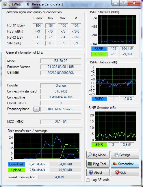

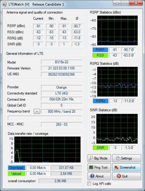

  • LTE 1800 and 800 speedtest results
    #7 17136776
    Gawo1992
    Posts: 14
    Rate: 7

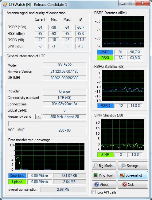

    I forced LTE and the Orange LTE network in the modem settings. What's next ? Do you go automatic?
    matek451 wrote:
    Where does this B315 come from? If with Orange, why not take the MF286 with aggregation of 2 LTE bands. Public IP for free or additionally paid? And why do you need such an IP?
    XBOX One problem. Games weren't running, port forwarding etc didn't help. The consultants insisted that it was not their fault and that they could not help ;)
    They recommended such a modem, maybe my mistake, but the lady in the salon is cool so maybe we can arrange something ;)
    The fee is PLN 7 per month.

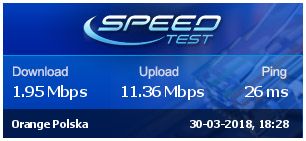

    Added after 4 [minutes]:

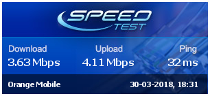

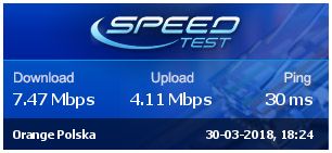

    http://www.speedtest.pl/test/173911071 - LTE 1800
    http://www.speedtest.pl/test/173911393 - LTE 800
    http://www.speedtest.pl/test/173911749 - 3G 800
    http://www.speedtest.pl/test/173912022 - 3G 1800
  • LTE800 overloaded; test B315 outside and prefer LTE1800
    #8 17136854
    matek451
    Posts: 31253
    Help: 4352
    Rate: 5808
    A tragedy on LTE800, despite the correct signal parameters, the BTS you are using is jammed to the max. As you can see, your optimism was overdone. Much better on LTE1800Networks, although the parameters are very weak, but no wonder. Put the B315 out of the window and recheck the signal and speed parameters. The cost of B315 in Orange is 24 installments of PLN 15, or PLN 360, for that much you can easily buy B525, B528 or E5186. Aggregation LTE1800 + 800 with such LTE800 will not change much, BTS is overloaded. Only LTE1800NetWorks gives some hope.
  • LTE800 BTS overloaded; test LTE1800 and move router outside

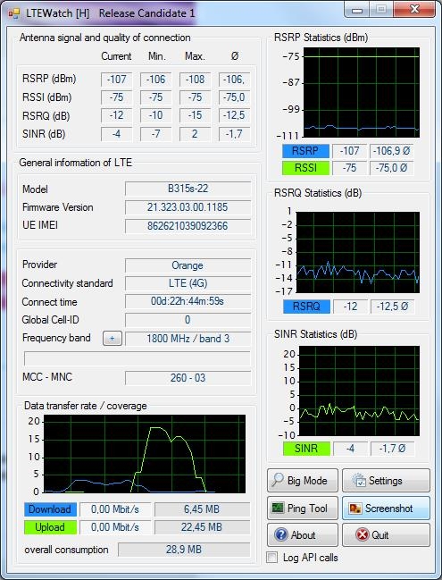

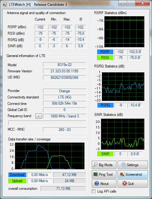

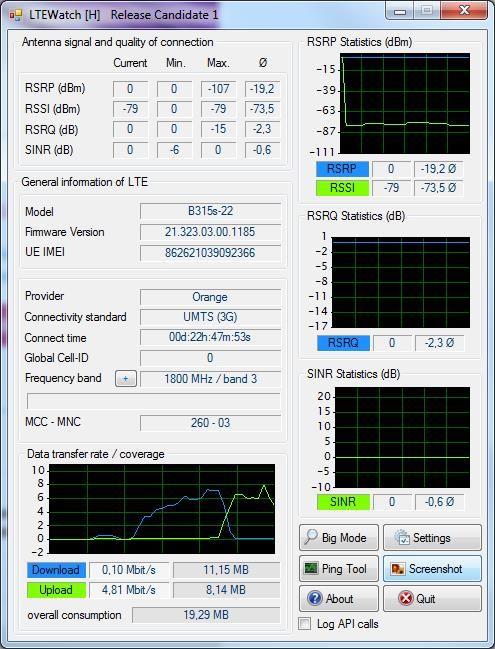

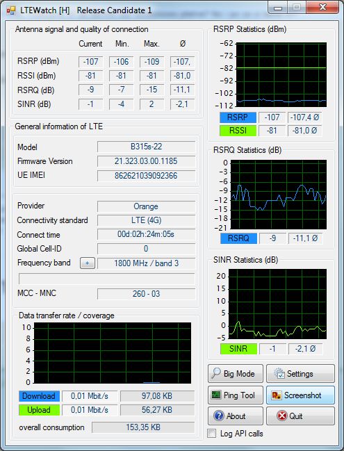

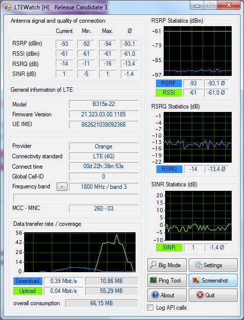

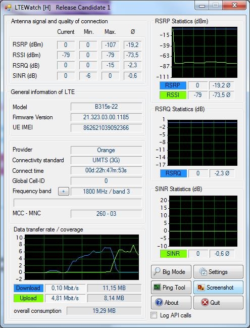

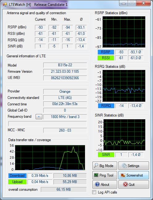

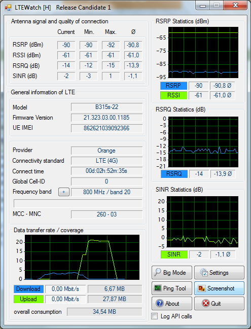

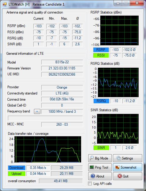

    Okay .. I have the tests behind me. I'm not a specialist, but with the naked eye you can see that this antenna improves from 3 bars to 5 but the speeds are not crazy .. I'm afraid that it owes more to BS than the antenna itself.
    I would like to pass the results to your evaluation

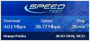

    3G / 1800 external antenna
    LTE Antenna Selection: Huawei B315-22s, Orange Mobilny, Bronowo Kmiece, LTE 800 & 1800 Bands LTE Antenna Selection: Huawei B315-22s, Orange Mobilny, Bronowo Kmiece, LTE 800 & 1800 Bands

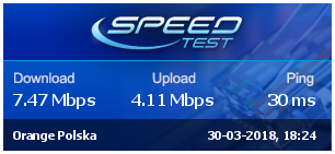

    LTE / 1800 external antenna

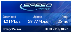

    3G / 1800 built-in antenna

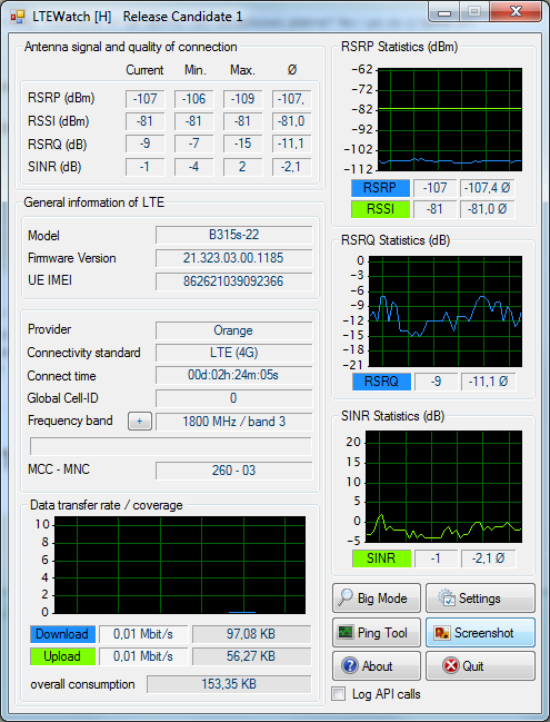

    Built-in antenna LTE / 1800
    So, in general, the purchase made something? Alternatively which antennas are better to use? because the bandwidth is probably only known to be 1800.
    Added after 7 [minutes]:
    Of course, with time I will put the antenna higher, I have to weld the tube up ;)

    There is no 1800 WCDMA band in Poland. It is 900 and 2100 MHz.
    LTE overloaded as evidenced by higher upload compared to download.

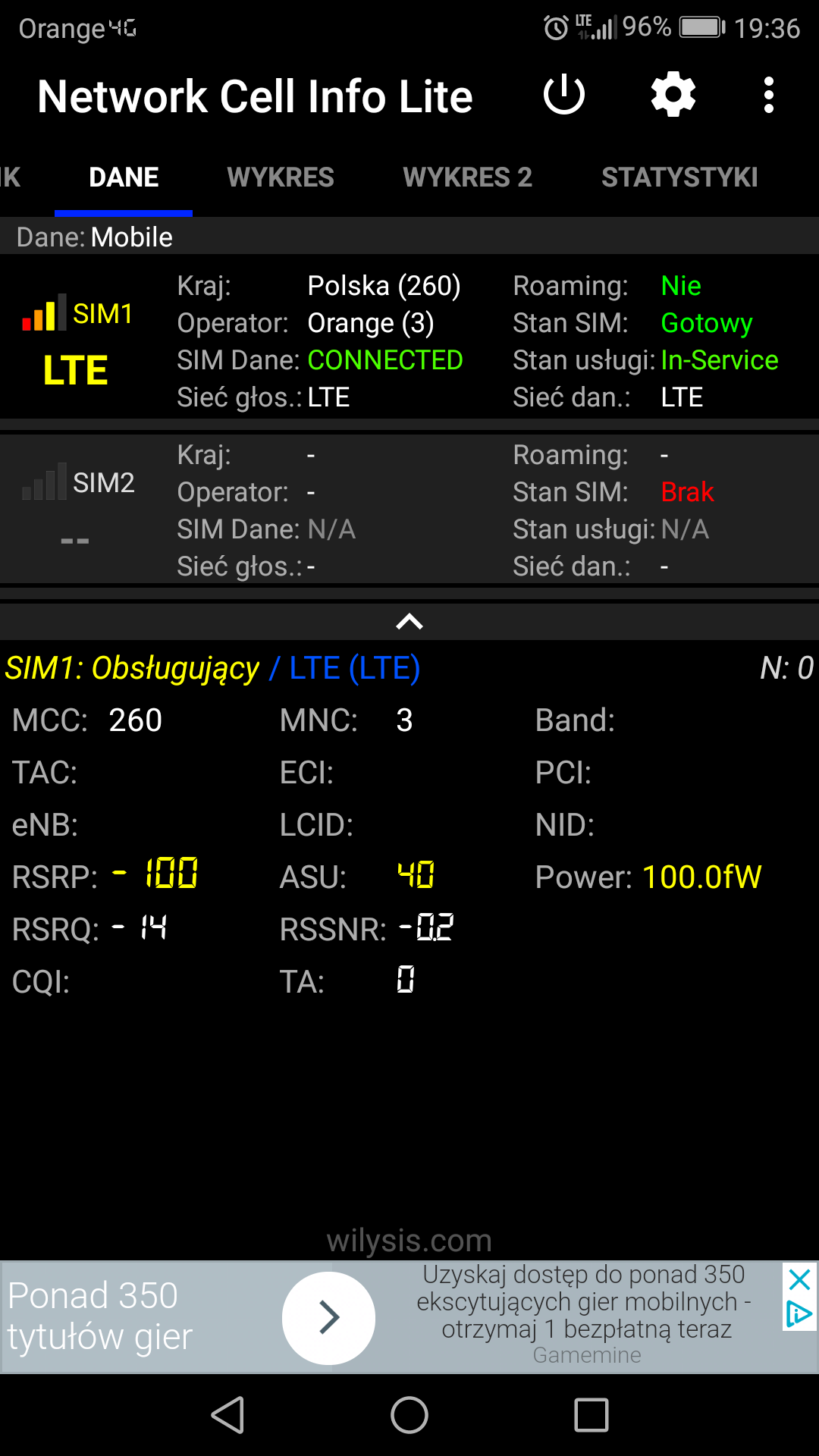

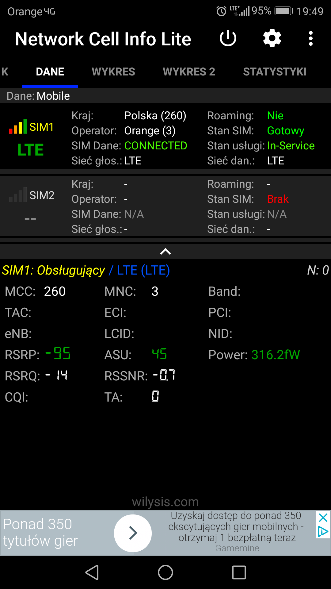

    There is no test on the LTE phone with NCI, so it is still not known which BTS you are using, there is no doubt that the B315 connects to some massacrely clogged LTE1800NetWorks. Antenna set to which BTS? But it won't be fast, often this band is jammed by Orange and T-Mobile customers. For this 3g on UMTS2100HSPA + DC also no madness. this Orange is doing poorly for you. Cybertech does not work at 800MHz, so it will connect you to the LTE1800 or UMTS2100 on the car.
  • #25 17138504
    Gawo1992
    Posts: 14
    Rate: 7
    Okay, what should I download on my smartphone?
    I must connect to the transmitter in Dragań because I have it closest and I can see it from the yard.
  • #26 17138517
    matek451
    Posts: 31253
    Help: 4352
    Rate: 5808

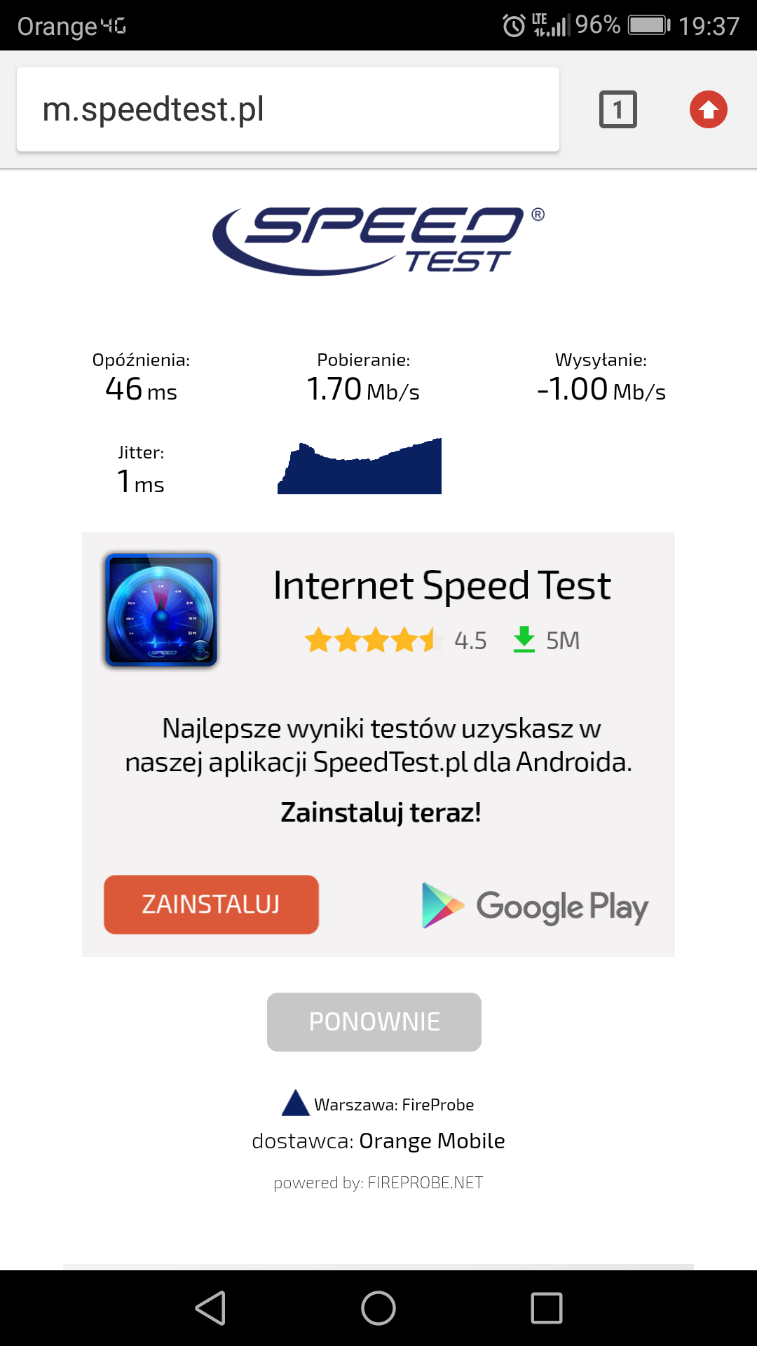

    This must be confirmed with the network Cell Info Lite program for Android phone. The DATA tab shows the eNB, NTS ECI and LTE signal parameters. Test at the router and around the antenna or outside. If it turns out that it is Dragana, you will have to look for another BTS with LTE1800 and even try with LTE2600. Maybe something on Chemików 7 on Orlen.

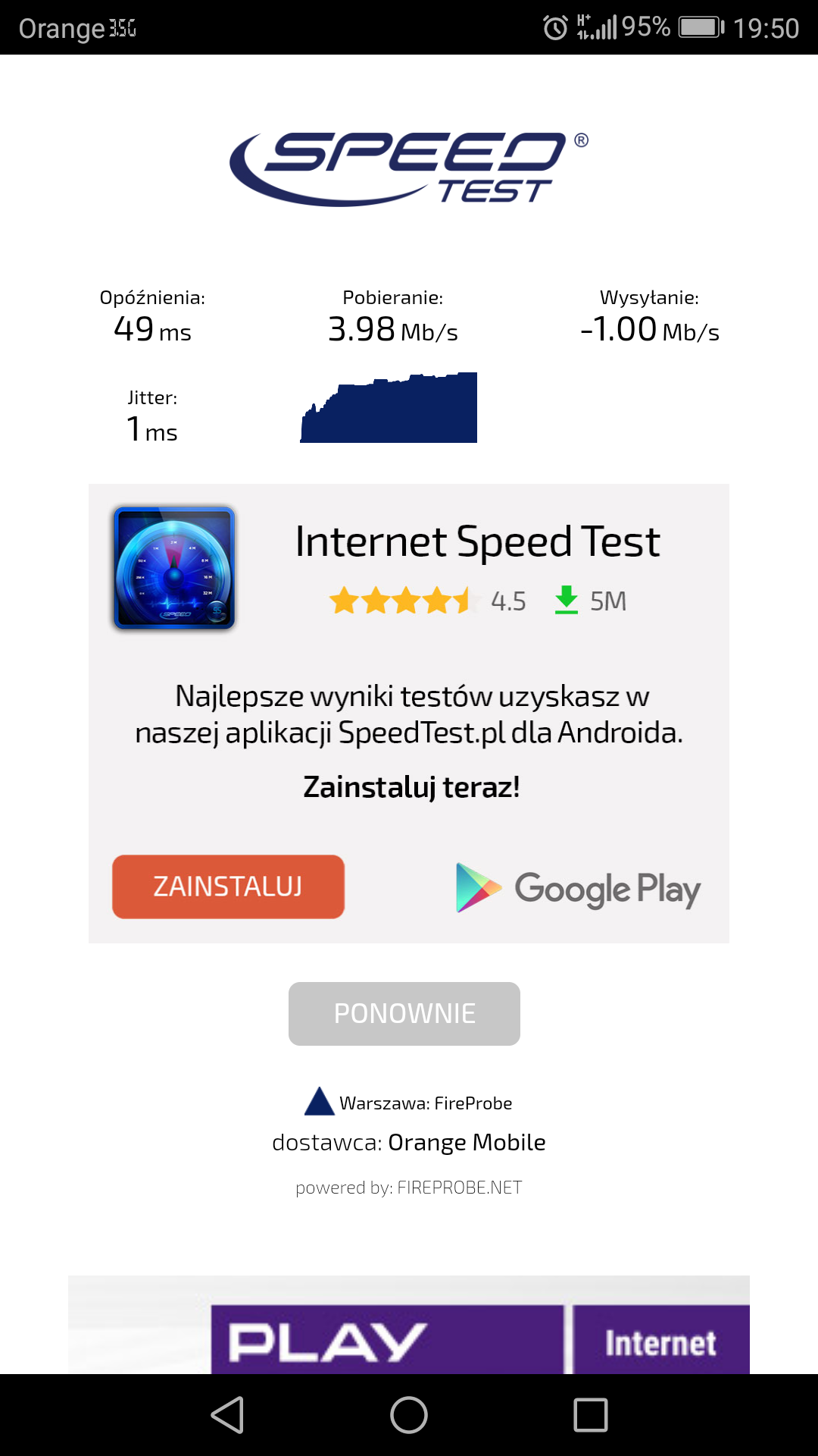

  • #27 17138852
    Gawo1992
    Posts: 14
    Rate: 7
    This is what it looks like from the phone. Well .. the ass does not break it all .. It's a pity for the net from Playa but I couldn't play games there and internal IP.
    So much to cheer up that the Orange runs faster than the 4 mb radio (for me it is max) and sometimes it will buckle 87 mb / s on the console .. Just try the antenna higher and in a different direction?

How do I measure signal and force bands on Huawei B315?
  1. Install LTEWatch H on a PC. 2. Log into the B315 and select ‘Diagnostics’. 3. Use LTEWatch to lock LTE 800 or LTE 1800, then run Speedtest. This reveals RSSI, RSRQ and CID for each band [Elektroda, matek451, post #17136714]
Can I do a quick BTS check with a phone?
Yes. Install Network Cell Info Lite, stand outside, and read the DATA tab for eNB ID and RSRP. Compare IDs with known mast coordinates to confirm alignment [Elektroda, matek451, post #17138517]
