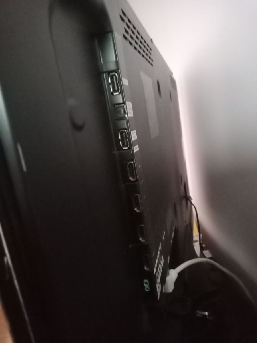

    I am new to the forum, I am sorry if I started the topic incorrectly

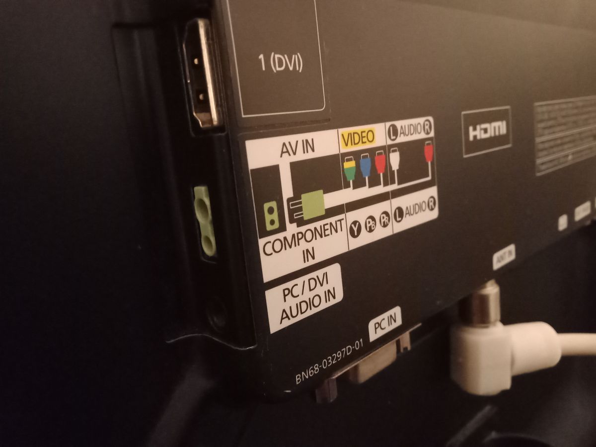

    I have a problem because I would like to connect "Pegasus" to a new Samsung TV
    Model "UE50MU6102K"
    I attach photos asking if I can connect the console by something?
    Greetings . Connecting Pegasus Console to Samsung UE50MU6102K TV: Adapter Options & Troubleshooting Connecting Pegasus Console to Samsung UE50MU6102K TV: Adapter Options & Troubleshooting Connecting Pegasus Console to Samsung UE50MU6102K TV: Adapter Options & Troubleshooting Connecting Pegasus Console to Samsung UE50MU6102K TV: Adapter Options & Troubleshooting
  • #2 16913902
    spinacz
    Level 42  
    Posts: 8576
    Help: 1204
    Rate: 2654
    AV IN connector, Y, R, L inputs.

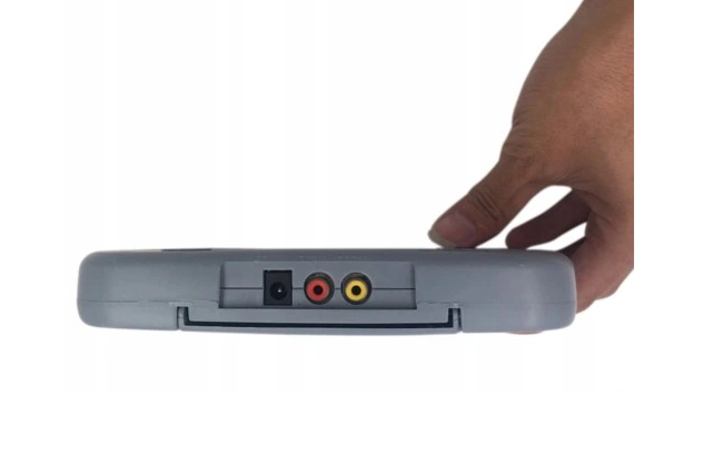

    Well, there are probably no other pegasus exits. Upload another photo of this console outputs.

    As I wrote above, post.

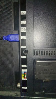

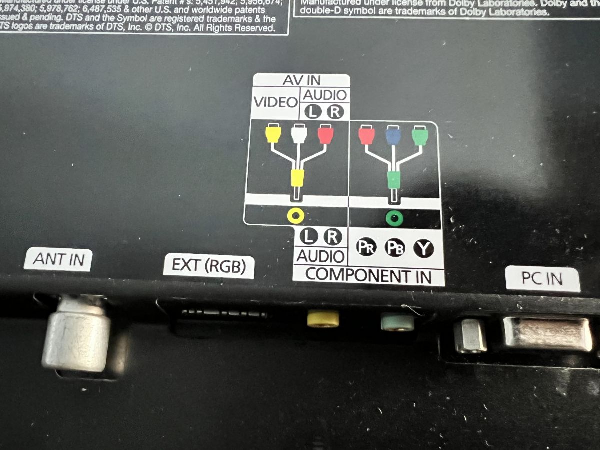

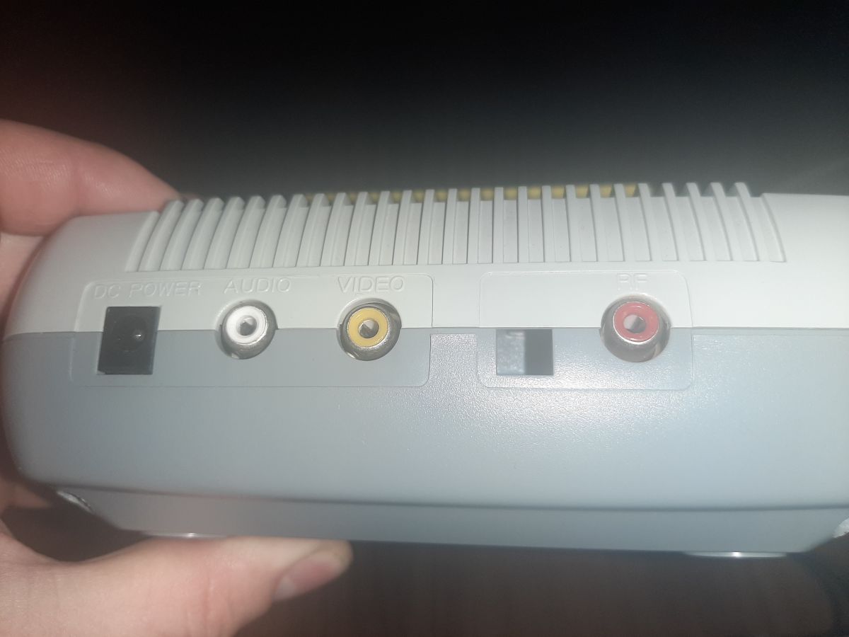

    Gentlemen, I have a similar problem. I wanted to buy the children a game as in the picture.
    I am afraid if I can connect it to the TV. Samsung UE37D5500RW. It is different here.
  • #8 19163552
    sunrise84
    Level 42  
    Posts: 7221
    Help: 979
    Rate: 877
    You attach the same.
    Yellow cable to the socket where you have yellow / green.
    The rest is audio and color.

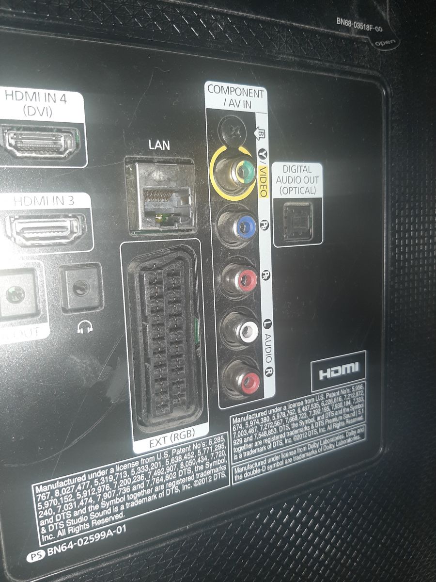

    The question is how? Because there are no classic RCA sockets on the TV. Only what you can see is a green mini Jack socket. Connecting Pegasus Console to Samsung UE50MU6102K TV: Adapter Options & Troubleshooting
  • #10 19163697
    sunrise84
    Level 42  
    Posts: 7221
    Help: 979
    Rate: 877

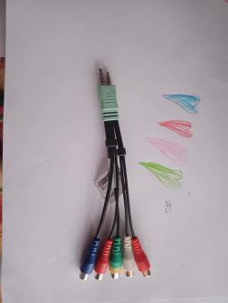

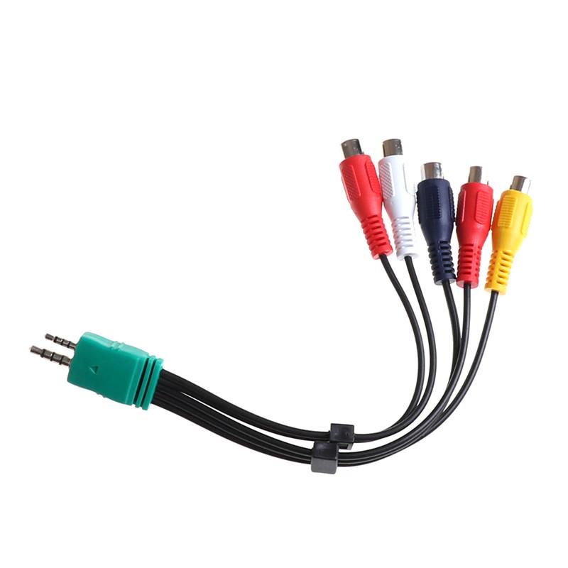

    You have a drawing on the sticker.
    You just need this green double minijack.

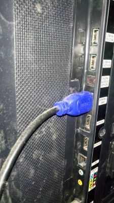

    As for the one in the first photo, there is no way to connect to the game. On which you can see the exit for one mini Jack.
  • #12 19164411
    sunrise84
    Level 42  
    Posts: 7221
    Help: 979
    Rate: 877
    The cable for this "game" has three colors.
    You connect red and white to the adapter where there is a pair of red and white colors, this is the audio signal.
    You plug the yellow one that remains in the cable from this "game" to the yellow one in this adapter.
    Greetings.
  • #13 19165296
    zombek301
    Posts: 190
    Rate: 63
    Thanks, mate. I found such a cable in the attic.

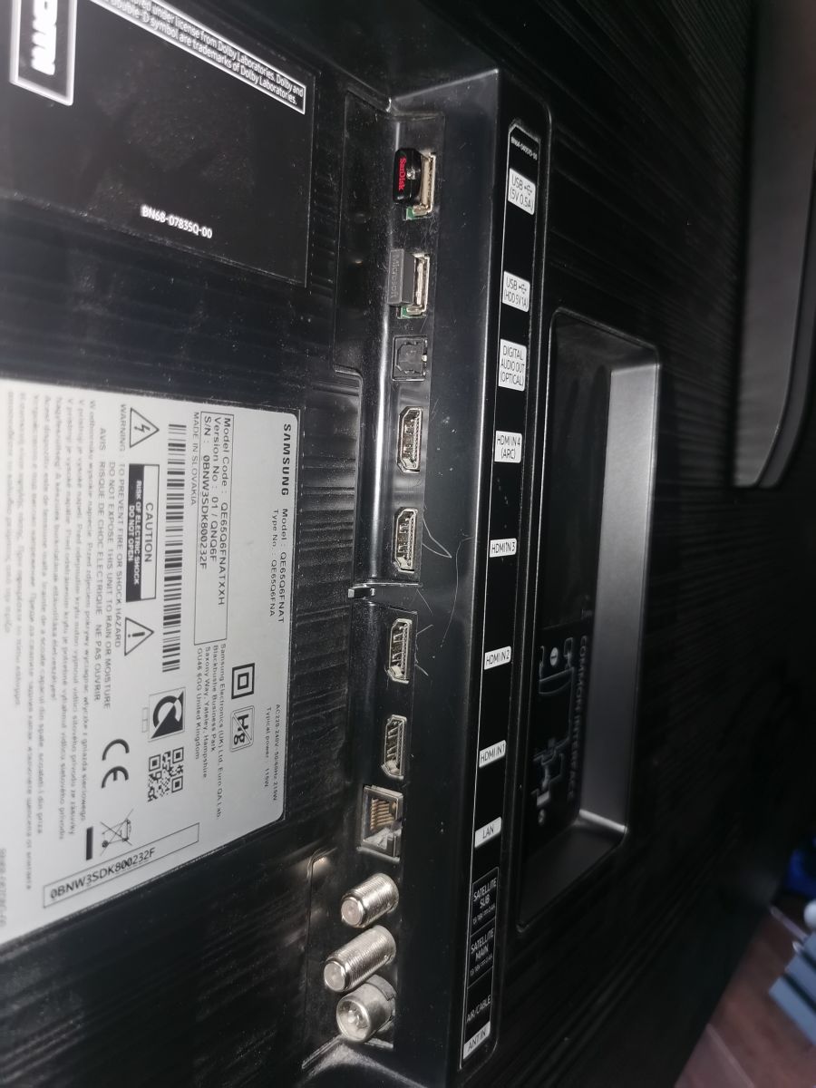

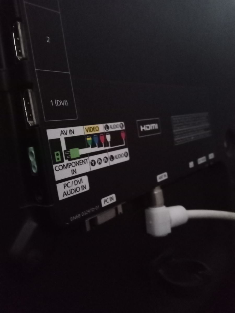

    I would like to attach to the question.
    Except for me it is quite different.

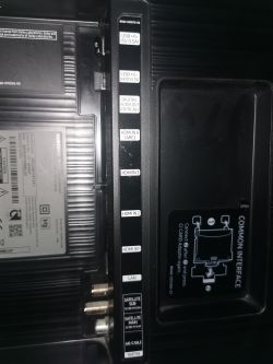

    The TV model is Samsung QE65Q6FNAT

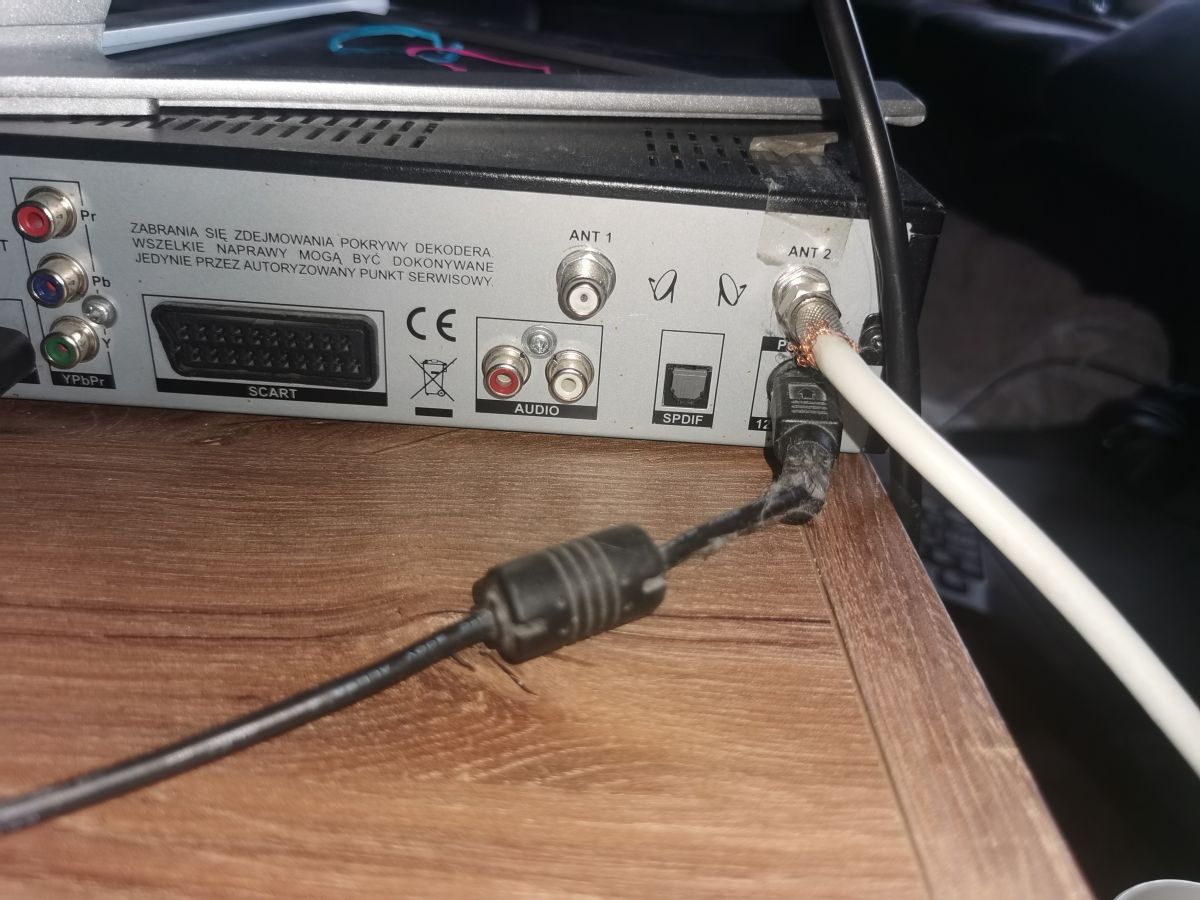

    For clarification, I am sending a picture of TV inputs / outputs:
    And to be honest, I don't see anything here that would allow me to connect the console, or maybe I'm wrong? If I am not mistaken, does anyone know if it is possible to connect the Pegasus not directly to the TV, but through the decoder?
    The decoder has the following inputs:
    two USB inputs
    The console looks like this:
  • Component input required for Pegasus console connection
    #16 19655980
    sunrise84
    Level 42  
    Posts: 7221
    Help: 979
    Rate: 877
    You probably won't connect if you don't have COMPONENT IN on your TV.
    This is stated in the instruction manual for your TV, which you probably did not read thoroughly:
    https://downloadcenter.samsung.com/content/UM...M2DVBEUN-3.0.7_EM_Kant-M2_EU_ENG_201026.0.pdf
    Page 29 of this manual "speaks clearly":
    "Connecting Using a Component Cable (Only for models with COMPONENT IN /
    AV input)
    Component connection allows you to enjoy video resolutions up to 1080p. To watch video from most DVDs and Blu-ray Discs
    players, use the Component connection.
    See the picture below, then connect Component IN and AV IN on your TV to Component OUT on
    external device with the supplied component and AV adapters. Make sure you combine the same color
    connectors together. (blue to blue, yellow to yellow etc.) "
    The decoder only has picture and audio OUTPUT.
