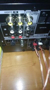

    As the topic. I have a problem with connecting the old console to the new tv. I even tried the optical home cinema cable, but there is only sound, no picture. I am asking for help because I tried all the ways and nothing!
    Picture of Samsung UE32K5600 tv connector
    Connecting PS2 Console to Samsung UE32K5600 TV: Issues with Optical Home Cinema Cable
    Picture of the home cinema denon avr-x520bt connector

    In the home cinema you have IN sockets, connect in accordance with the colors, set the appropriate input and should roll. You will only have sound on the optical cable.

    If the home theater works properly with the TV, after connecting the PS2 to the home cinema to the VIDEO IN and AUDIO IN L / P sockets, the PS2 signal should appear.

    Works fine, but unfortunately when you connect the console is only sound. There is no image at all ... Do you know exactly how to set parameters?

    The audio system does not process / convert the signal, i.e. connecting the equipment under av you will only receive a signal on av out. The cheapest option is to buy a component cable for ps2.
    I've read that your tv has av:
    Composite input (AV) 1 (in use as a component Y)
