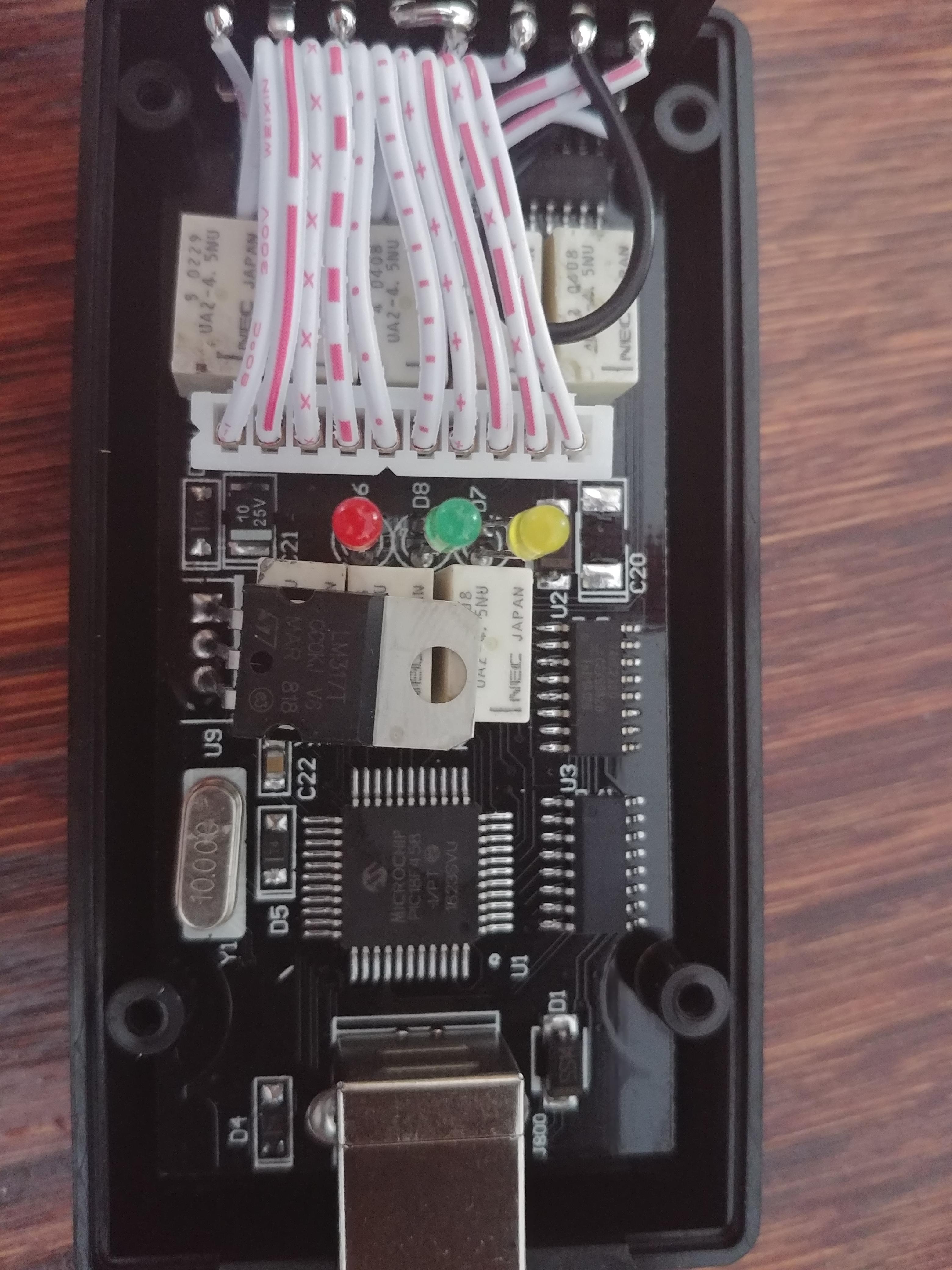

    On what exactly program are you trying to launch this interface?
    Give a picture of the other side of the tile because it looks like it's V5.
  • #5 17479213
    Lidiawestphal
    Posts: 12
    Rate: 20
    Hello, this is actually a v5.a program did not run at the moment any plugs. I connected to a laptop with windows 10. I installed the op com program but I do not want to go further without a usb driver so that the device co-exists with the laptop

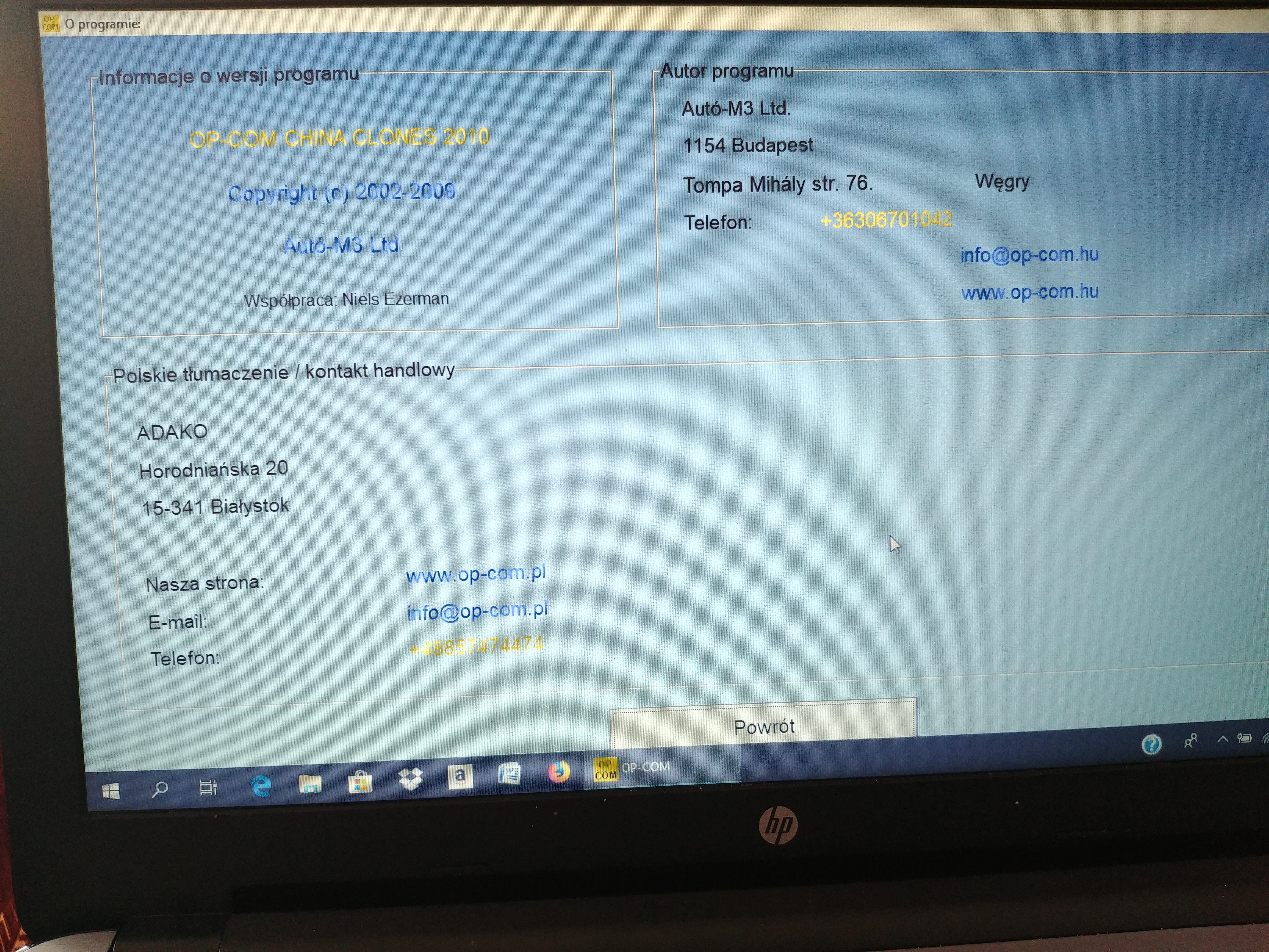

  • #8 17479414
    bubu1769
    Posts: 8063
    Help: 1177
    Rate: 2374
    Yes, give screen from the "About" and "Settings" tab.
  • #9 17479420
    Lidiawestphal
    Posts: 12
    Rate: 20

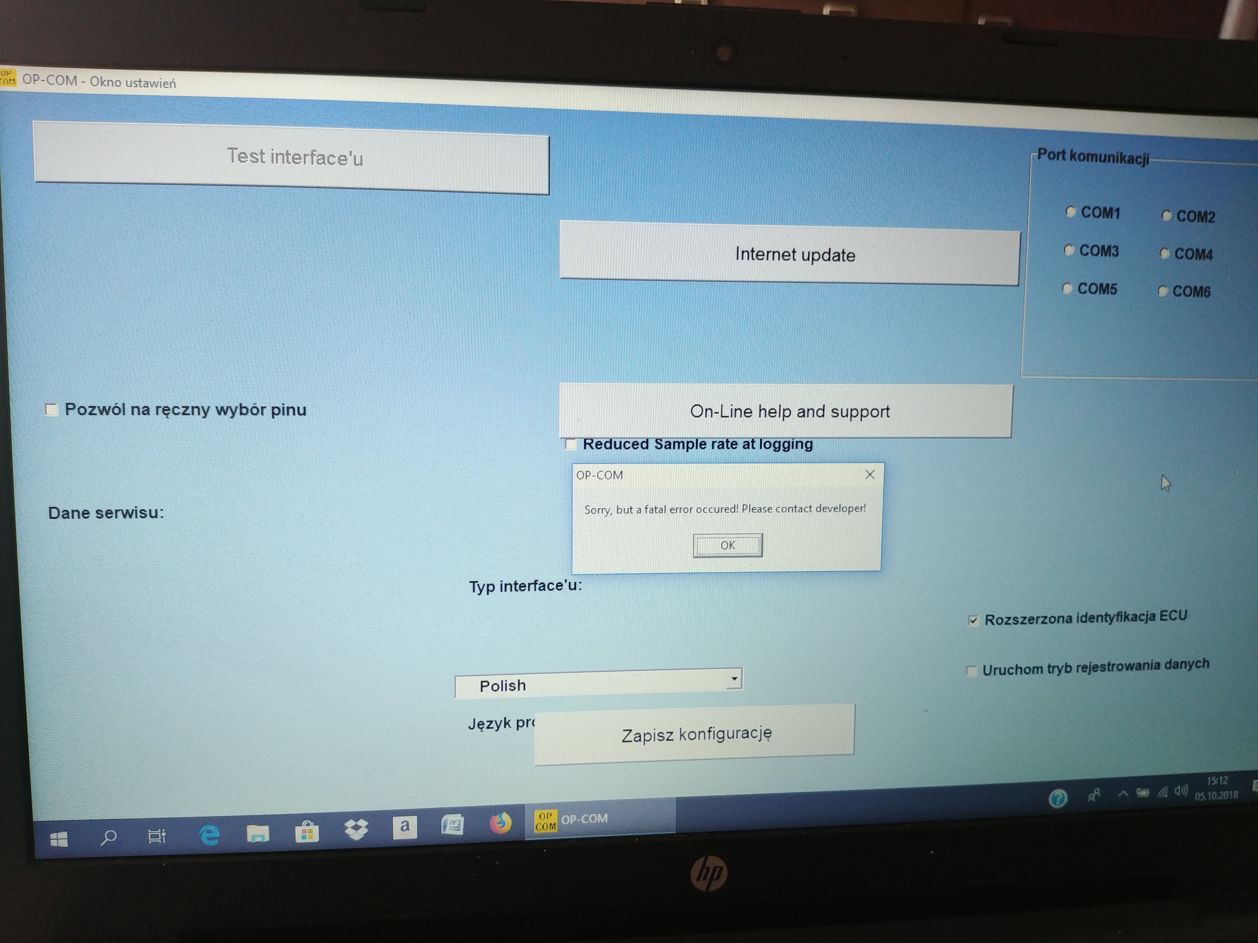

    The system read the device well after connecting it to another socket in the laptop, but a critical error popped out.

    Hello, I downloaded the program and unpacked
    Added after 3 [hours] 54 [minutes]:
    Hello op com dziala.Wada turned out to be just a USB cable to the laptop. For the second third connection with the LEFT side of the laptop worked only properly. For the Lord for all the unnecessary and even more information.

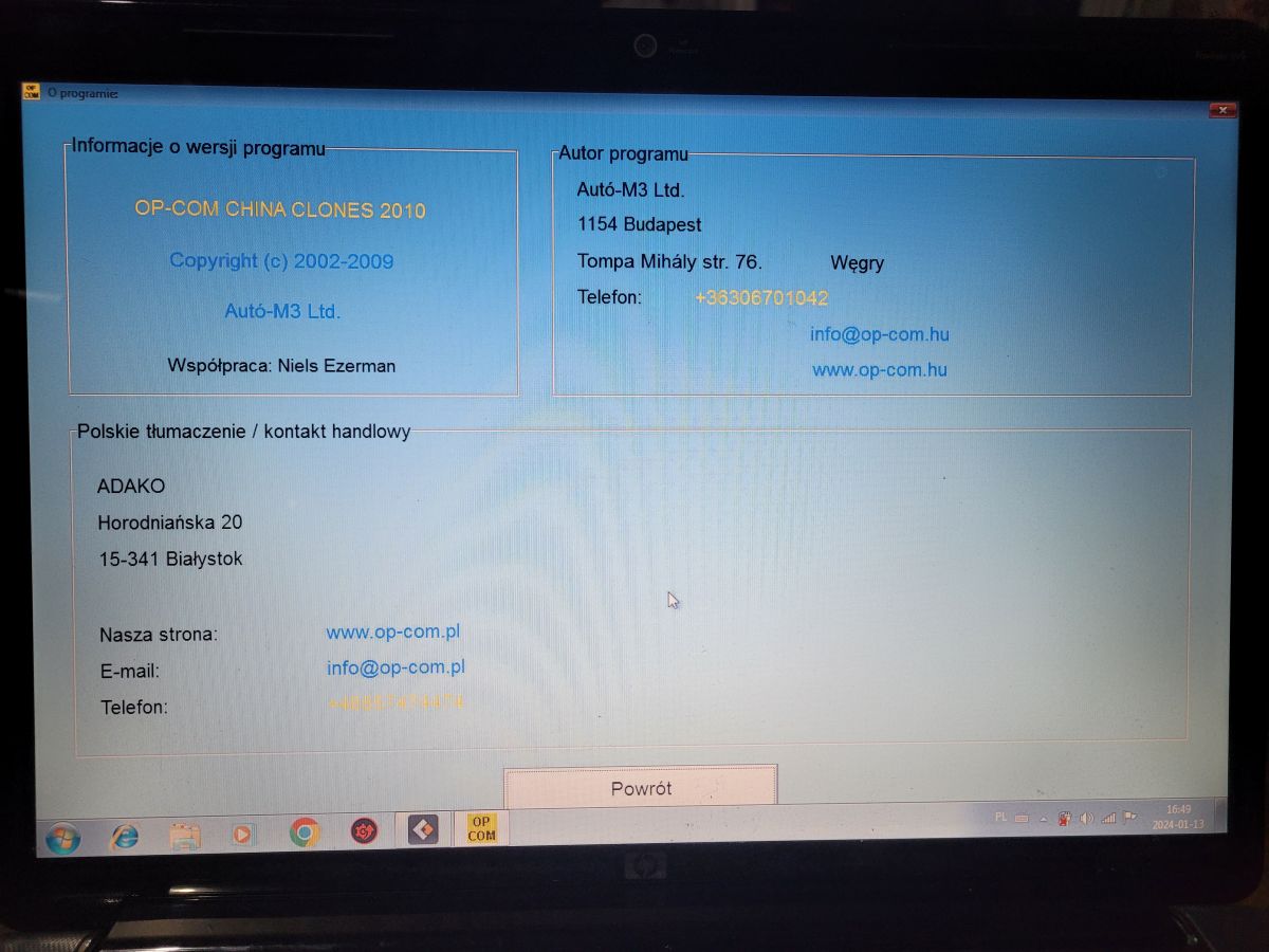

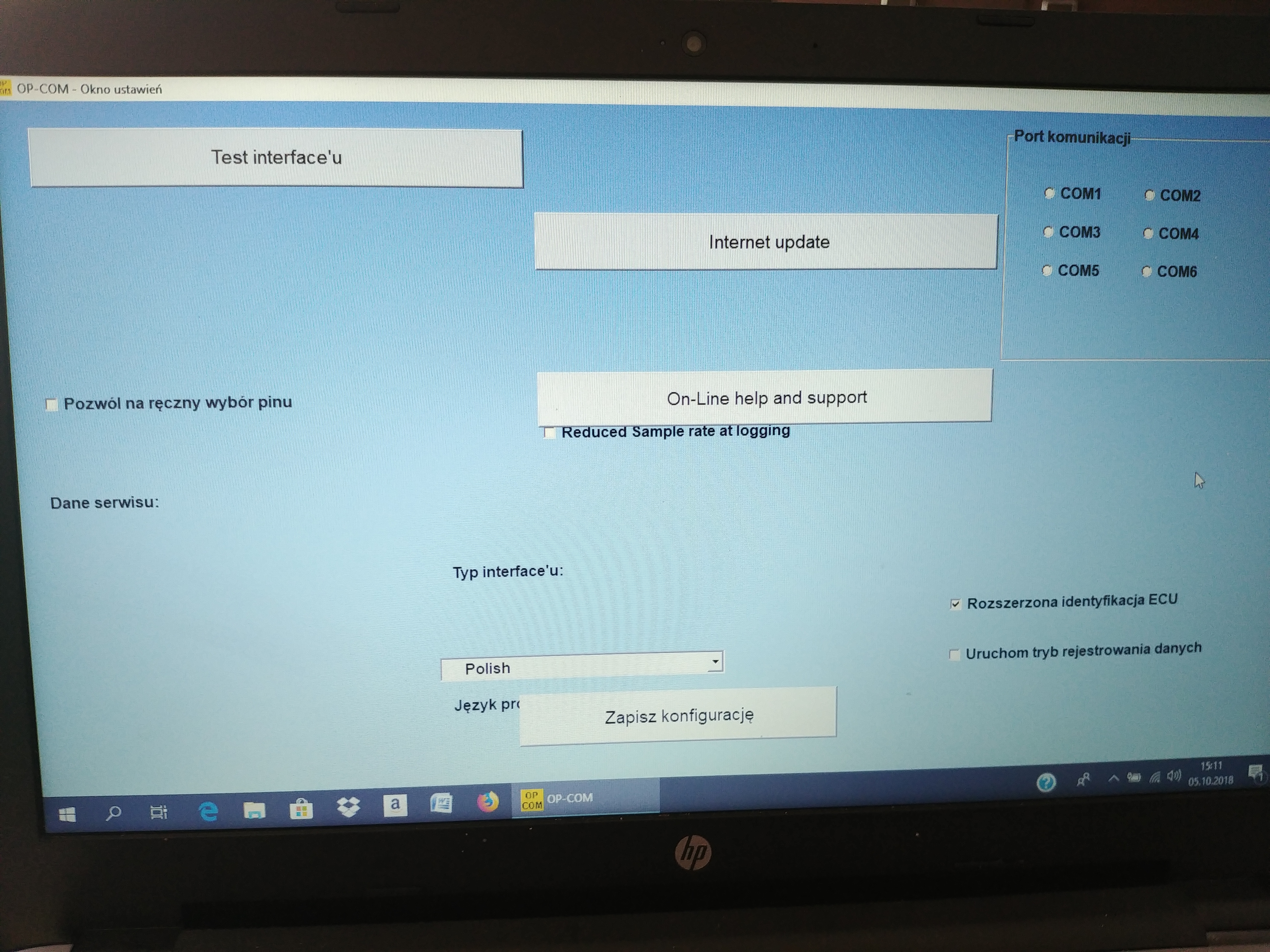

    Sorry for digging up the topic, but I have a problem. Namely, my laptop with OP-COM CHINA software died. Below I add pictures of the main menu of this program, the "Settings" section, and the "About" section. Could someone please help with the installation and drivers of this program? I need to hook up my computer but have no way to do so due to a broken laptop. If someone can, please help me a lot.
    Main menu screen of OP-COM CHINA-CLONE 08/2010 program with options Diagnostic, Settings, About, Exit.
    Computer screen displaying information about the OP-COM CHINA CLONES 2010 software.
    Screenshot of OP-COM software with settings menu.
  • #17 20907513
    bubu1769
    Posts: 8063
    Help: 1177
    Rate: 2374
    Look for OP-COM or WAUX-COM 120309a, full of it to download from various sources.
    Just remember that you need to fire it up as Admin.
