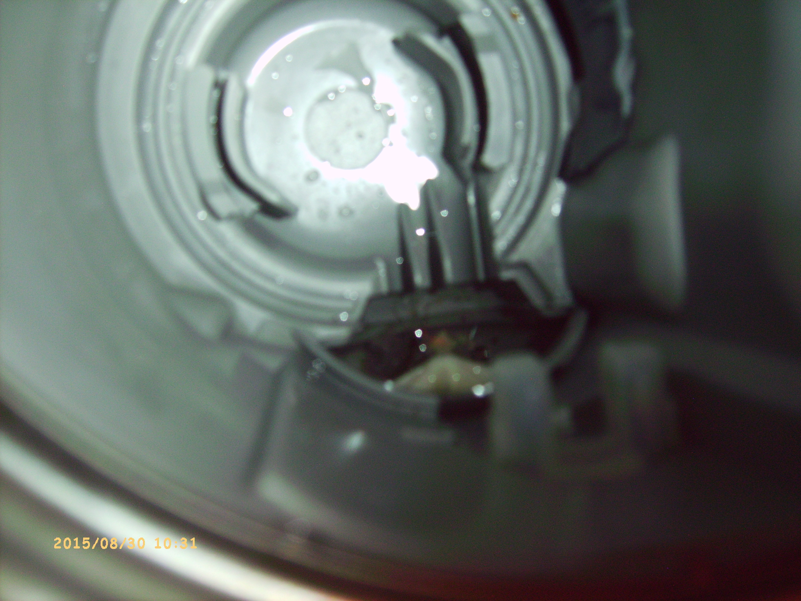

  • #5 16923568
    darek1961
    Posts: 6
    Hello, I am sending a photo of a plastic bowl

  • #6 16924080
    h jaworski
    Home appliances specialist
    Posts: 4786
    Help: 466
    Rate: 717
    It would be useful to get a better lighting of the pit because nothing is visible at the bottom. See also whether there is no torx 20 slet at the bottom unless it is not possible to see whether the door can be removed by the service panel, such a metal float facilitates access from the bottom to the dishwasher.

    #8 16925340
    cezet
    Posts: 7549
    Help: 719
    Rate: 1407
    In the middle of the bowl, on the right side is a plastic (white) plug. Using a screwdriver, unhook the catch and access to the pump impeller.
  • #9 16927887
    darek1961
    Posts: 6
    At the beginning I wish you a happy New Year. I got to the rotor clean, it turns slightly, and how to remove this pump ...

  • #10 16928003
    h jaworski
    Posts: 4786
    Help: 466
    Rate: 717
    It is good to see if there is, for example, a piece of transparent glass because in the remnants of water it can be invisible.
