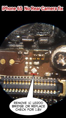

    Hello, I got to do 6s after flooding with the torn camera slot and the lack of several elements around the socket. After filling the gaps under the microscope, the back camera has a black background and the flashlight does not work ... i.e. When turning on the flashlight, the icon turns gray, ie it turns on but does not shine. The front camera is working properly.
    I changed the camera - no result.

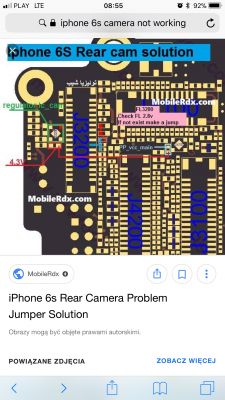

    I found some walkthroughs on the internet:
    I've bridged the U3200 like a photo.
    I checked all the passages around the socket like on a photo.
    On FL3200 I have 4.1va should be probably 2.8v?

    How did you make the bridge on the U3200, why are you expecting an 2.8V voltage on the FL3200? U3200 is the LDO of the rear camera, you made a bridge between the input and the output of this circuit, so you have there VCC_MAIN or voltage from the main power branch. You must think and not follow the walkthroughs blindly, the paws fall: /

    The fact that you do it in a hobby does not absolve you from thinking, following the walkthroughs from the internet, you can beat the phone.
    Inserting the U3200 chip will probably restore the voltage of 2.85V but I do not know if the camera survived as you gave it 4.1V ;)
    For the future, all the elements on the disc are needed and have been placed on it for some purpose, wiring any one is usually a bad idea. The wire can be used to repair interrupted connections between elements.

    The bridge can only be made for diagnosis, it is not a repair!
