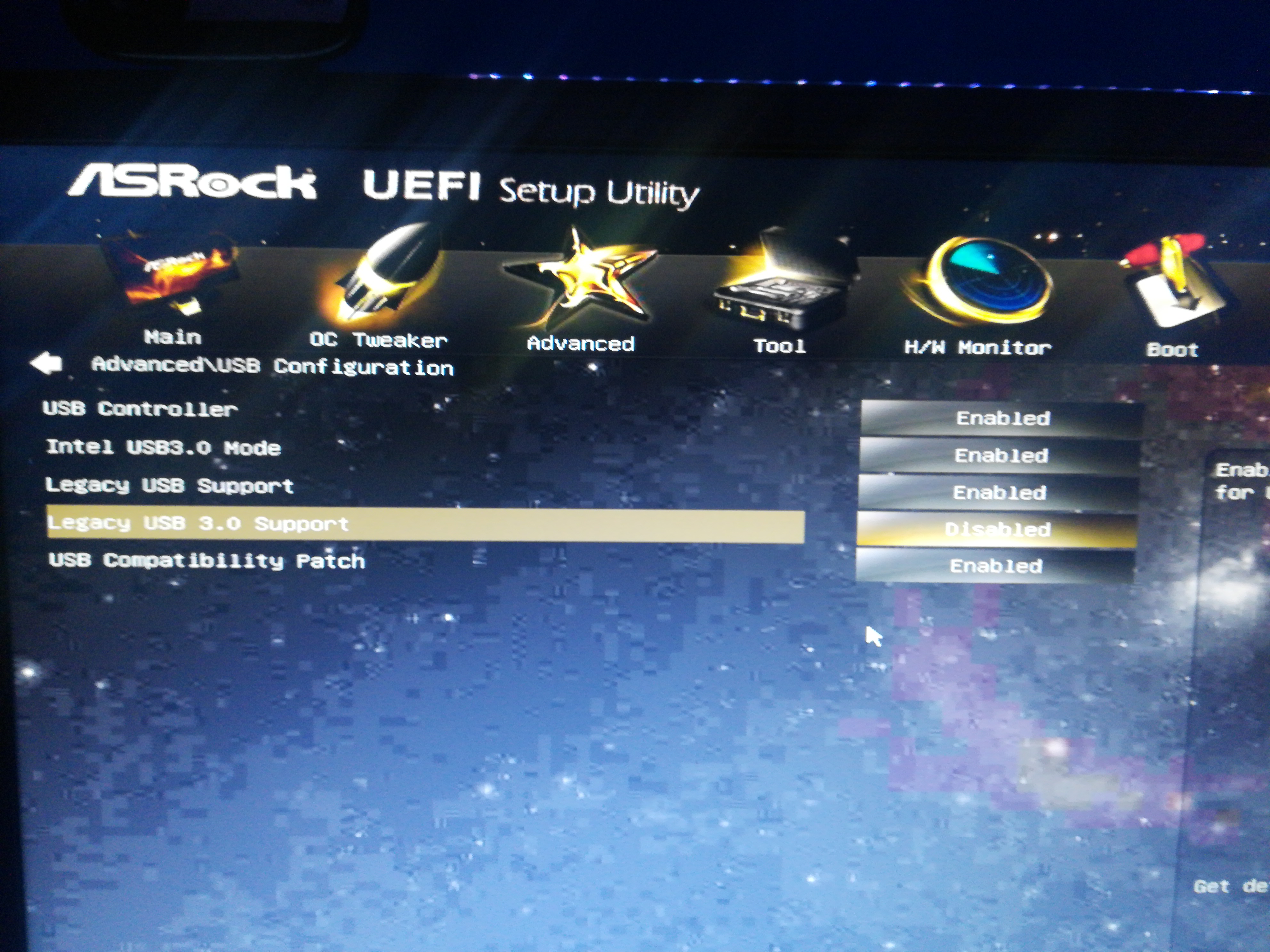

    Hello! I have a problem with usb inputs, after the format I wanted to enable usb 3.0 (usb 2.0 worked) in bios, found the appropriate tab and set "Intel Usb 3.0 mode" to enable. I saved the settings and turned on the computer. After that, usb 2.0 stopped working and 3.0 still didn't work. The usb drivers are installed and my motherboard is: ASRock H81M HDS. I add a photo of the settings that were selected after re-entering the bios. What I should do now?

    If there is a reset option, reset to default or load from stock ROM

    Hello. You had everything turned on before the reboot?

    You did not write what system it applies to, but I found something that might fit
    On an Intel(R) series chipset with Windows 8 * installed, some USB 3.0 devices only run at USB 2.0 speeds
    Most common problem: Port may be redirected to the ECHI controller instead of the xHCI controller. Check in Device Manager> Universal Serial Bus controllers.
    Another possible problem: Some USB 3.0 devices are not compatible with the Windows 8 * USB 3.0 driver.
    How to fix it by updating the BIOS
    Update the BIOS to the latest version. Download the latest version of the BIOS from the Original Equipment Manufacturer (OEM).
    How to fix this by enabling xHCI mode setting
    If updating the BIOS does not solve the problem, set the xHCI mode setting in the BIOS to enable.
    Check with your USB 3.0 device vendor to see if you can update the device firmware.
  • #5 16926759
    KeoPL
    Thanks for your help, including everything helped.
    Added after 4 [minutes]:
    However, after restarting the system, everything works until the desktop loads, the mouse and keyboard plugged into the USB stop working. The system is Windows 7 professional

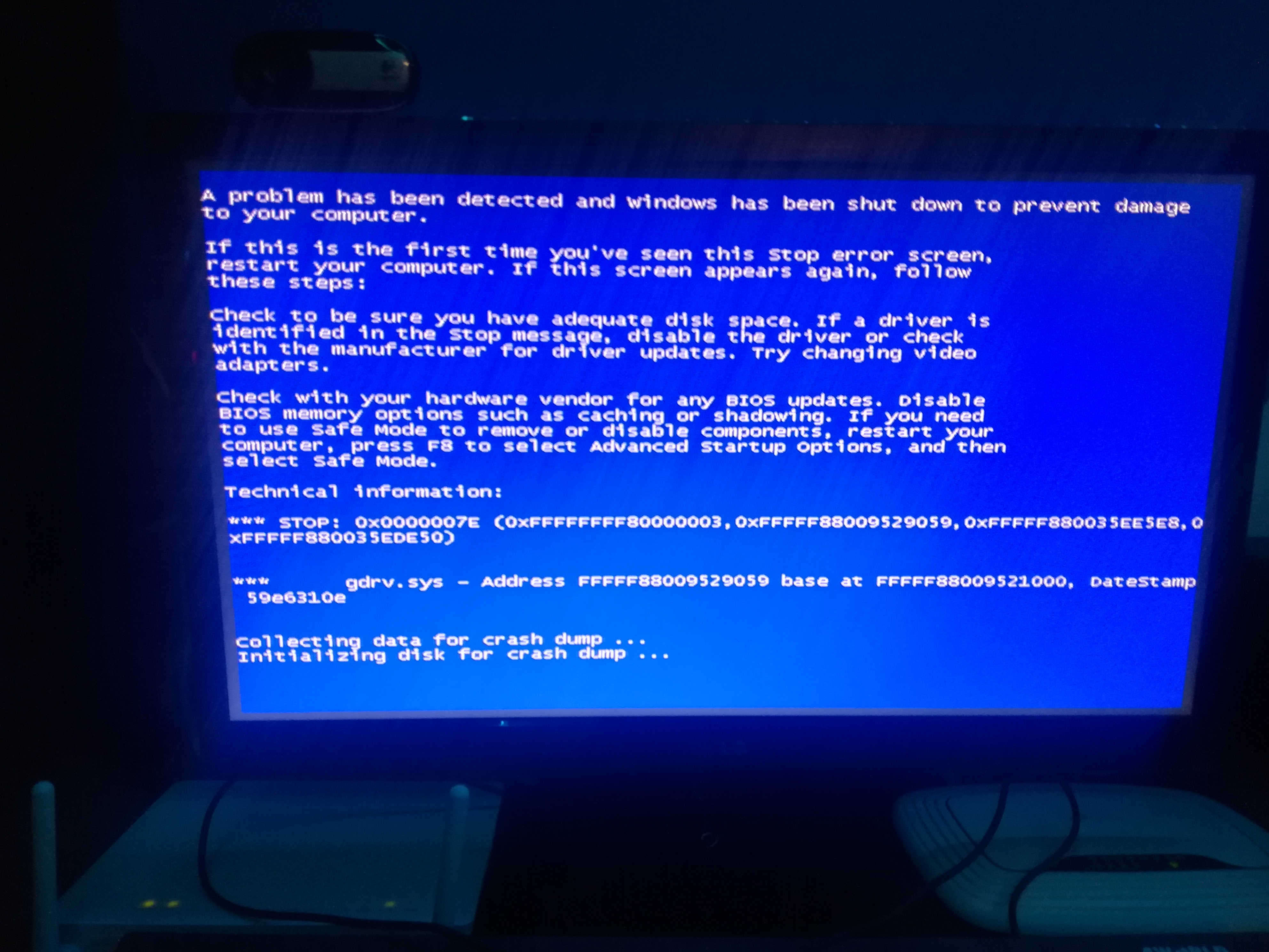

    Added after 3 [minutes]:
    Usb started to work properly, however bluescreen appeared
    • Can't Enable USB 2.0 & 3.0 in BIOS: ASRock H81M HDS Motherboard, Intel USB 3.0 Mode Issue IMG_20171231_155850.jpg (2.76 MB) You must be logged in to download this attachment.
  • #11 16926881
    Pedros050
    Posts: 17914
    Help: 2471
    Rate: 3926
    Driver problem after boot press F8 to safe mode.
  • #12 16926896
    KeoPL
    Safe mode started but I don't know how to fix this problem.
    Added after 35 [minutes]:
    Thanks to everyone for your help, everything works fine.
