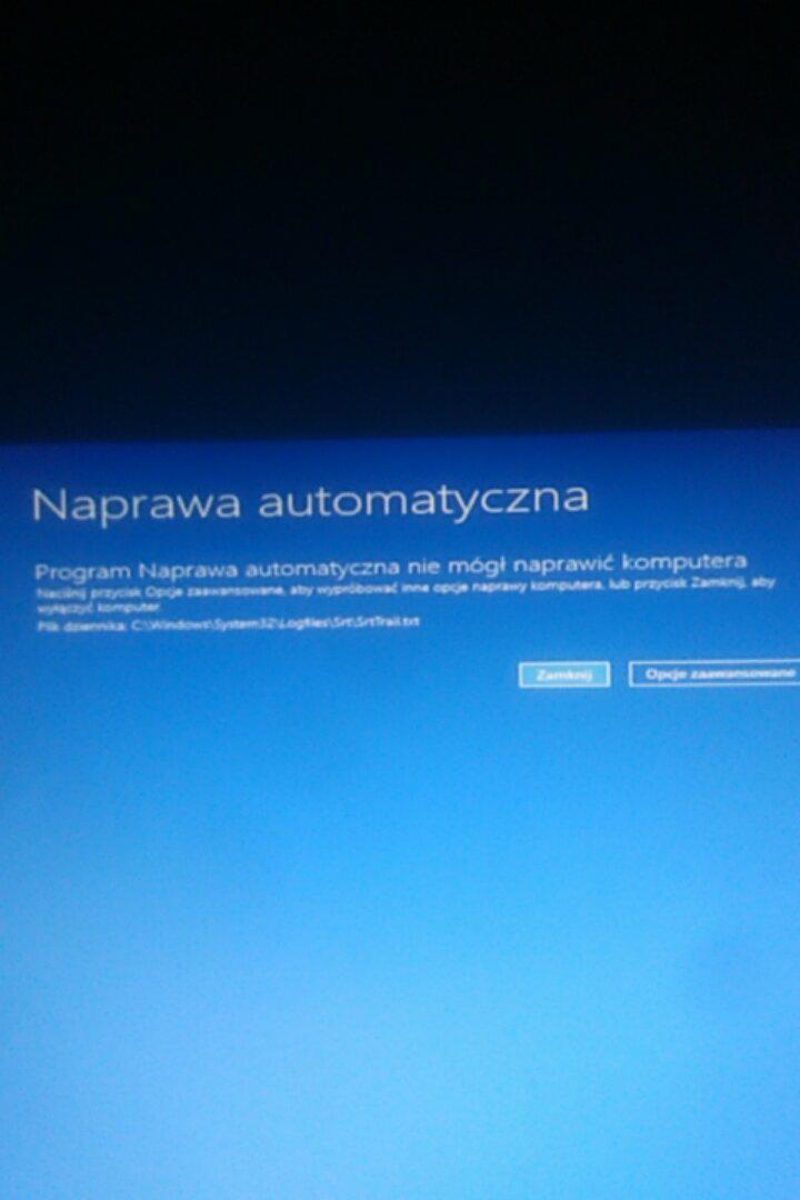

    Hello, I have Windows 10 on a USB flash drive, but I cannot force the computer to start the installation in any way. In bios, I changed the order in the first place is USB-HDD and despite this, the old system turns on. When I enter the boot menu and choose USB-HDD, the repair starts, after a short while I write that nothing has been done and sends me to turn off the computer or to start the system. Model - Gigabyte GA-H61M-S2-B3. Pictures below:
    Edit: I was able to turn on by entering the pendrive and in setup.exe but it imposes the home version in advance, but I would like a different one and I know that through the bios it was possible to choose ...

    I understand that since there is a problem and Windows "crashed", it wants to fix itself automatically and fails, you want to "format".
    This is not done, the problem may be with the disk, for example.
    It would be appropriate to attach the file mentioned in the photo ... \ SrtTrail.txt
    Click on [Advanced options], enter the command prompt and copy it to the inserted flash drive:
    copy C: \ Windows \ system32 \ LogFiles \ Srt \ SrtTrail.txt P: \ [enter]
    (for the letter P:

    Actually, it is not that it turned out, it was just cluttered for a long time and suddenly, as an update from Microsoft, the computer completely slowed down and some Windows things started to go crazy, that's why I want to do it all over again. Why does he want to repair? The answer is simple - the last update cannot install and the computer tries to install it over and over again, but something interferes and keeps withdrawing it and introduces it alternately, slowing down the computer and wasting my time trying to update ...

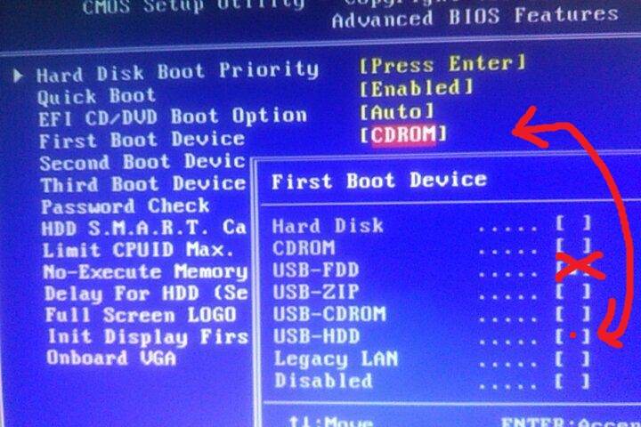

    In bios, set:
    SATA AHCI Mode to: AHCI
    USB Legacy Function: Enabled
    USB Storage Function: Enabled
    If you have properly prepared the flash drive to be bootable, it should start working. Usually, after turning on the PC, it is enough to press F12 to activate BOOT or Escape, it depends on the bios settings. A list of available mediums will appear and you choose the name of your data medium.

    The bios fires up Delete with the bot F12 key, but I see in the first post that you have shown I missed it, so do not choose USB-HDD only + Hard Disk and then the name of your Pendrive. Good luck :)
    Remember to change to AHCI in bios.

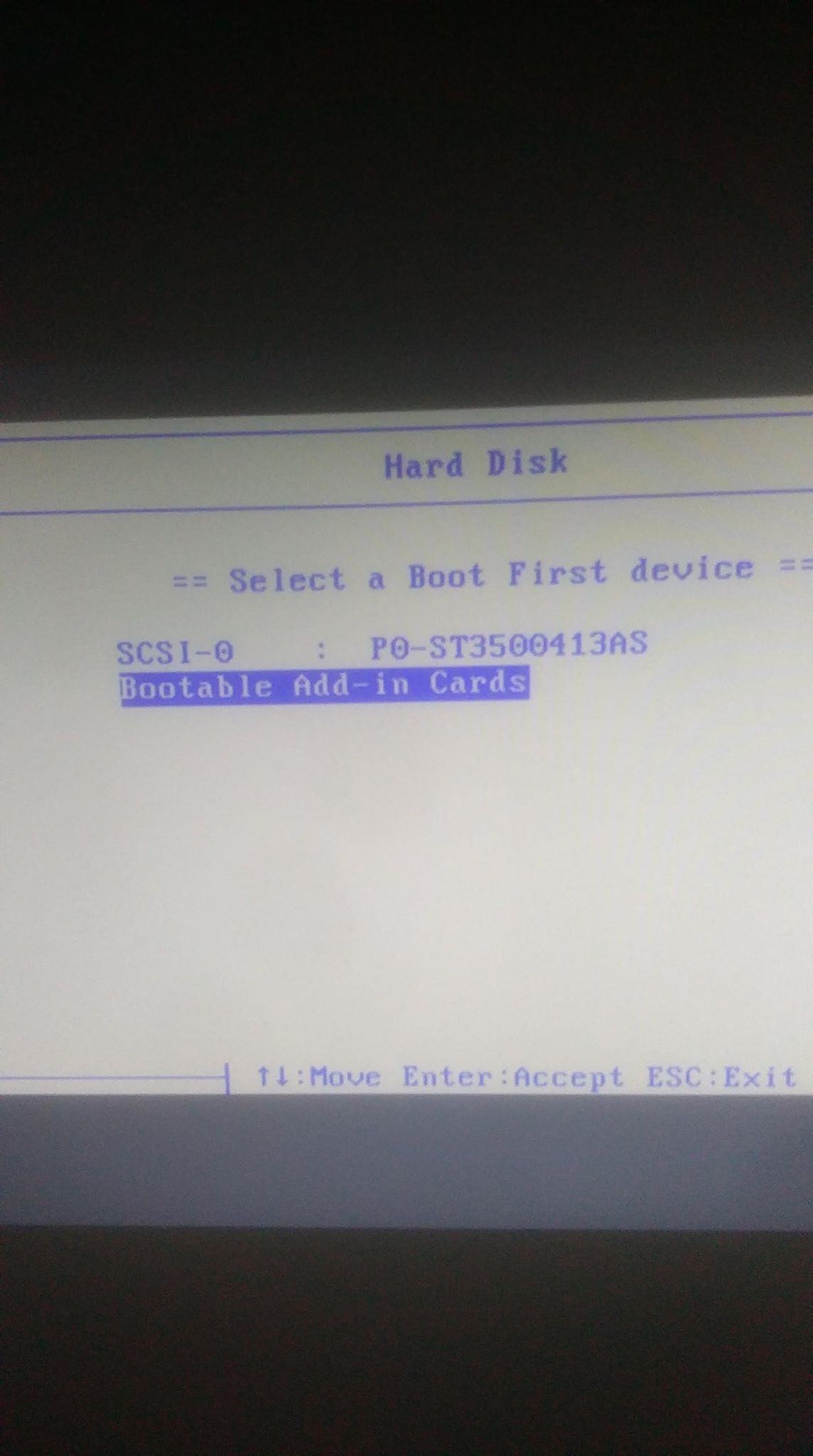

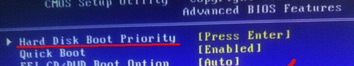

    Alternatively, what do you have to choose when you enter this option in bios?
    Unable to Boot W10 Installation from USB on Gigabyte GA-H61M-S2-B3: BIOS & Alternative Options
    Hard Disk Boot Priorities

    None of this, choosing Hard disk, I have 2 options that I put below (the same as you ask above) in ahci loads and finally crashes an error, and to communicate with anyone here on the forum I have to go back to the idea that even more fire up this system. I guess I'll have to 'settle for' the truncated version ...

    And how do you choose bootable add in cards then what's going on?
    And because you got into it Hard Disk Boot Priorities, if you are there, set the bootable add in cards first, probably F6 changes the position there should be written. and how do you change F10 or save the bios.
