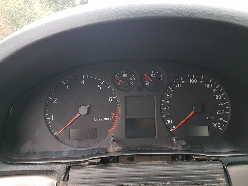

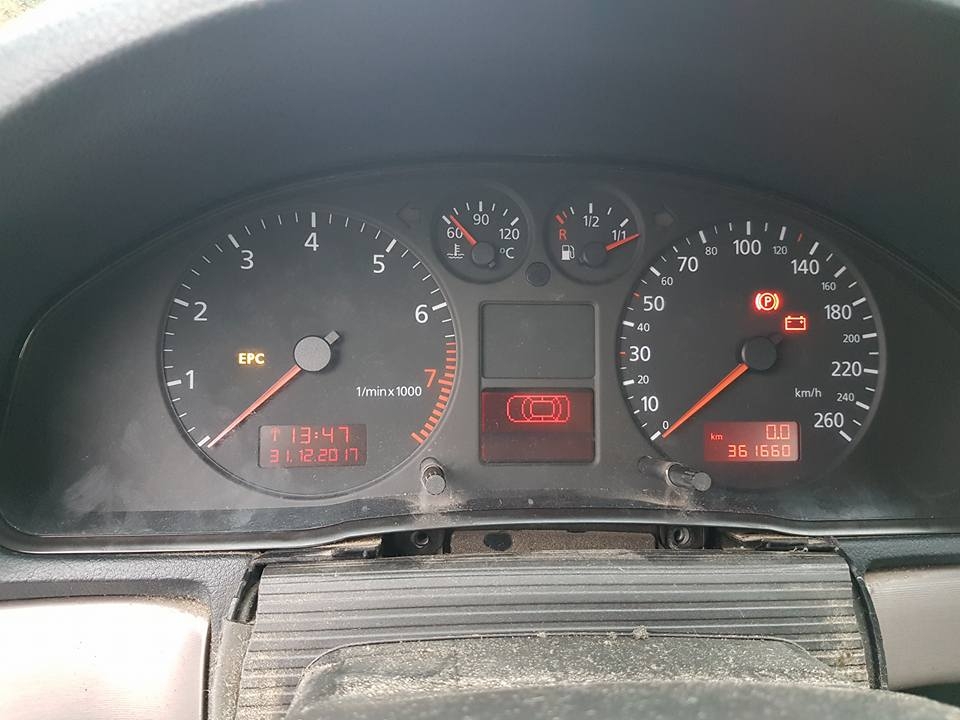

    Problem with petrol level indication.
    With a detached plug the float shows the status of about half the tank. On the VAG in the engine controller, the correct amount indicates how 10L it is, in the measured block it shows 10L.
    Replacement meter, can it be corrected?
    Ignition on and float connected.
    Audi A4 B5 1.8 20V: Fuel Level Indications Discrepancy - Float Status vs VAG Engine Controller
    Ignition switched on and the float detached (float cube disconnected in the trunk)
    Ignition off.

    Hello. To save time, replace the dashboard. Because it looks like a damaged print on the plate or a fuel gauge engine '

    The indicators themselves are almost certainly damaged. A typical ailment.

    you have jeager clocks. Change as soon as possible before other miracles happen.

    Damaged Jaeger counter. I recommend changing to VDO (I adapted from A6 C5 full fis)
