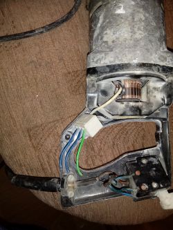

    Hello, I have a Celma drill and I have a question because there was a capacitor in it that melted and I have a question if it can be bypassed somehow and connected so that it works properly or you need to buy this capacitor.

    You can simply disconnect it. It is an anti-interference capacitor, the drill will also work without it.

    Okay thanks and do you know which ones how to connect the 2 blue and green ones in what order?

    2 blue - voltage without green, green went from the stator to the capacitor.

    The drill may work, but the radio playing next to it will make a lot of noise and prevent proper reception.
    It certainly won't hurt to insert a capacitor.
    It should have a capacity around 10-100nF.
    The cost of such a capacitor is less than PLN 10.

    Works without a capacitor.
