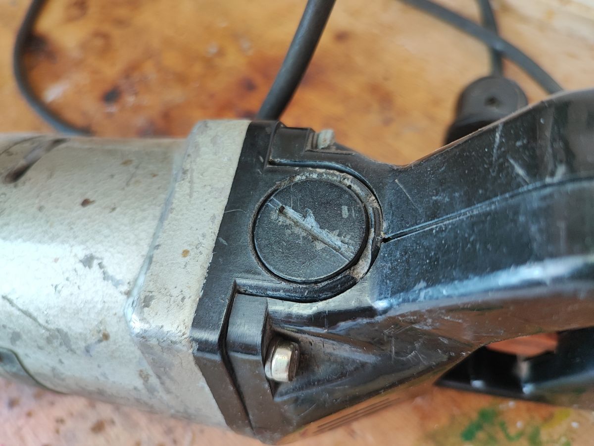

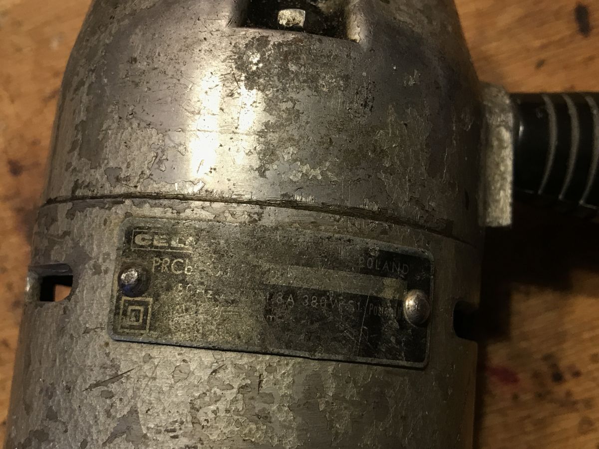

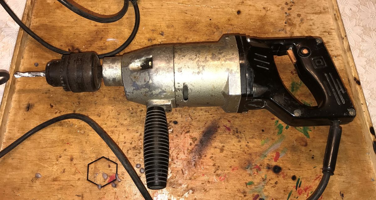

    Today we are going to look at a single-speed, no-impact drill from a bygone era. This is another old piece of equipment that I will try to run here. I have identified the model of the equipment as a Celma PRCb, although the nameplate is partially worn out:
    Old Celma PRCb drill with partially worn nameplate. .

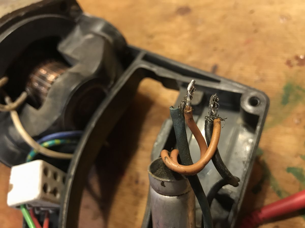

    The first thing I started with was checking the whole thing with a meter. I wanted to check if there was by any chance a short circuit or a puncture on the housing. It appears that everything is fine.

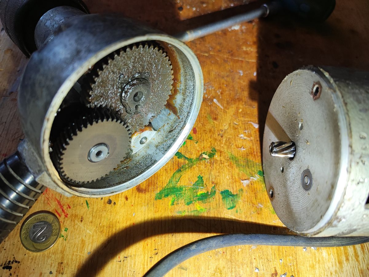

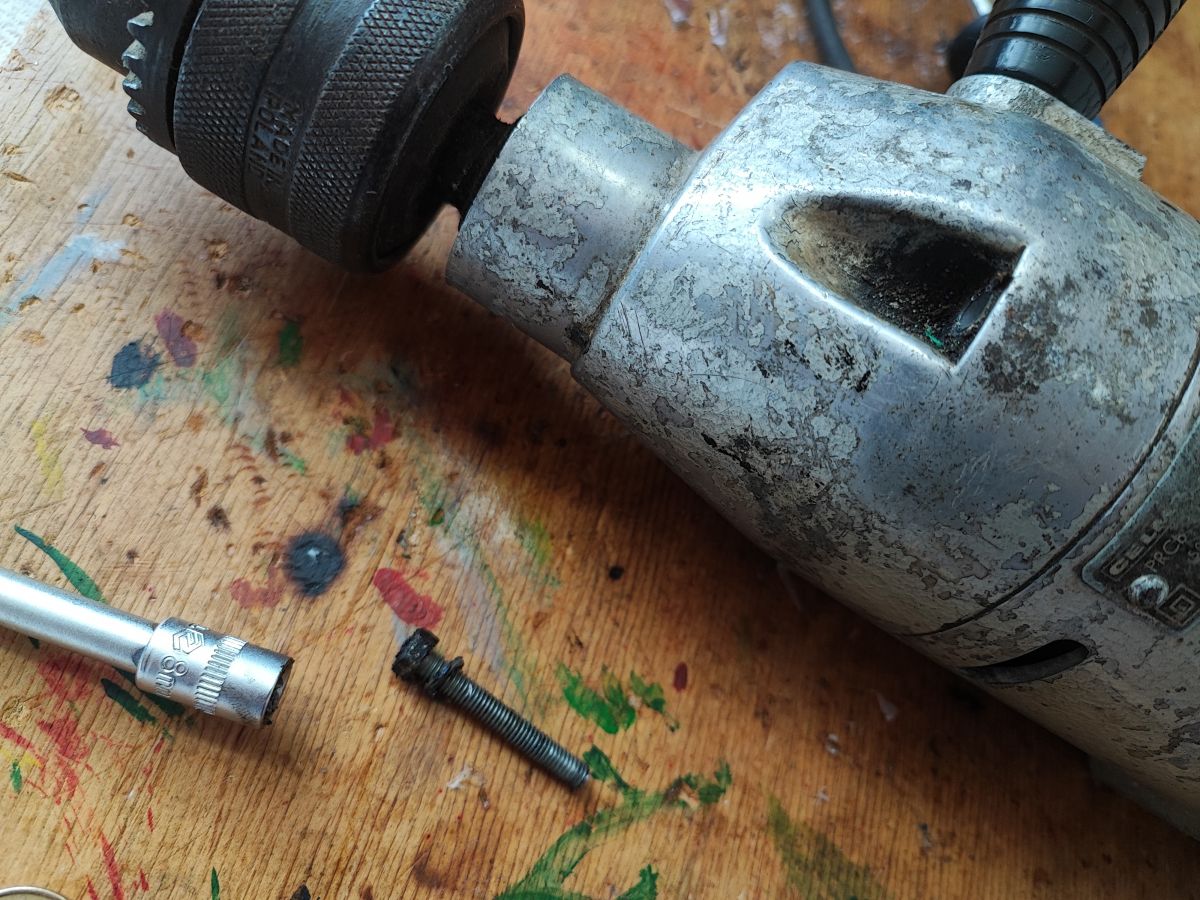

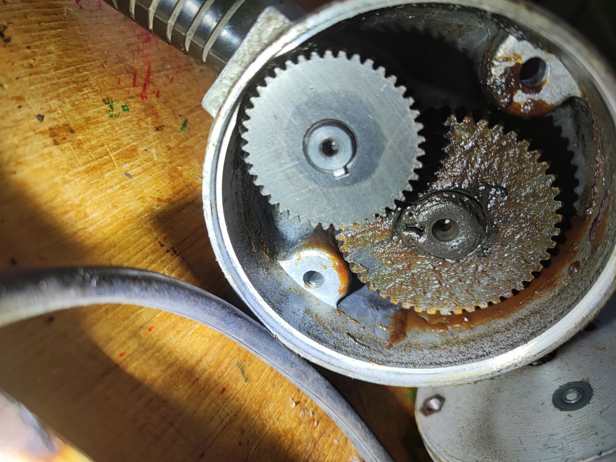

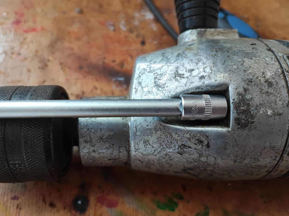

    Next, I checked the gears. A socket spanner will come in handy:
    Celma PRCb drill with a socket wrench attached. Old Celma PRCb drill on a wooden table, with a socket wrench and a screw nearby. .
    I don't see the damage, the grease should be changed, but I need to buy or borrow any first:
    Open gear housing of a Celma PRCb drill on a wooden surface with a coin nearby. Open gearbox housing of a Celma PRCb drill showing the gear mechanism. .

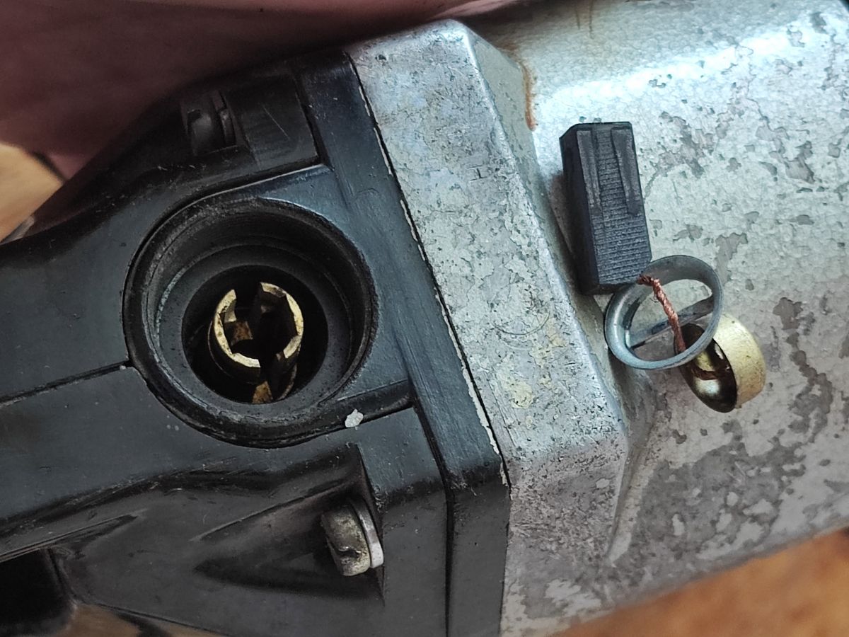

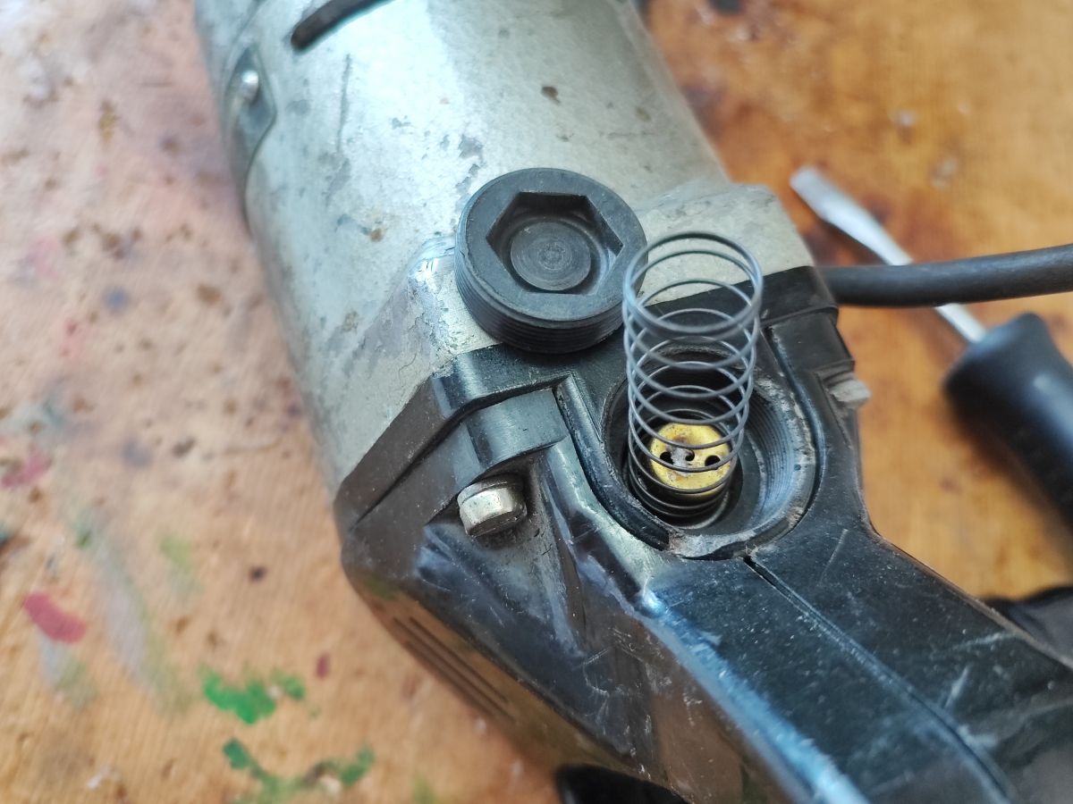

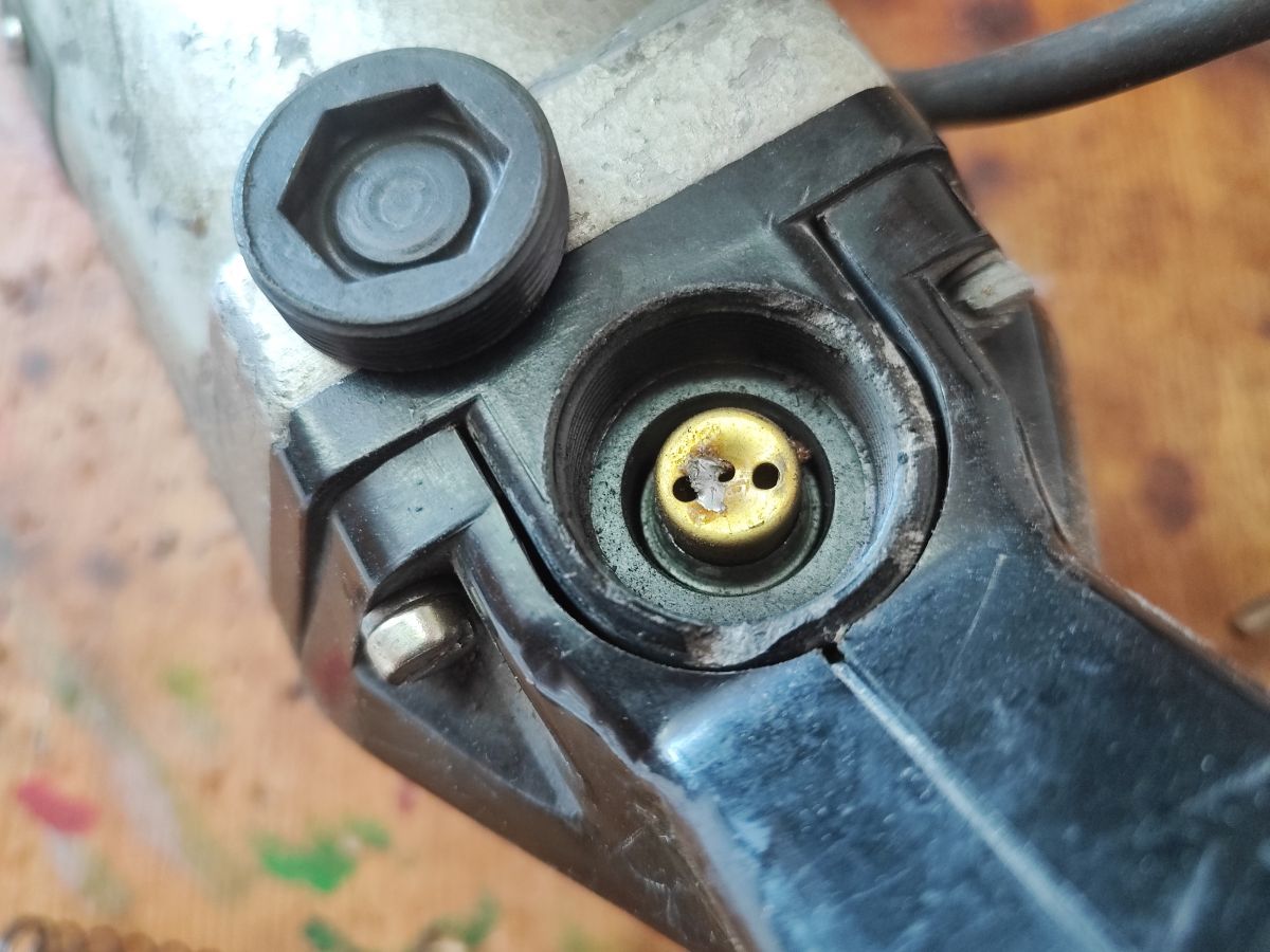

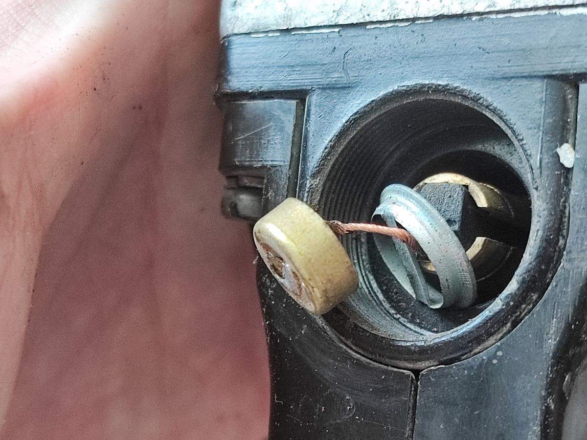

    Then it was time for the brushes. We unscrew them, carefully so that the spring doesn't pop out:
    Close-up of a damaged plastic component on an old Celma PRCb drill. .
    About her:
    Spring and internal housing of the old Celma PRCb drill. Close-up view of Celma PRCb drill with a damaged button.
    Here's the carbon brush. It's not that bad:
    View of connector with wire in old electrical equipment View of a drill with switch components on a metal casing. .

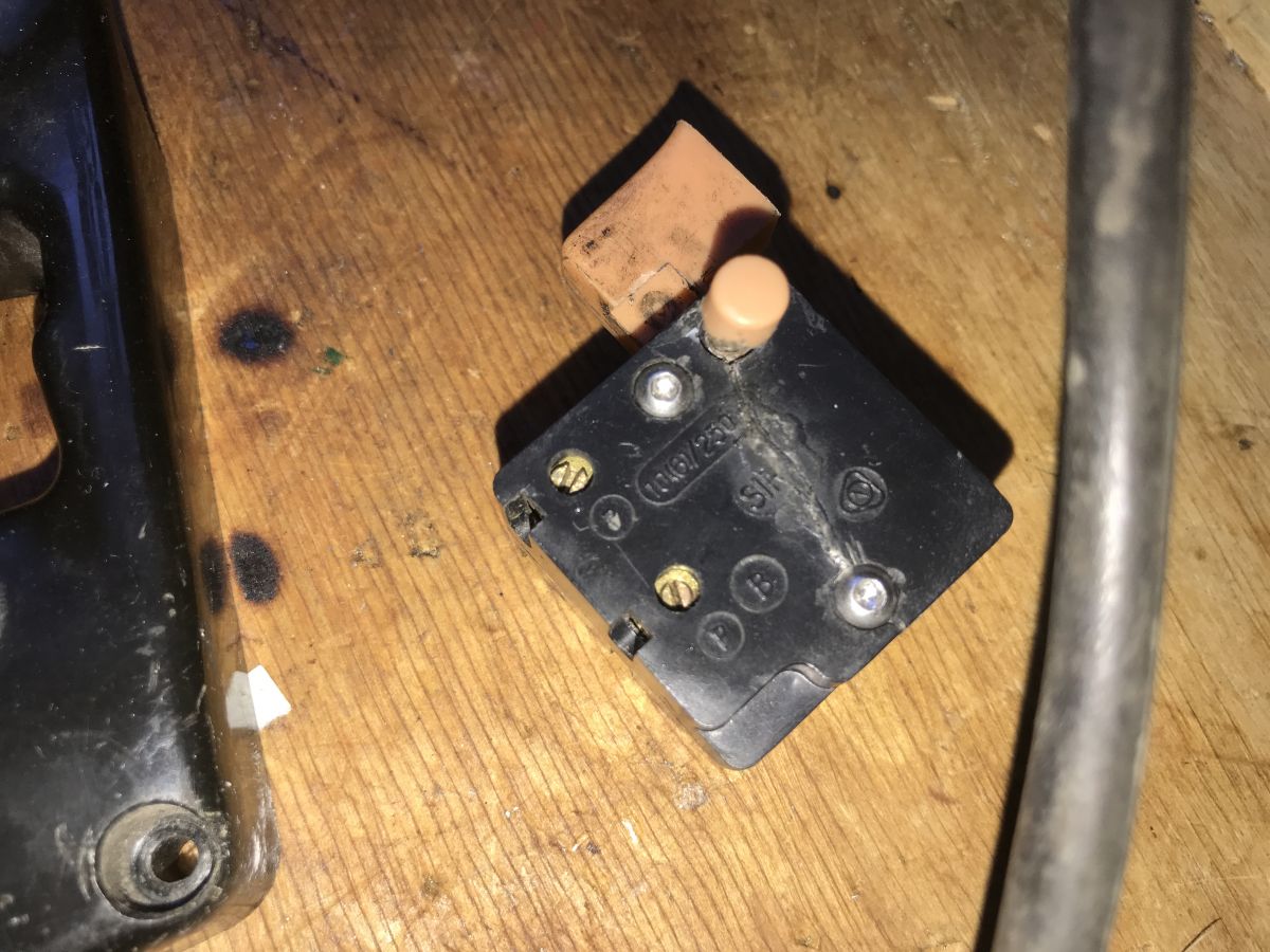

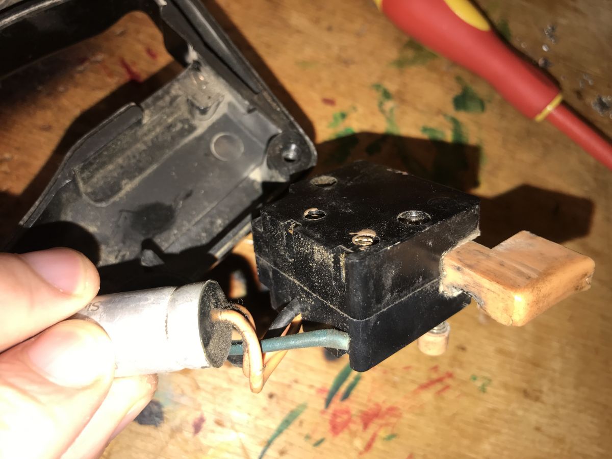

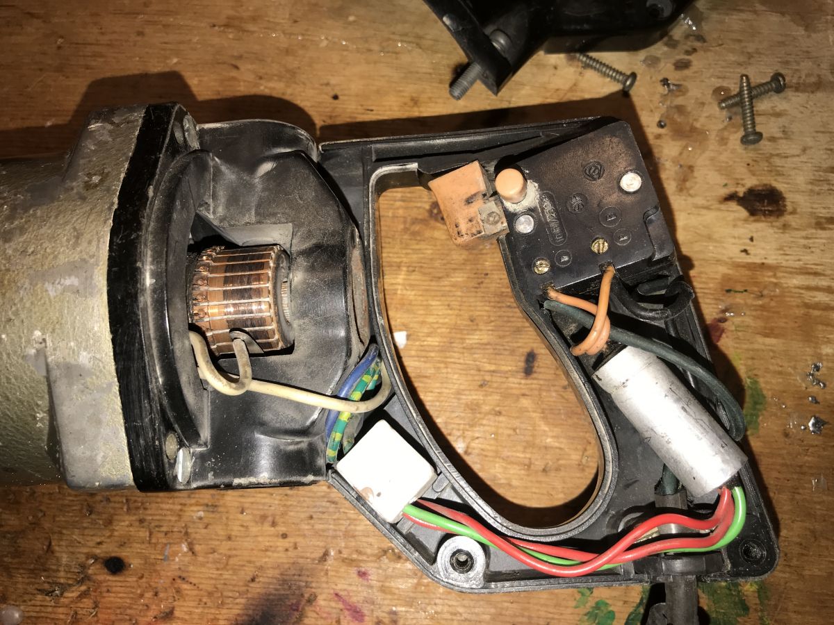

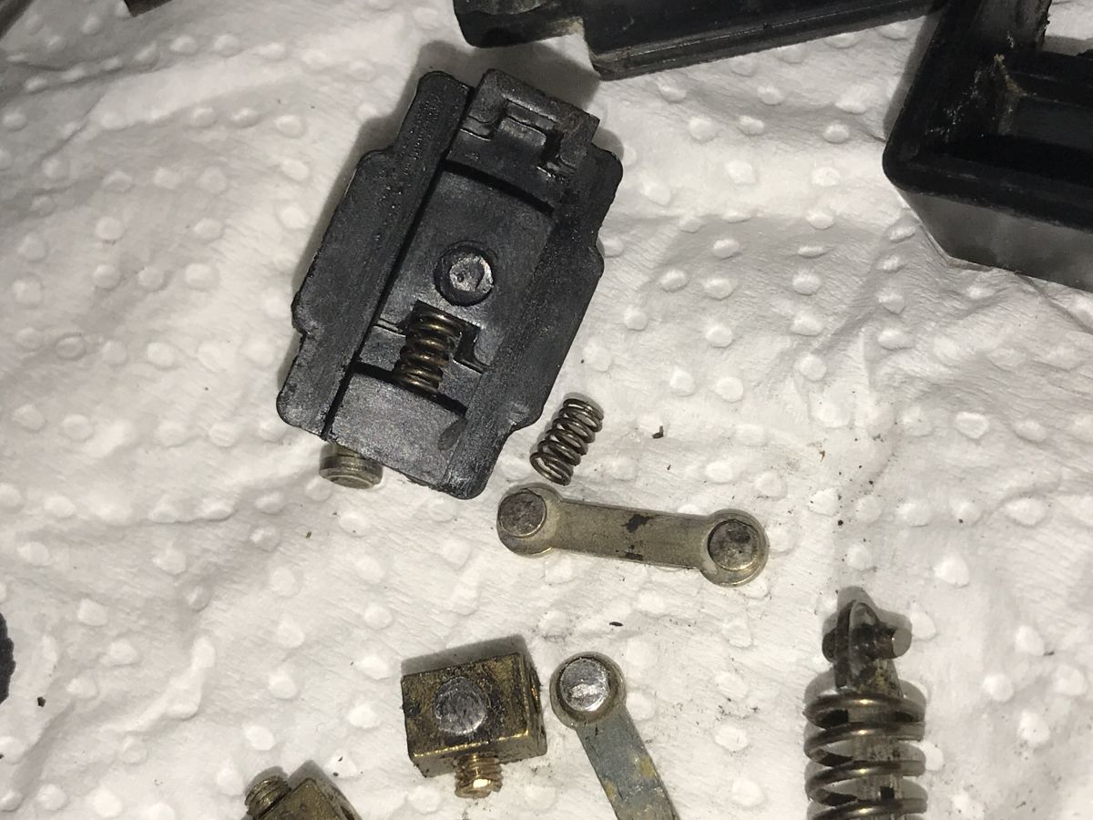

    Then I decided to connect the whole thing to the power supply and.... works! But what do you mean, without a button?
    The button must be faulty or someone has shorted it out. Let's check.
    Interior of an old Celma PRCb drill showing the motor and wiring. Close-up of an old switch with partially connected wires. Disassembled electric drill with visible wires and motor fragment. .

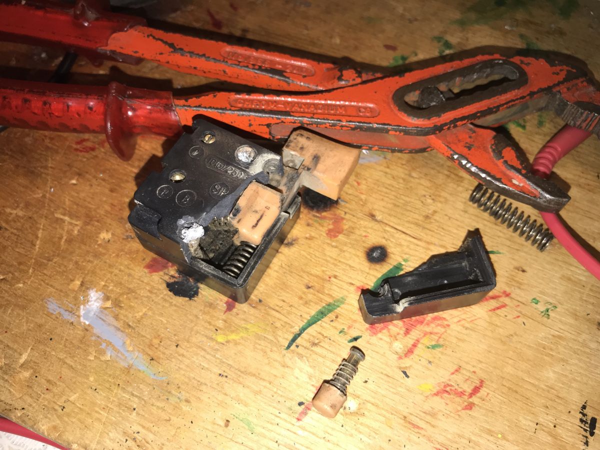

    Indeed... someone has deliberately omitted the button, is it defective?

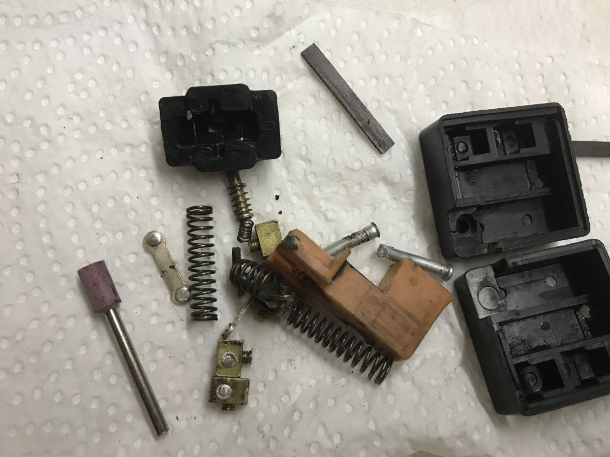

    Unfortunately in the process of taking it apart the plastic broke:
    Disassembled switch components with damaged plastic on a workbench. .

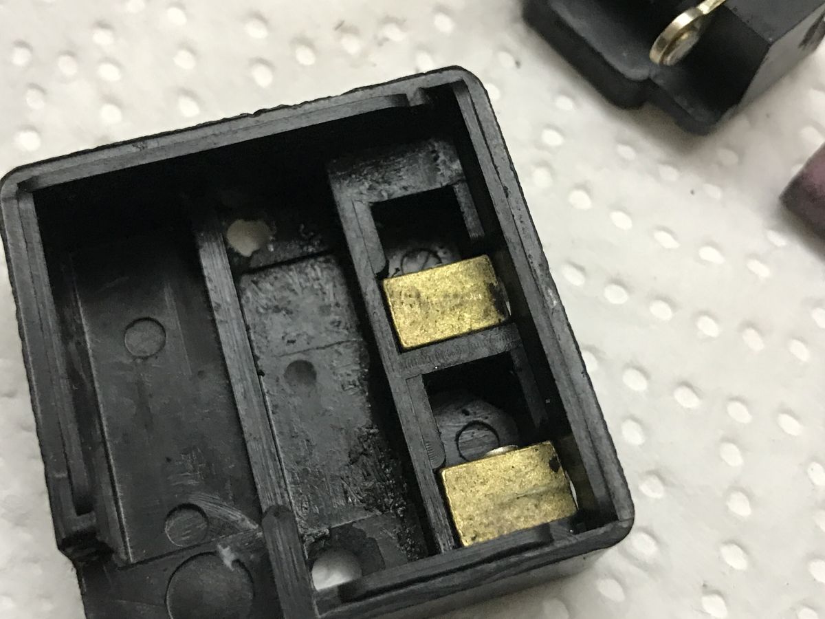

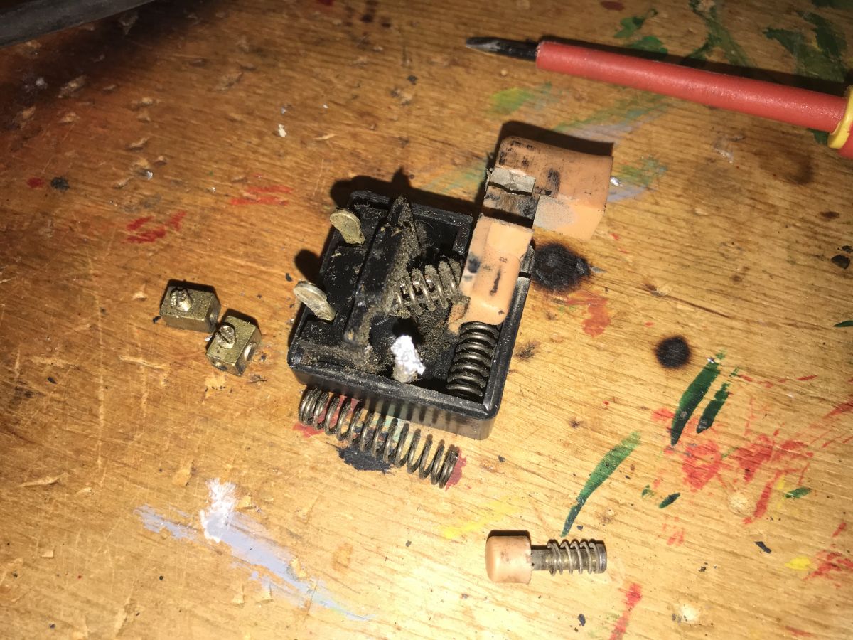

    However, this is a great opportunity to look inside:
    Dismantled drill switch on a wooden table. .

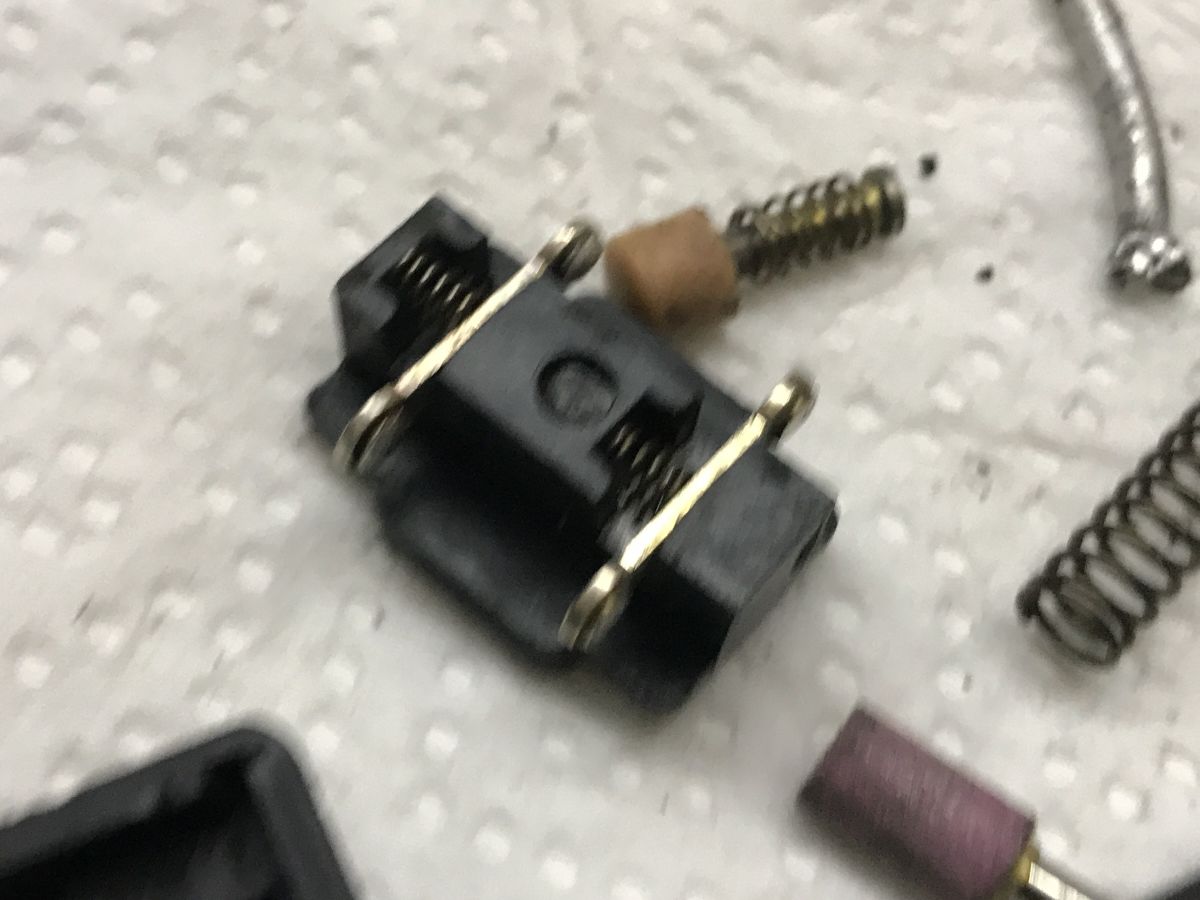

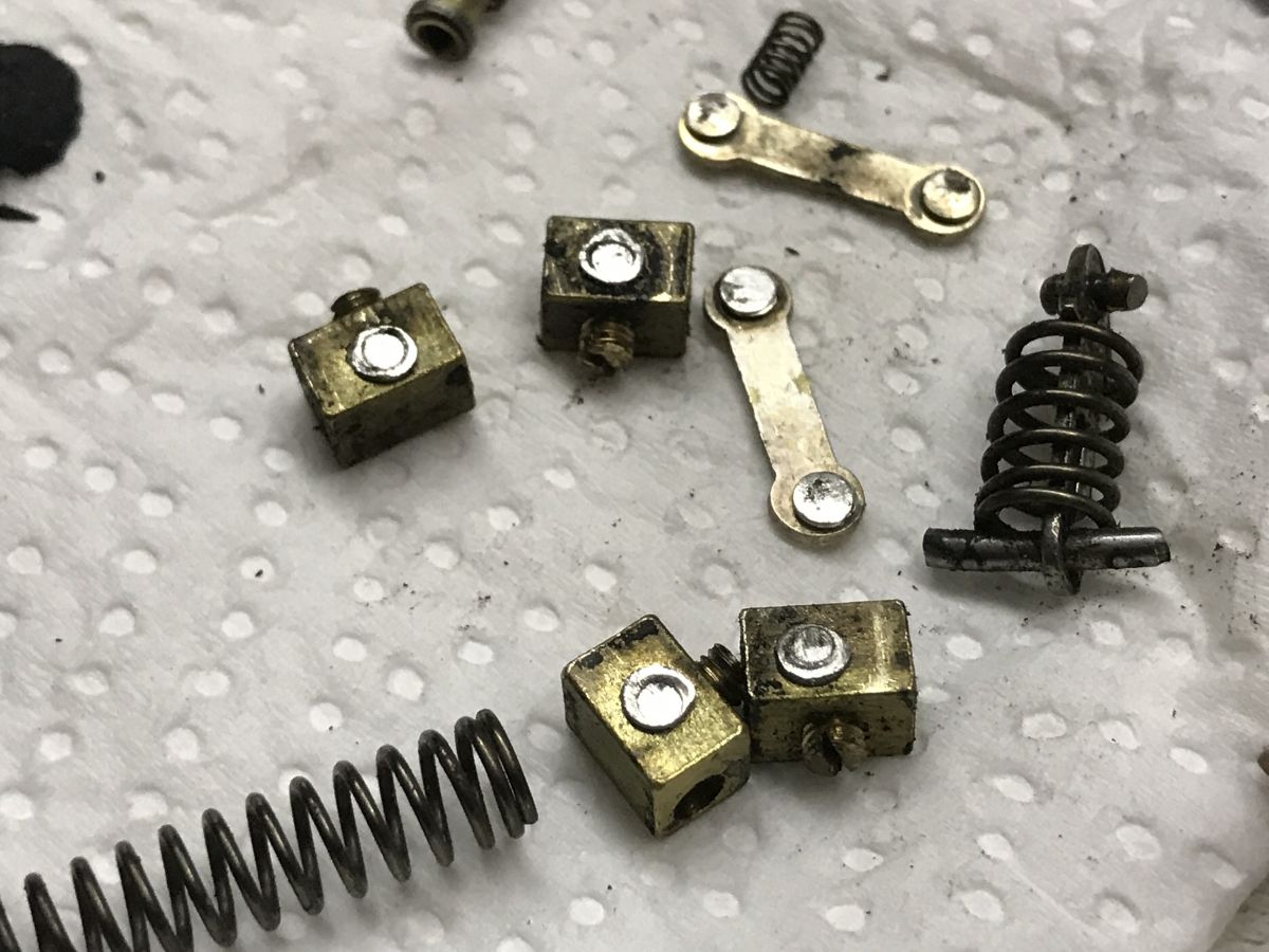

    With this amount of dirt, it is not surprising that this button did not short circuit. I checked with a multimeter. Indeed, there is no contact.
    Metal parts and springs lying on a paper towel. Switch components, including springs and metal elements, on a paper towel.

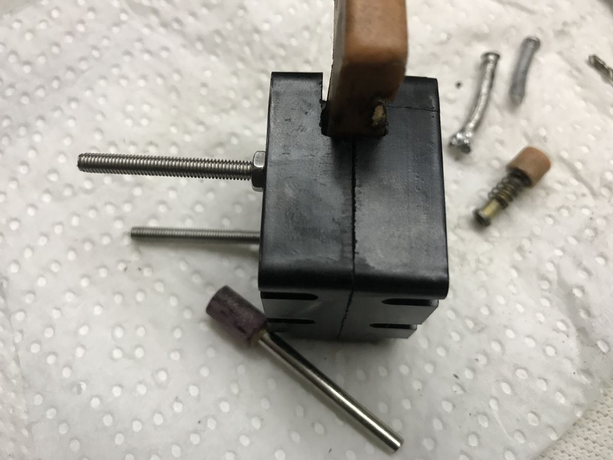

    How dirty it all is.... I took a cloth, IPA, a sander and started to gently remove the dirt. By the way, this switch has two modes - either momentary, or you can also push in the pin and lock it temporarily in a shorted state.
    Disassembled drill parts on a paper towel. .

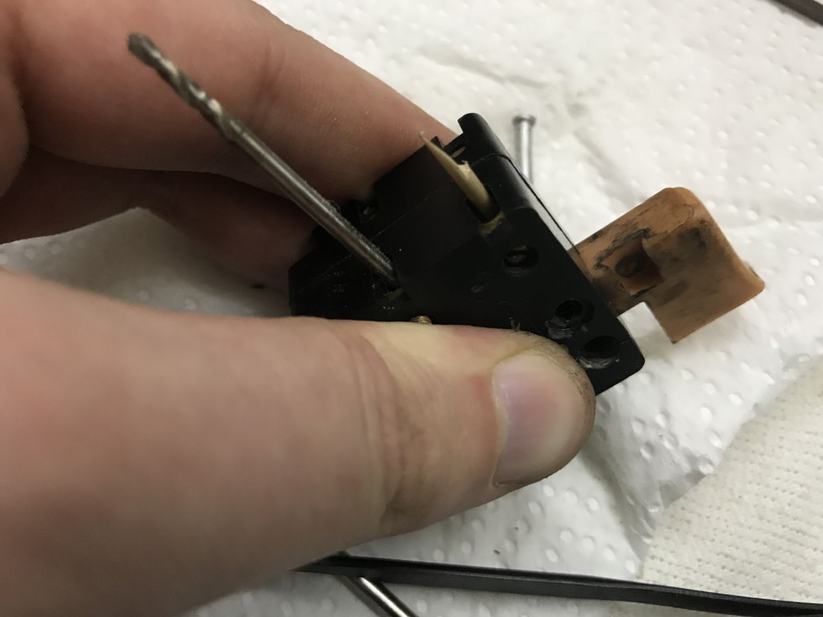

    Pictured in the process of fitting the switch back on:
    Disassembled switch from a Celma drill on a paper towel. Inside of a plastic switch casing with visible contacts.
    Here a toothpick temporarily holds one of the elements for me:
    Disassembled switch of Celma PRCb drill with internal components on paper. .
    Turning:
    Person holding a disassembled switch of a device on a paper towel. View of an electrical switch with protruding screws and components on a paper background. .
    I shortened the screws, which were too long, and prevented them from dislodging with a drop of glue.
    Close-up of a plastic electrical switch on a wooden table.

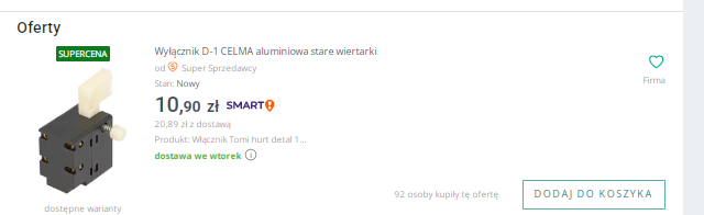

    And all this fun was actually a bit of art for art's sake, as the switch can be bought new:
    Photo of a listing for a switch for an old Celma drill, priced at 10.90 PLN. .
    Nevertheless, I gave my "sculpture" a chance and success - it works ! Looks like my new old Celma is working.
    By the way, I can see brushes to buy too, not bad.
