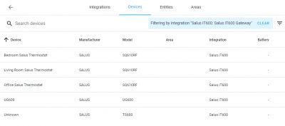

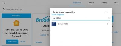

    #10 20585406
    benczyk
    Posts: 13
    gbksiazczak wrote:
    Standards do not yet exist for the whole, only for individual components.
    I found something like SALUS.
    https://salus-controls.en/salus-smart-home/page-glow-sh/
    Benefits: Unofficial operation with HA, in case of a net or HA 'failure' it is a locally normal running system.
    Disadvantages: "Unofficial" support, runs through their api i.e. via the cloud.
    Best Solutions for Integrating Underfloor Heating with Home Assistant Best Solutions for Integrating Underfloor Heating with Home Assistant .
