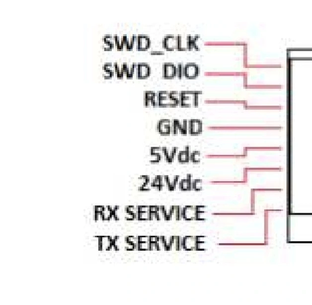

    irsl
    I've got an Ariston Lydos Hybrid heater. According to the manual (https://gepesz.hu/connect/dokumentumok/cikkfile/uj/gepk_ariston_lydos-hybrid_20180103_1639.pdf (page 19)), there is an RJ45 on the motherboard, which is supposed to provide a serial interface:
    Exploring Ariston BUS BridgeNet Protocol for Boiler Operating Parameters Communication
    Has any of you managed to establish a connection with this device?

Does the Lydos Hybrid RJ45 offer BUS access?
Ariston labels the RJ45 as UART. Pin-out: 1 TX, 2 RX, 3 GND, 6 +5 V (manual p19). Connect through 3.3 V-TTL adapter and sniff 9600 Bd. No BridgeNet frames confirmed yet [Lydos Hybrid Manual, 2018].
