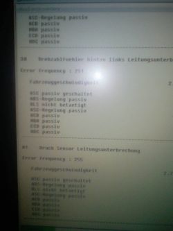

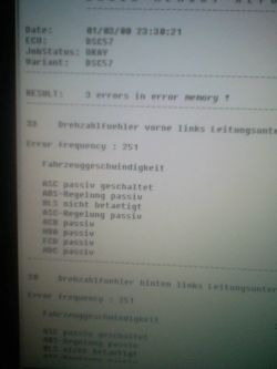

    The car is a BMW e39 is a problem with ABS and ASC. the speedometer sometimes works sometimes not. And inpa shows errors. Maybe someone can help read.

    But what's your problem? What do you not understand? You've got the bug number and description, but in German ...
    The first two errors: LP and LT ABS sensors. LT sensor gives info just to the meter ... First check the sensor resistance. Often, drivers also sit in e39, especially with error 33, but let's not assume the worst at the beginning ...
    81 - ABS pressure sensor.

    The LT sensor is exchanged and unfortunately it is unchanged it is the same detaches the speedometer. I will check this pressure sensor for now.

    Brand sensor or some cheap? The color of the plug also matters. BMW doesn't like substitutes, unfortunately. Connection location and installation checked?
    The pump pressure sensor error may be the result of errors from the wheel sensors.
