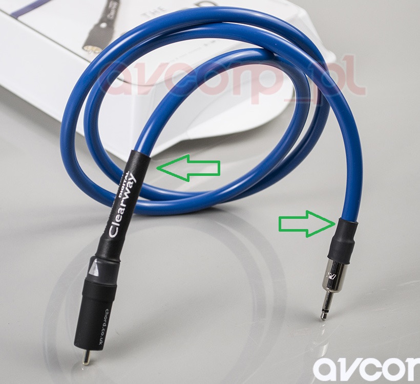

    One more question. I often make audio and power cables and use heat shrink tubes as shown in the picture. Unfortunately, where some time after bending the cable, marked with arrows, gaps appear [the heat-shrinkable sleeve does not adhere perfectly to the cable, there are minimal gaps]. It doesn't bother me that much, but it looks unsightly. Is it normal? Are "thermowells" with glue used in such cases? Do I have any bad ones.
    Thanks for your help and best regards

    The glue tube will be rather thicker and stiffer. Additionally, there will be a slight glue discharge at the ends.
    It's worth testing. Only if the glue grips well, it degreases and wipes the insulation surface. If you developed a procedure for yourself, it might be a good effect.
    I did not use thin ones.
    This is normal.

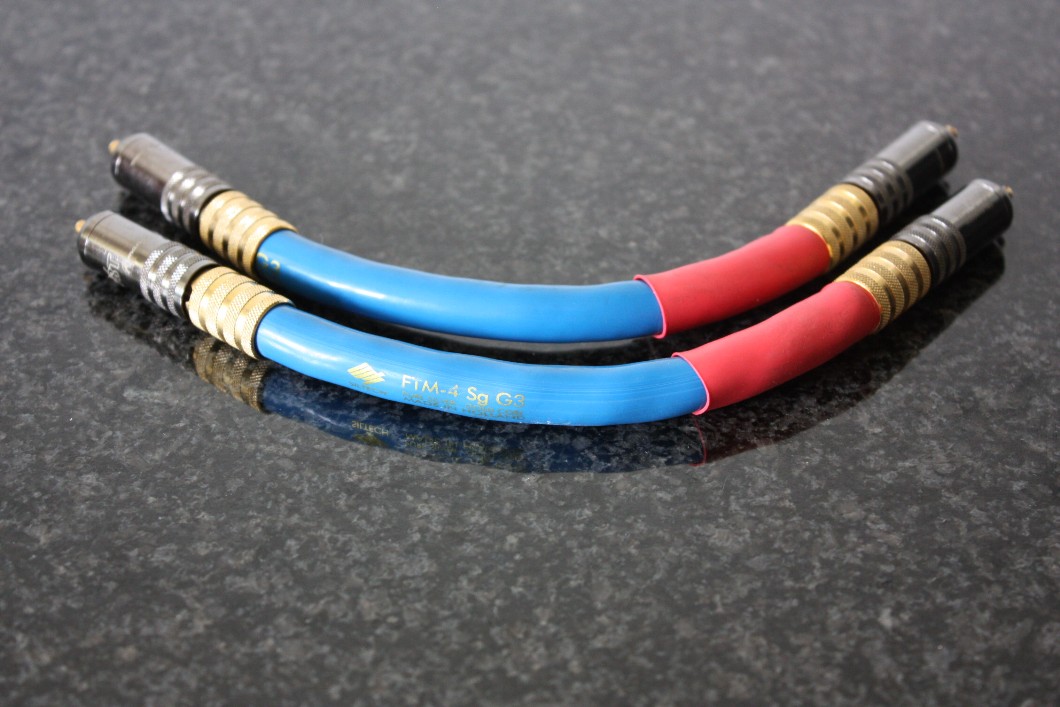

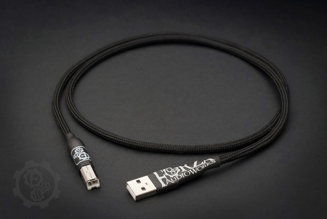

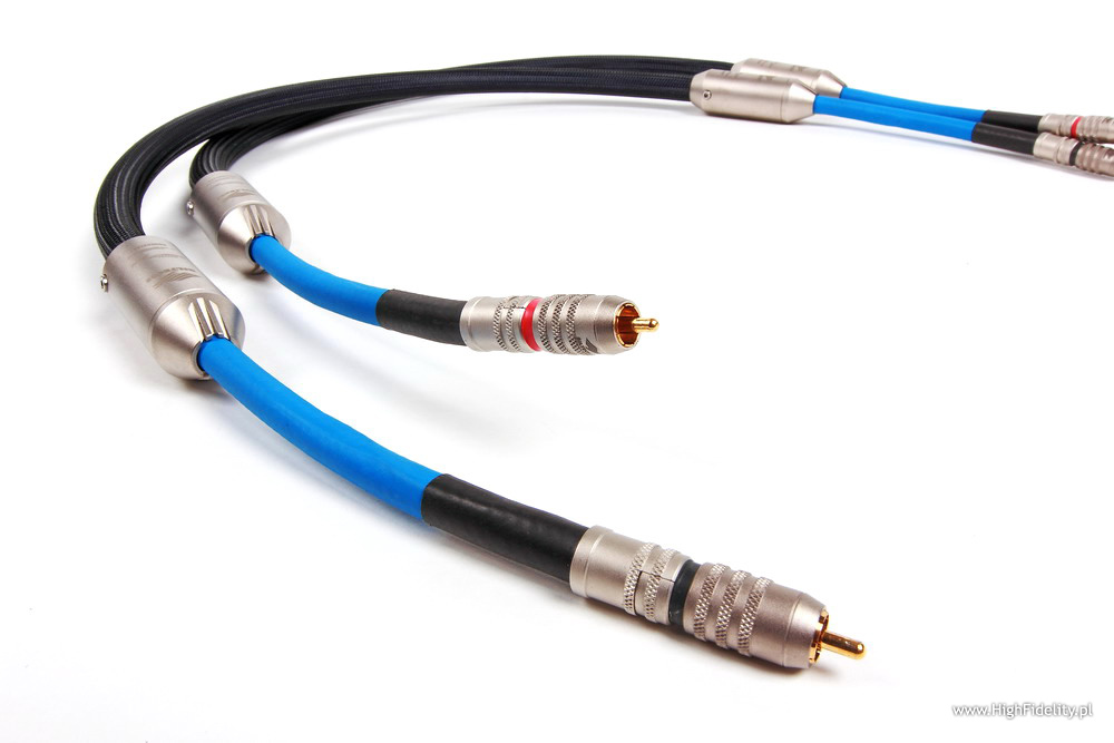

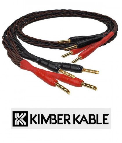

    I know the fact that the resilience drops, but it seems to me that not much. It can be seen on a massive scale that manufacturers, self-respecting companies, use heat shrink sleeves on plugs and wires. Some examples below. My only question is whether it is normal that the heat-shrinkable tubing does not adhere perfectly to the cable after bending the cable several times.

    But in these photos these are audiophile cables, it seems. There is more magic in such than physics.

    But heat shrink tubing is also different. The ones with glue are stiffer precisely because of the glue.
    Thin wall tubing is generally to be found and there are flexible versions. Tubes also have a different shrink ratio, the smaller it is (probably 2: 1), the smallest I've ever seen, the more flexible the tube.
    You would have to try different manufacturers. TME has several manufacturers and clearly states the type of tube, so maybe buy a few different?

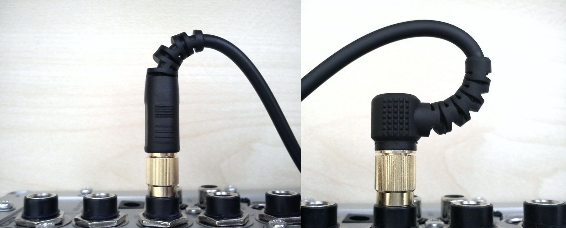

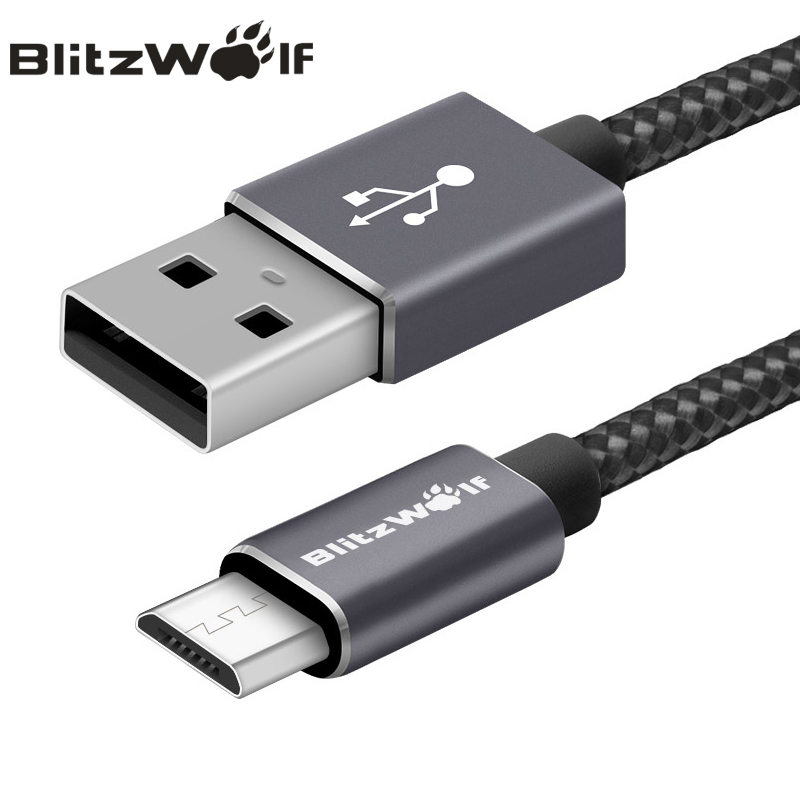

    I have had a BlitzWolf USB cable for a year. A solution similar to Apple, only the piece of plastic behind the plug is quite hard and thicker. The cable is used quite intensively several times a day. It has been operating for a year until today :) I think it's the quality of the materials used. The cable is not very flexible.

    Argennto_1 wrote:
    I have had a BlitzWolf USB cable for a year. Apple-like solution
    In what sense to Apple? Is the tip magnetic?
    As for the strain reliefs, there are cables with long strain reliefs, but they are so stiff on a large length that the device cannot be brought to the wall as the socket is at the back.
