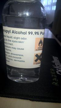

    Now it will be a problem, because the silicone does not catch anything, even fresh silicone.
    It is best to clean it as best as possible, with sanding the surface, rinse it a few times with silicone remover and either give a decent, branded silicone sealant (not crap for PLN 8 / cartridge), or a bandage several times and resin (can be car / novolac).
    Got it, but you have to use isopropyl alcohol for cleaning.
