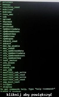

  • #6 16395132
    Multi_COM
    GSM specialist
    Posts: 2218
    Help: 93
    Rate: 60
    @mobista: I assure you that in this model we can read even if it has FRP and there is no ADB enabled - we do not load any customs or TWRP
  • #7 16395149
    mobista
    Level 35  
    Posts: 3300
    Help: 257
    Rate: 365
    Just like me and a gro of other websites in Poland. The problem is that you are writing about kernel substitution with authorization confirmation turned off in a model that has a relatively fresh SECURITY PATCH, which in my opinion generates at least a few understatements.
  • #8 16395268
    Multi_COM
    GSM specialist
    Posts: 2218
    Help: 93
    Rate: 60
    I don't upload anything to the phone, so I don't replace the Kernel via BL ...... to be precise - it can be done without undressing (without ISP, ChipOff), without ADB enabled (so we exclude the vulnerability patched in October), without replacing the kernel ( BL), without TWRP ....... maybe I will give you a bit - it will take a lot of time (16Gb reading about 40h) but it can be - to make it more precise, we did not invent the access method in such a way that does not change the fact that it can be ..
