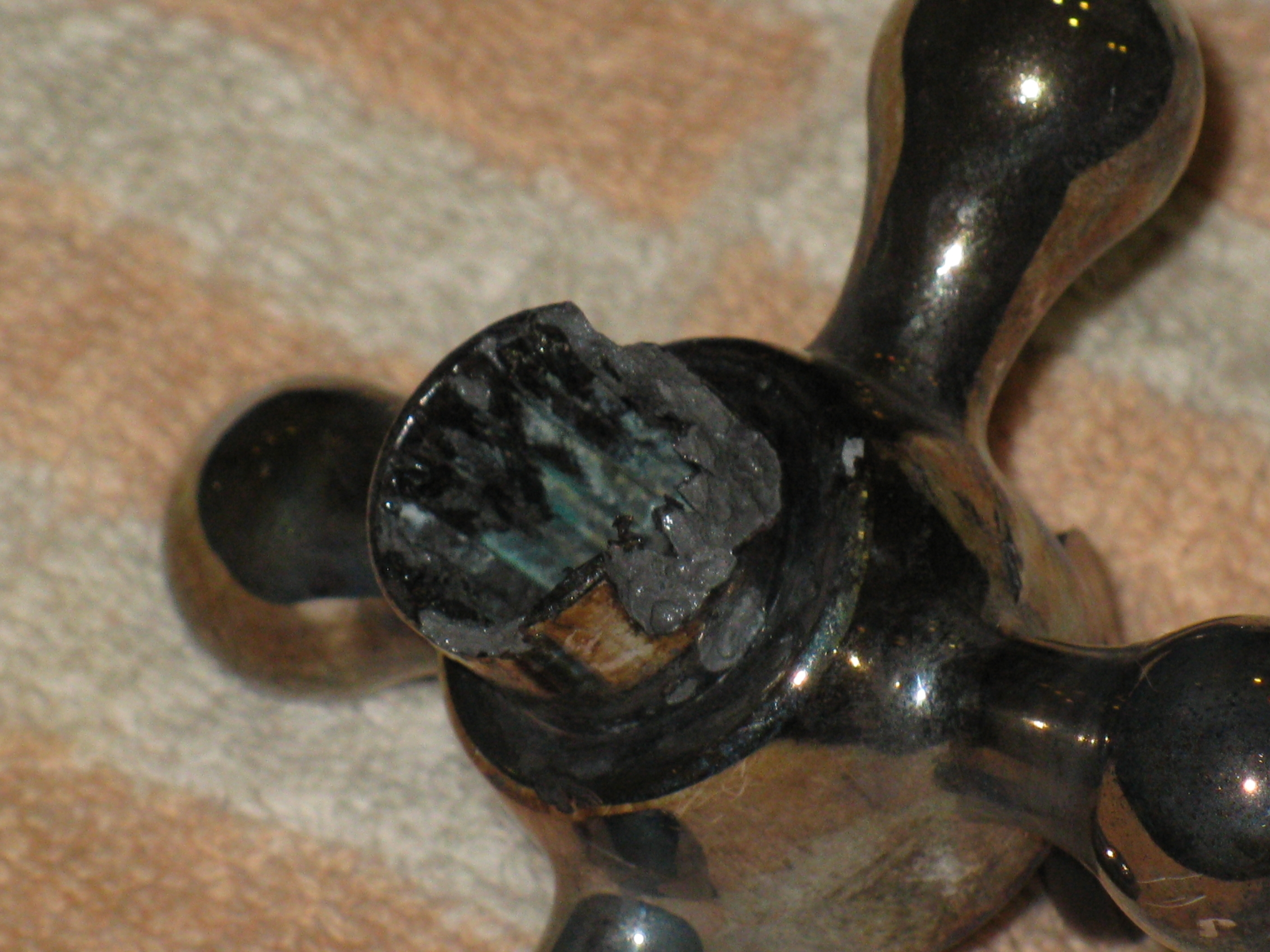

    I would like to ask honorable colleagues who are more flimsy about water fittings, whether it is possible (and possibly how) to lubricate components of water fittings when assembling, i.e.: valve components, movable / rotated spouts, threads, gaskets, orings, etc. Is this lubrication, at least in to some extent protects every element, against limescale deposits and against erosion of some (taps) elements.
    I would add that it was stone and corrosion inside the taps of the bath and sink faucets that made it very difficult for me to disassemble them.
    Greetings.

    My main point is whether it can be secured somehow so that the "eating" of these taps does not continue:
    Water Fittings: Lubricate Valve Components, Spouts, Threads, Gaskets, O-rings & Prevent Limescale? Water Fittings: Lubricate Valve Components, Spouts, Threads, Gaskets, O-rings & Prevent Limescale?
    brofran wrote:
    Threaded connections greased before assembly are more easily dismantled
    It is known that I do it in the car in some cases, but I have concerns in the fittings, especially after the entry:
    BANANvanDYK wrote:
    Take into account contact with drinking water - petrochemical products will cause you to poison yourself.
    In addition, EPDM rubber elements are used in the water fittings. It is a type of synthetic rubber that is resistant to hot water, but the presence of oils and greases causes swelling and dissolution.
    So threads and gaskets / O-rings are better not to lubricate ?!
    Can I grease spouts of taps and valves?
    Can I lubricate the axis / valve stem contact area at the contact point with the valve sleeve?
    I would add that it was not a big problem to spin everything up. The problem was the disassembly of the taps (they are pressed in by means of plastic elements), which were dismantled only after the chemical dissolution of the taps' corrosion.
    Greetings.

    The knobs do not look like brass castings. Rather, ZnAl or aluminum alloy, materials susceptible to corrosion. I think this something is a Chinese production bearing a Polish brand.
    You're right, brass doesn't crumble that way.

    The fact is that the taps are actually made of some kind of aluminum alloy, because they oxidize to a similar degree to this metal, except that they are much heavier than aluminum, i.e. ZnAl.
    I cleaned, smeared, folded and works - not leaking. I left the original O-rings because they were completely unused, did not crumble and were more flexible and tight than new ones. The main problem of the battery was: stone, corrosion and small pebbles, which I found inside the valves. The taps will not change, because I have found that in case of further problems, both batteries will be changed. These are about 15 years old, so they have already earned a living. :-)
