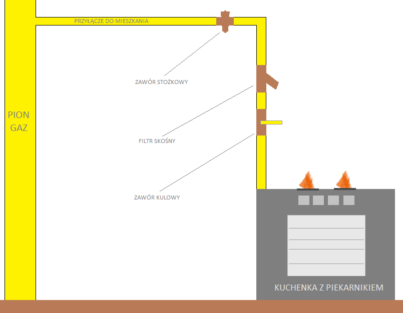

    Your advice is valuable to me, so I can handle one more thing. It is about using a gas slant filter.
    I think that since I am already doing this job, it's worth doing it the best. So I invented installing this filter.
    The outlay is small, and I prefer to be sure that the gas that reaches the oven is free of impurities. In addition, it is easier to clean the filter than the stove, or even worse to look for a defect in the oven caused by contaminated gas.
    And now I think in which place it (the filter) mount in front of the ball valve or behind it. I have the "main" gas valve right after the entrance to the apartment (brass conical valve), but I read that it should not be used too often, because it can be unsealed - how much I do not know. I could mount the filter right behind it, and as the next and last element I would give a ball valve that would already work in clean and filtered gas - which would also be irrelevant to it). But I do not want to strain this damn most important conical valve. Somehow I do not see myself putting on two ball valves one before the filter and the other behind, it does not make sense. The obvious thing is that I need to turn off the gas to clean the filter. Probably I will not do it more often than once, maybe twice a year (by the way how often it should be cleaned), but considering the fact that I have not used a conical valve for the last 10 years, this is some exploitation for him. That's why I ask you how you would do it and how it is according to art?
    Below is a pictorial picture :)

    #13 16650005
    misiek1111
    Level 37  
    Posts: 4121
    Help: 325
    Rate: 1097
    Once in the first century.
    The order -> pipe, ball valve, filter, stove.
  • #14 16650290
    jareckim
    Posts: 70
    Help: 5
    Rate: 49
    The main valve has nothing to move. It's a gas valve. The gas plant takes care of the gas purity. The filter is probably in front of the central gas meter. If you want to set up your filter, just after the ball valve and possibly check its purity once every 15-20 years. And it's provided you use the oven very often.
