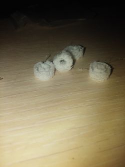

    Hello, I recently bought a 3D printer, put it together and started printing.
    Unfortunately, the projects that I print do not combine (stick together) are not entirely
    I printed the black Wolfix PLA
    and Standard in the set
    Nozzle temperature: 210 Degree
    Table: 60 and 80 tested
    Cura LINK configuration: https://mega.nz/#!R4EQQaiA Password:! BdPoOp8dGBjJ9yqzQ7KTXiii8sgMn5AhX2HFMiB9qm4

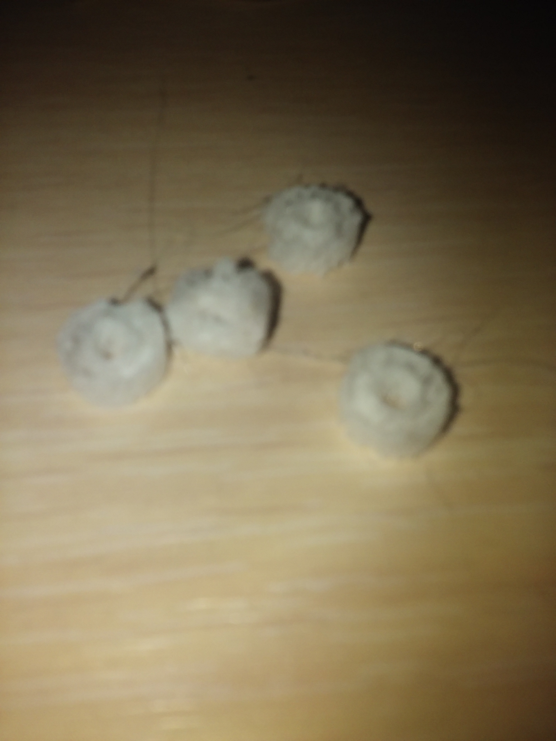

    The problem is solved (I create the so-called grass in Cura and it is not there)
    But there is another quality now print is below criticism what do you propose to do? so that there are no farfocs>?

    You didn't mention how you solved the problem and it would be useful to other users of this printer.
    It seems that the print head has an incorrect temperature. The material is too ductile.
    I suggest you get back to basics.
    Download a few calibration models and print them with different settings.
    Experiment with table temperature, feed speed, head temperature and cooling.
    Calibrating a 3D printer is not so easy. You work with demanding material that has its own properties. The printer must be configured to match the material used and the size of the printed models.

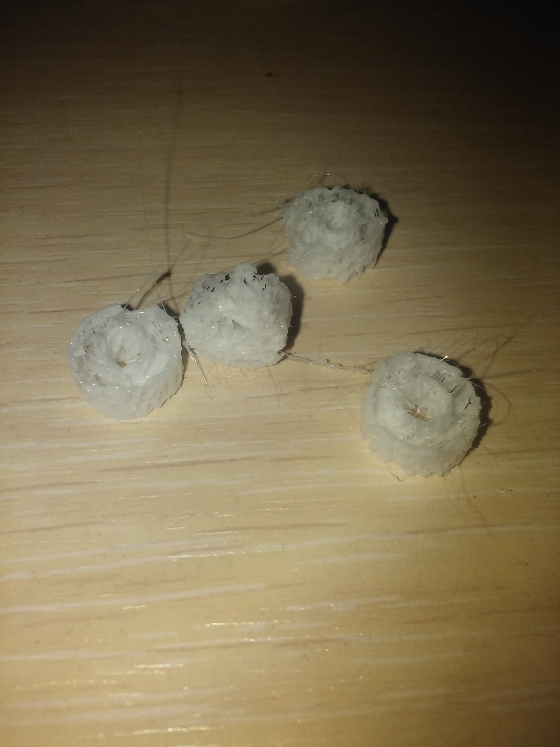

    The fault was that the nozzle size was set in Cura to 2.75 and must be 1.75 in my case.
    now the printer does not feed the filament on the table any ideas?

    The nozzle is too high. Calibrate the Z axis.

    The printer has a damaged filament feeding motor.
    Extruder replacement helped.
    (The printout did not stick due to the wrong diameter of the nozzle in Cura (2.75) instead of (1.75)
