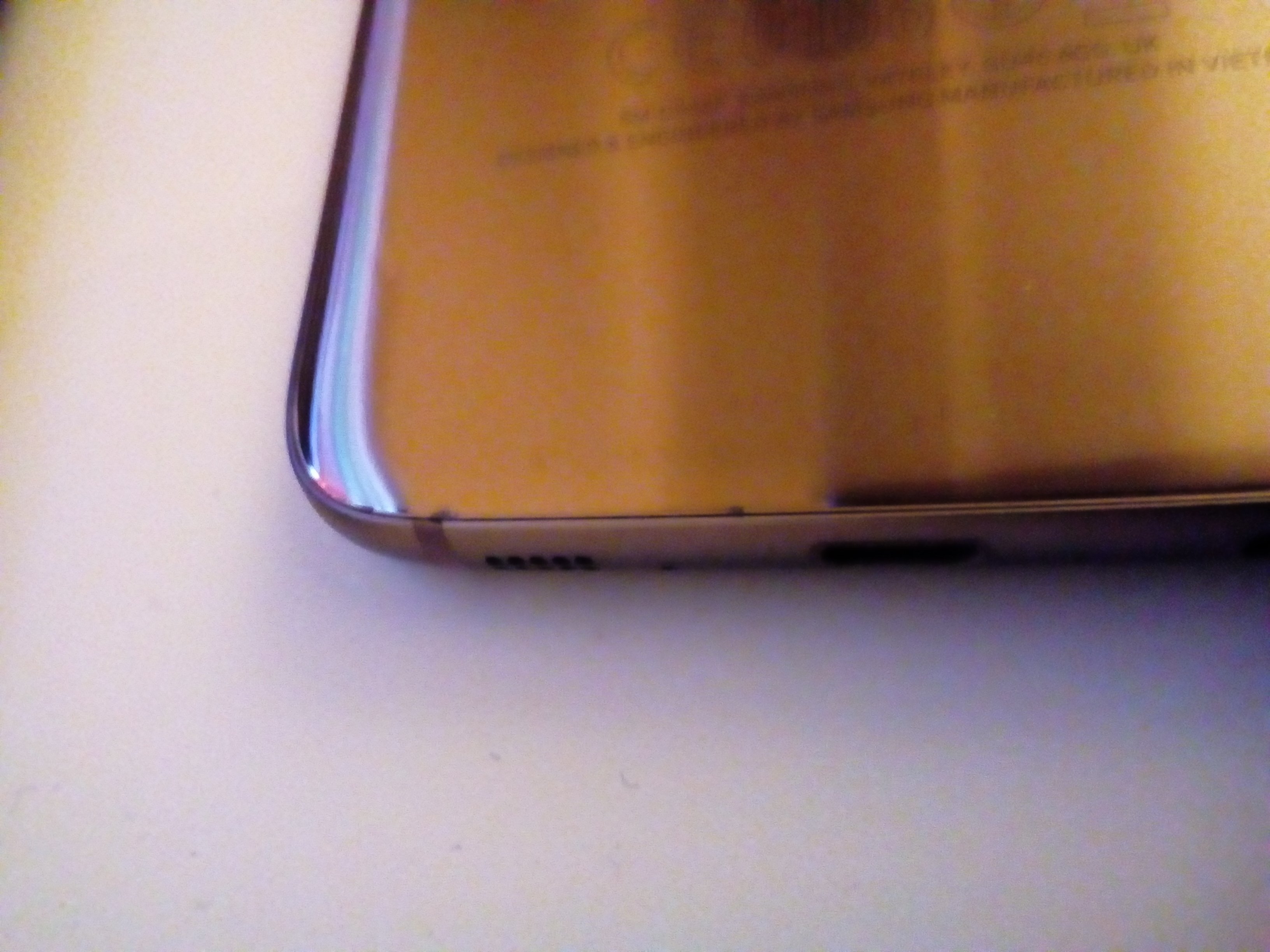

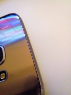

    My friend had a problem, s7 could not be turned on, but he reacted to connecting the charger. Charging appeared on the display. He went to the service "I do not know what the service opens the phone with a needle and damages the phone rame." The service kept him for a good month. Returning to him, he stated that he was dead, brick. After answering tel. I'm already charging. My question is, can you check to prove if the service has changed the mainboard tel? How else can you explain it? Charging was working and after receiving it no longer.

    If they replace the motherboard, it will change IMEI and will not match on the box or housing if it is there. Check the battery voltage
    And the battery really charged? Loading progress?
    Now it will be hard to prove anything. The fact that it does not react to the charger now may be the battery has discharged below 2V and the phone does not detect it.

    The battery has 3.6 v and I have checked it already. The colleague did not specify if there was any progress in loading. He did not pay much attention to it. Well, it will be bad to prove anything.

    The phone is not detected by the PC probably?
    You can still try with an induction charger but it's a 1% chance.

    Of course, it is not detectable by pc. I also tried induction. The charger detects it, because the blue LED lights up on it, but after that nothing, no reaction.

    Put a good photo of the motherboard on both sides. I suspect that they did not replace the main board but they were heating up as soon as they counted up ...
