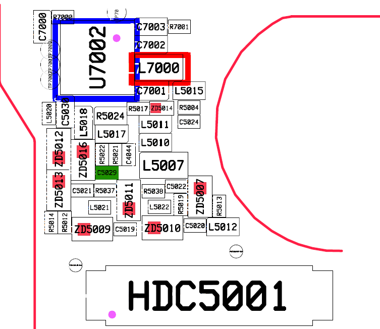

    I had a damaged SIM card slot in the Galaxy A5. I managed to get it and now everything works, the SIM card sees etc. but charging does not work and does not connect to the computer. USB socket clean. I noticed that one element is damaged by the SIM card slot. Can it be the reason that it doesn't load ?? Everything else works without a problem. I marked this element on the second picture with a red circle ...
    Thank you in advance for your help...

    Hello. Clearly you can see that this SMD Chip is damaged. It may be doing some short circuit.

    Without exaggeration, probably just replace the SIM slot and the system, which probably has been mechanically damaged.
    Take measurements on the L7000 and C7002 as the coil has no voltage probably a problem with the USB board, as it is on the coil, and there is no U7002 on the capacitor to replace - that is, the circuit that is chipped in your case.

    I took measurements and on the L7000 I have 4.9V and on the C7002 unfortunately 0V. So U7002 for replacement ... Unfortunately, I can't do it without the right equipment ....

    What should the voltage be on C7002 ??

    How well I remember 5V, but now I will not check.

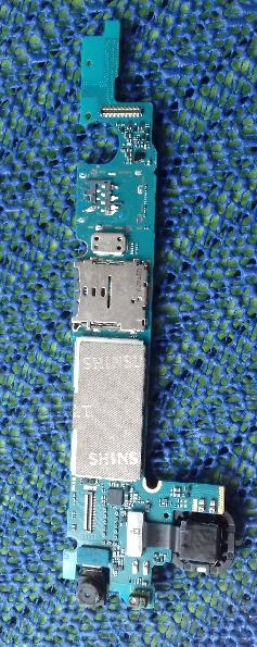

    I made a bridge between the coil and the capacitor. When the phone is switched off, after connecting the charger a large battery icon will appear and after a while it will go out, in a moment it will show up again and go off. Over and over again. With zero response turned on, that is, it did nothing. Replacement plate ....

    Welcome back...
    I was able to arrange the motherboard and everything is ok but if the display goes out and then I press the on button on the side then the display will only show a green line at the top, the second time I will press the button on the side then it will turn off again and the third time I will press it the display is working normally ... And so every time ... Unfortunately I'm not sure if it was the same on the old motherboard, it has already gone to the trash ... Could it be the fault of the display ??
